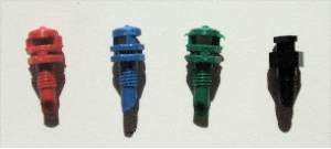

Many yea5s ago I installed irrigation. I used these in delicate areas. just drill a small hole in the pvc and screw them in.
