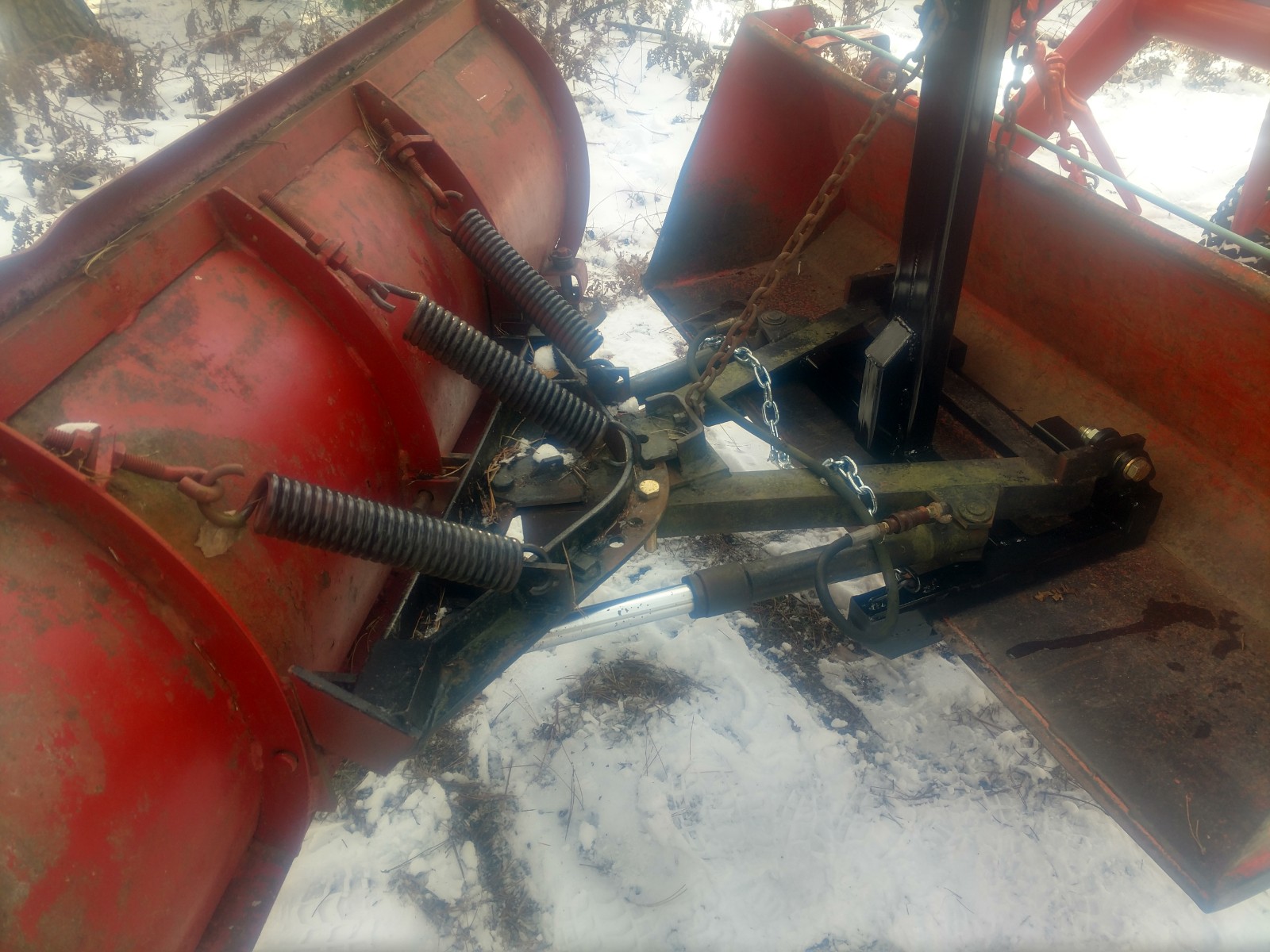

Howdy:
1985 Kubota L2250 with FEL
I finally built an adapter frame for 7.5 ft Western Plow to FEL bucket.
Working well so far on the snowplowing front, but lowering the plow to the ground is fast and touchy. While the FEL control has the ability to lower a load with finesse when you're not moving, it's difficult to do when moving over bumpy terrain.... Need the bucket to remain at a fixed angle for the plow to work properly, so bucket lift = plow lift. The bucket needs to remain off the ground the right amount so the plow floats with the terrain but doesn't put any downforce on the plow.
Would adding a flow control at the cylinder be the best way to slow this? Any unforseen complications from doing this?
Thanks,
CM

Couple Pics, both on and off the tractor.
Others that have adapted truck plows have used a similar setup, using the plow's chain to lift it off the ground. Necessary? maybe not, but using the chain I don't have the hydro cylinder pins in contact with the frame....
The chain binder is how I attach to bucket. Wrap loop of chain around and pull tight.
CM
