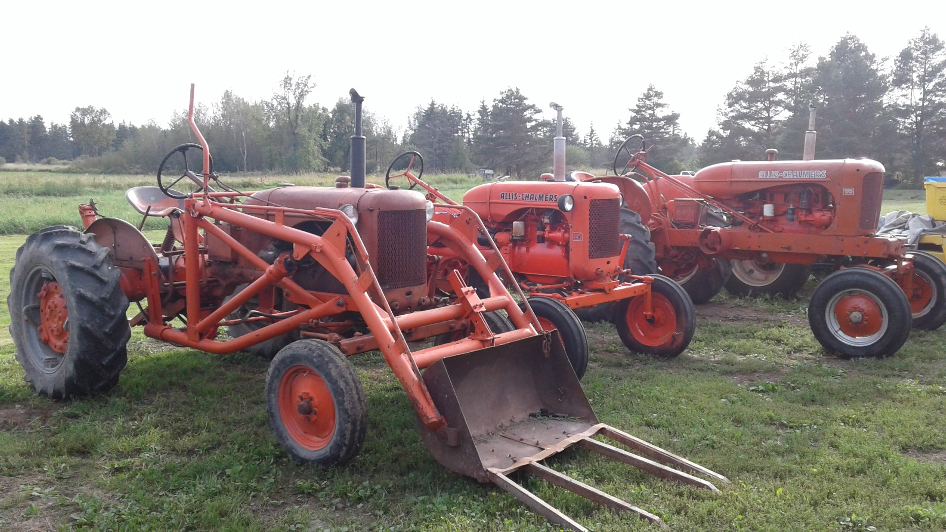

Here's a couple CA's (mine in the middle) with a WD45. Awesome, strong tractors.
