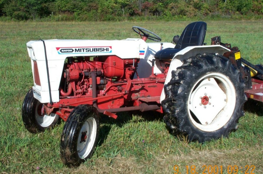

Tony,
I stopped there last month for my Satoh, but no listing {the battery holder is smaller than usual}... so I got the biggest CCA for the money and strapped it in with bungee's...
Now the girl starts as soon as I touch the key... don't even need to turn it... /w3tcompact/icons/tongue.gif

<font color=blue>...Well it definitely likes the green machine...</font color=blue>
The White machine... /w3tcompact/icons/wink.gif
