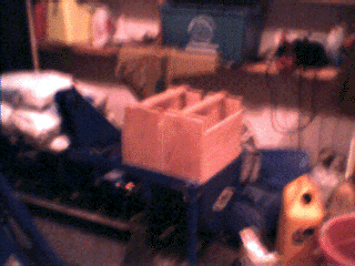

Well After having one bag of pool mix aggregate fall off the aerator & get run over, I decided I should build some boxes to contain the weight. Unfortunately the pool aggregate doesn't have any cement in it & so it is really just loose dust for now. I think I may make tops for the boxes or get some cement to seal the top of the pool mix.
Picture 1 attached (sorry about the low quality)
I built the boxes out of scrap plywood. I sized them so that six would fit (three on each side of the aerator). They each hold 1 80lb bag.

Man If I could only get the pic to attach on the first try.

I strapped a plastic 55 gal drum onto the aerator lengthwise. Filling with water gives me about 450 lbs.

   / Weight box for Aerator
Hey guys,
I like the water tank idea too. I went with the boxes because I already had the pool aggregate sitting in the garage waiting for a better life. Although more strenuos, I suspect the weight boxes will allow quicker set up time.
   / Weight box for Aerator #9
You know, those 16" solid concrete blocks are about $1.50 each and weigh 40 lbs. The weight rack is sized for them to fit perfectly. Each is 4" thick. This gives you 520 lbs on an AE20-60. Need less weight, take a couple off. Need to transport the unit, take them all off, move it, put them back on. Very flexible, very cheap, never freezes when you forget to drain it. But to each his own.
<font color=blue>The weight rack is sized for them to fit perfectly</font color=blue>
Thats waaaaay to easy/w3tcompact/icons/tongue.gif. Costs less than the scap wood I used too/w3tcompact/icons/frown.gif. Well If my boxes wear out, I know what to do.
