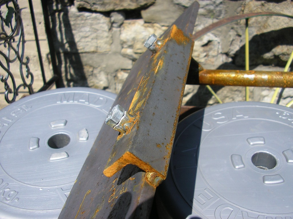

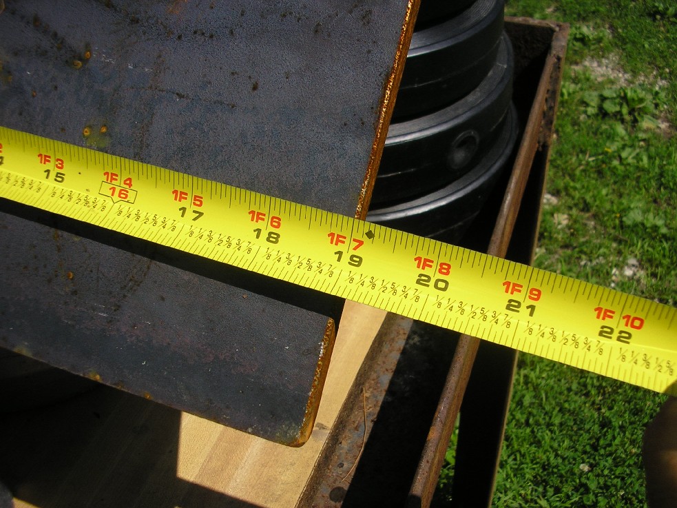

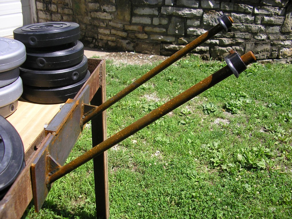

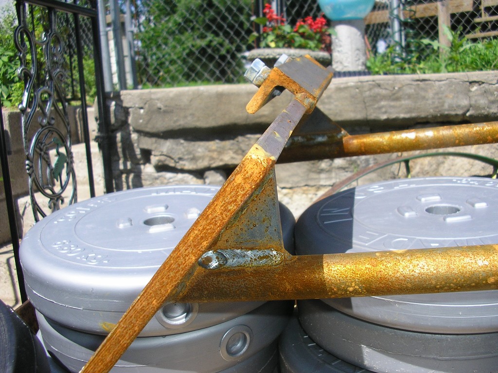

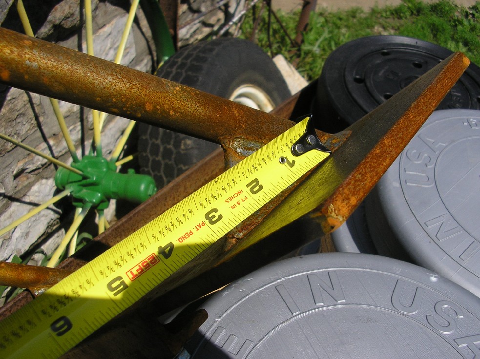

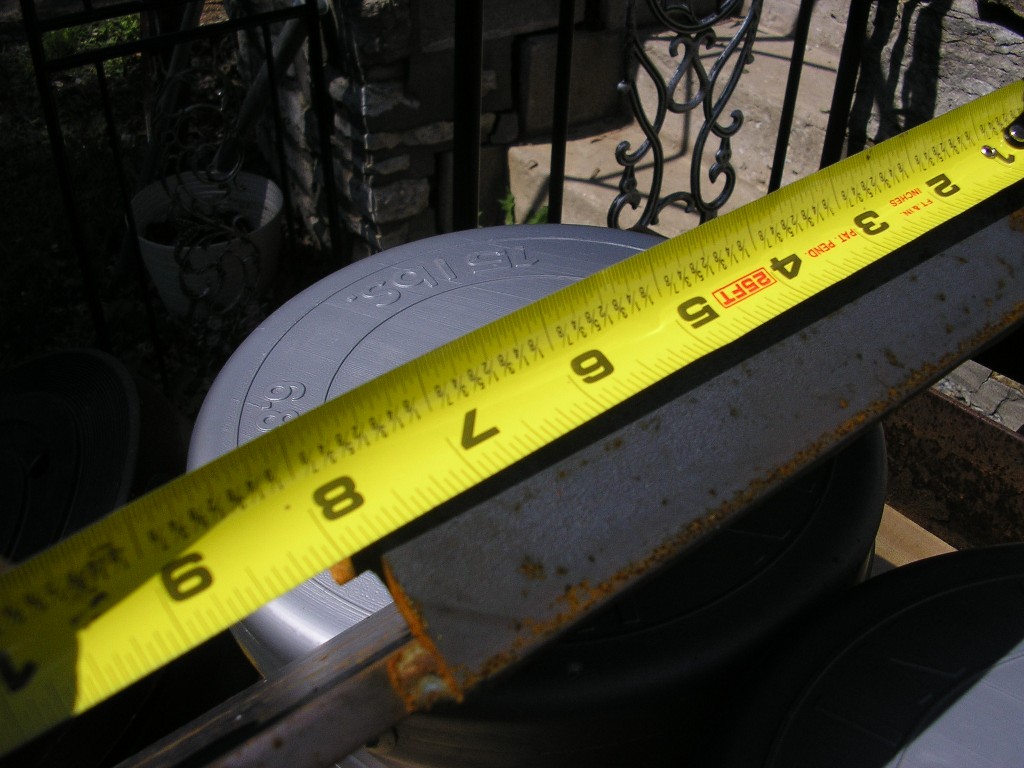

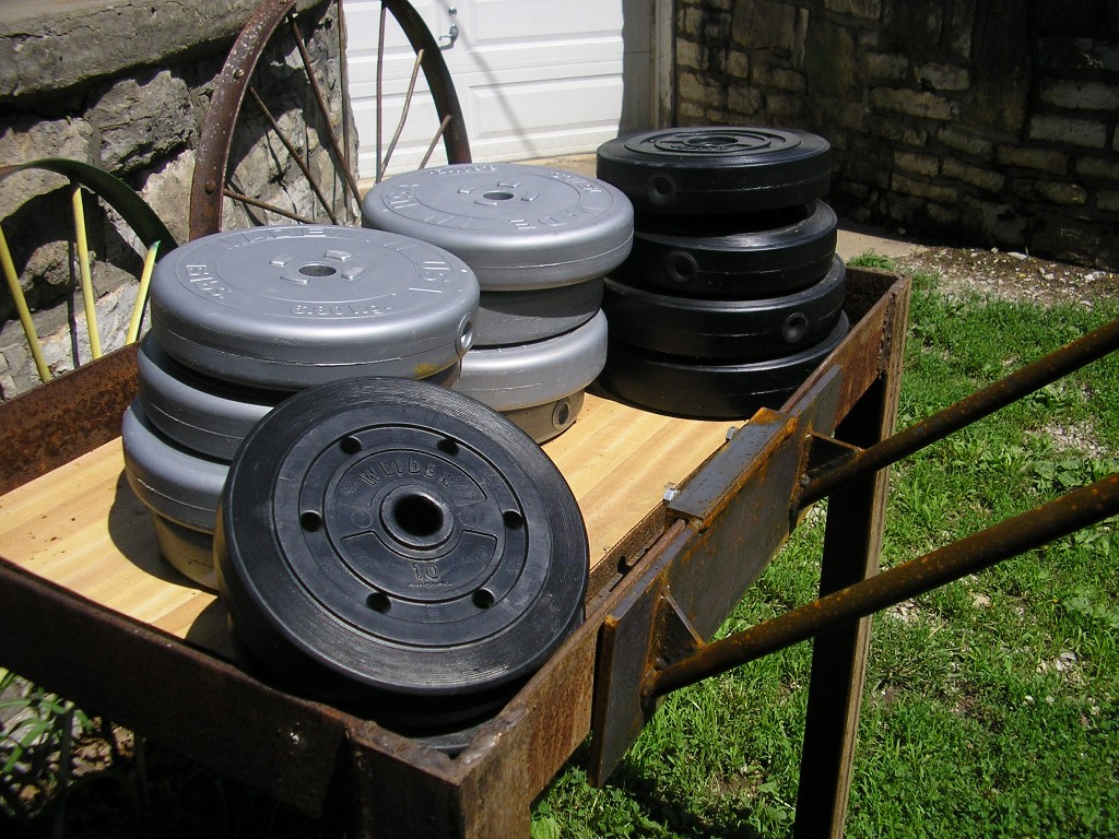

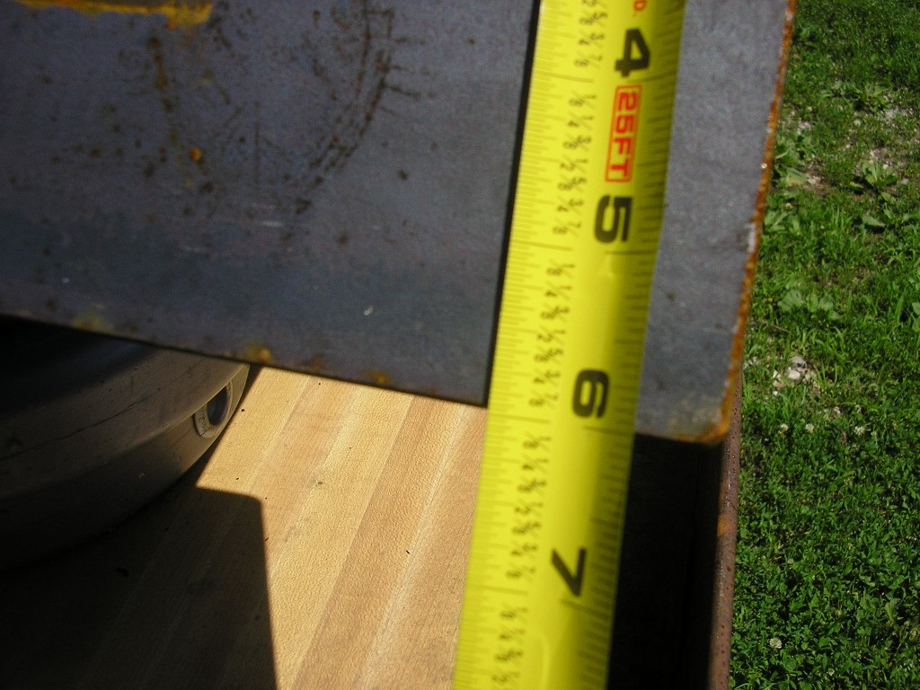

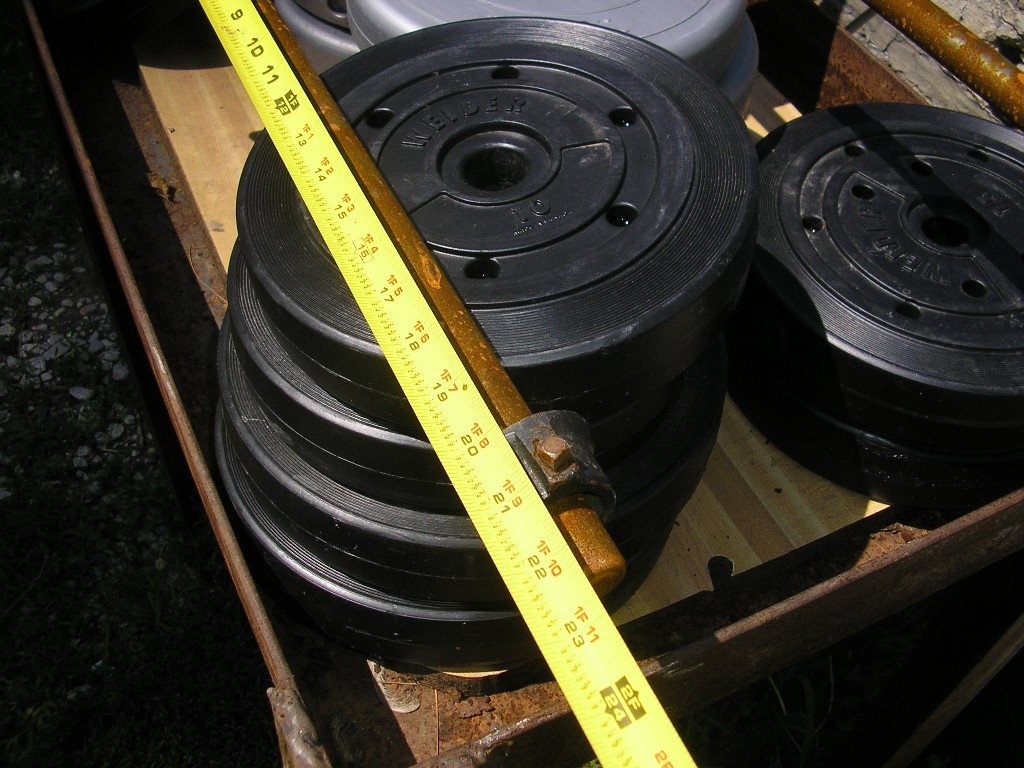

I didn't want to spend $250.00 for weights and a bracket for my tractor so I went to garage sales and bought a set of weights and made my own bracket. I have a total of $27.00 invested in this. Its easy to put on and take off to service my tractor. I am sending pictures in two groups.

With the plastic coated weights, be careful that you keep them away from any heat source, like a forward exhaust. I tried mounting some wheel weights on the front frame of my Legacy. The mount was fine, but then I noticed a big glob of plastic hanging down from the exhaust blowing against one weight.
