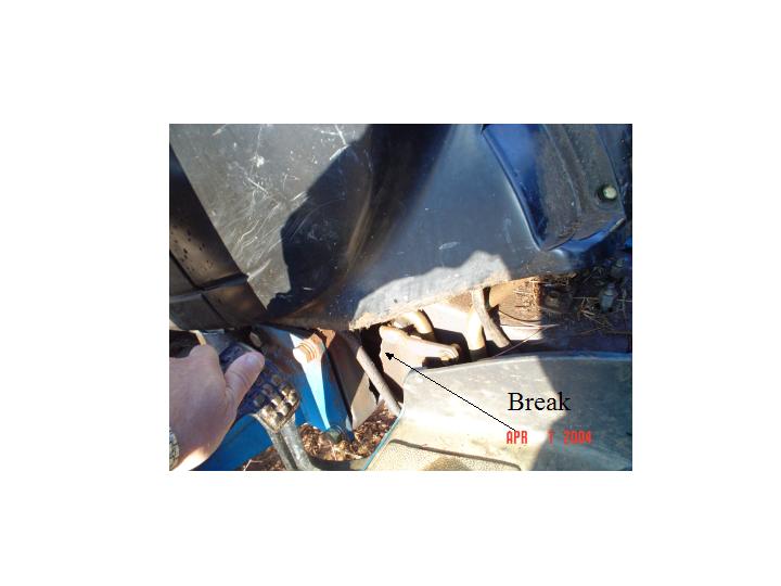

   / weight capacity of 7308 FEL rear mounting brackets #6
I would be carefull putting weight on that support. It appears all the weight from the loader is applied at the clutch housing. My TC33D broke in half at the clutch housing. See attached picture.
