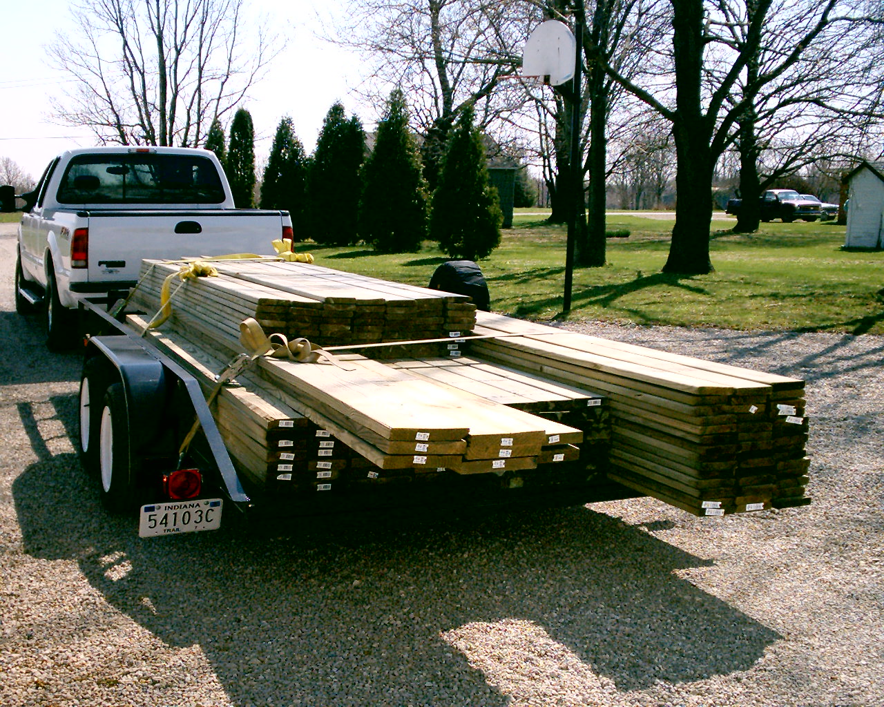

My 18' trailer weighs 1250#. I had it weighed so I know its right. Best thing to do is weigh your tow vehicle then go home and get the trailer and weigh it on the same scale. Then just do the math. I have a scale 1.5 miles from my house so I weigh everything.
Chris
