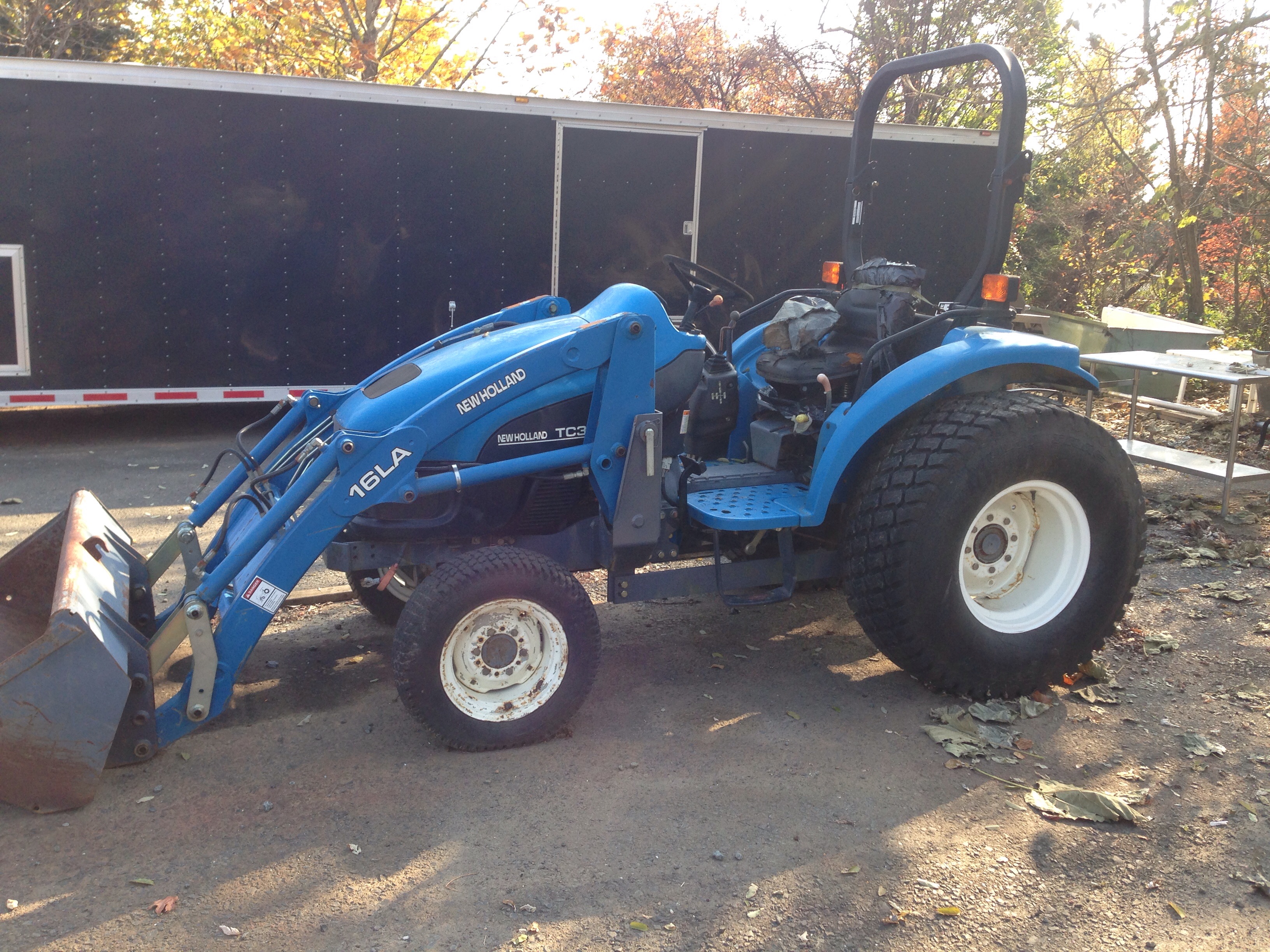

   / Weight of tractor #3
Tc35 or TC35a
2wd or 4wd
Tires loaded or not?
Tc35 is lighter. figure the loader with bucket in the 1000# range.
So a 2wd TC35 with empty tires and loader.......~4000#
A TC35a, 4wd, and loaded tires.....~5000#.
So somewhere between 4000-5000# based on the limited info
