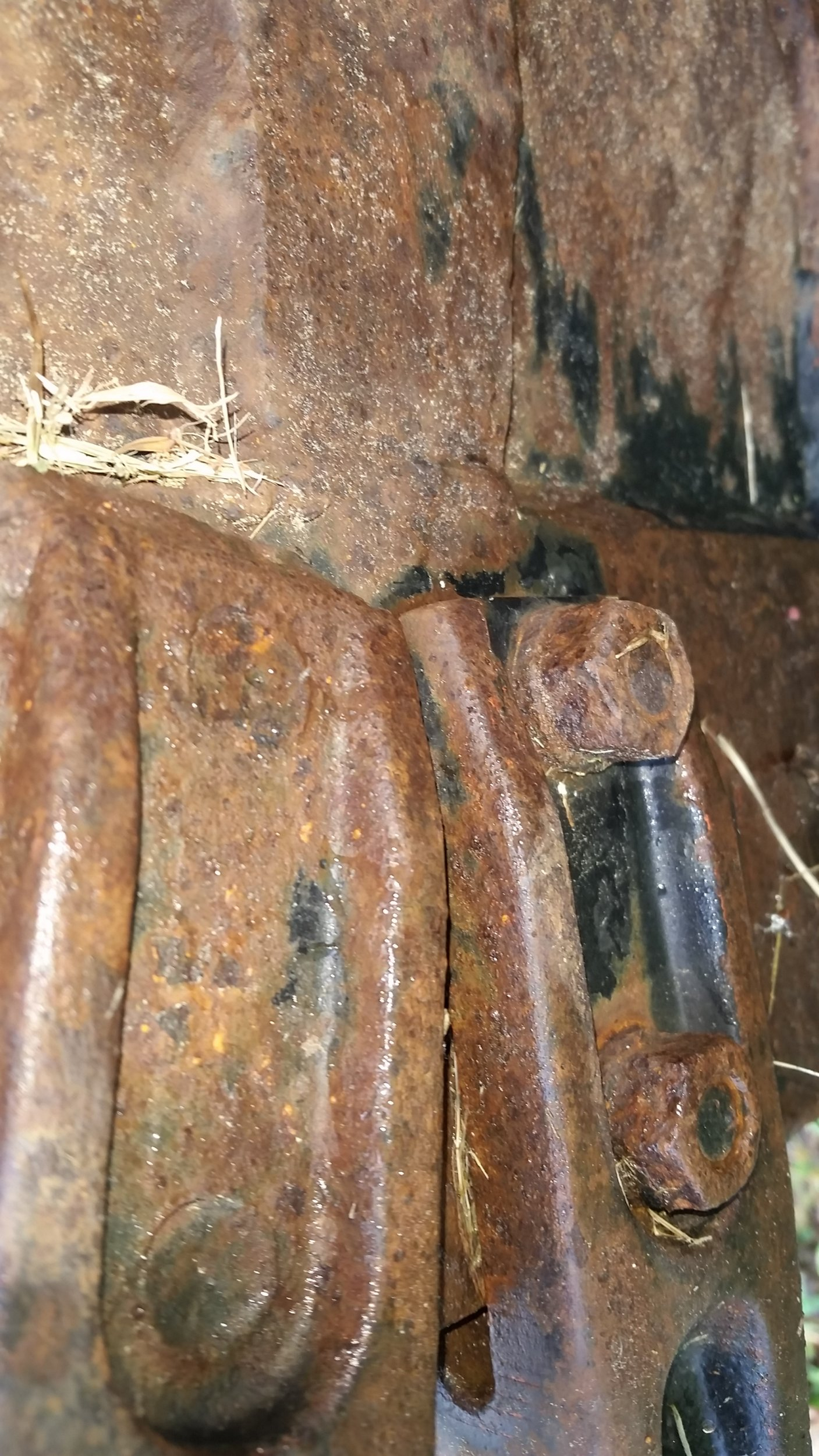

Got a spare bucket, a Kubota BT1953A. I was thinking using it as a smooth bucket, no teeth for occasional use.
But, the two outer teeth are welded on, the rest are bolt on. Not that experienced but I've only every seen all bolted or all welded.
It also appears the bot holes may have been welded up, or, the bolt heads and nuts broken off in some prior life and that is why they are welded. In any case, the "holes" where the bolts would go are solid.
I'd like to retain the ability to put the teeth back on, all bolted at some point.
Looking for thoughts on how best to remove whatever is filling the "bolt holes", before grinding out the welds.
Have a cutting torch and plasma cutter but doubt I could manage a reasonably clean job of it.

Without seeing pictures, I'd guess grind the bolt hole filler material flush, then clamp another piece of thick metal that has been predrilled over the hole, and then use that as a guide to redrill the original hole.
These transfer punches are also helpful to have. Transfer Punch Set, 28 Pc. The problem is in punching the exact center unless there's enough outline of the original hole that you can use it to mark the center. So that's why I suggested using another piece of metal as a drill guide.

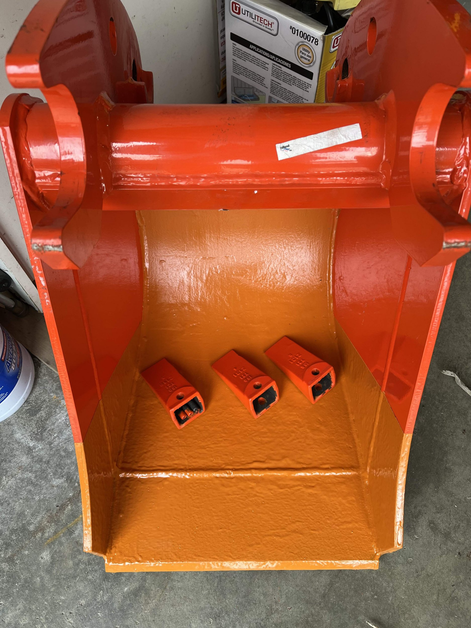

I can't help you with getting the teeth off but I, like you, wanted a flat faced bucket. None to be had, so ordered a toothed bucket and had fab shop cut off the sub-tooth? after removing the teeth. Advantage was it was a new bucket so easy to see everything.

Looks like there's enough outline of the hole that you could just about mark the center with a transfer punch and then drill it out with a series of drill bits.
   / Welded on bucket tooth. Kubota bucket
I can see the outlines pretty clearly. Some look like clean broken bolts others look maybe tack welded in the hole.
Gonna soak everything in Kroil for a couple days, then try and get the bolted ones free.
Maybe use a free tooth as a drill guide in some way.
