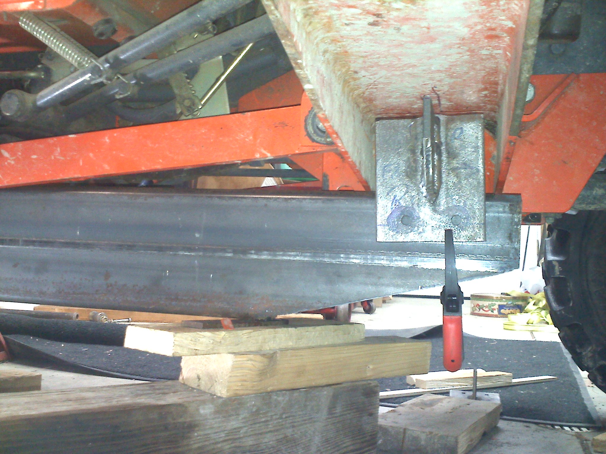

Got a B7510 that I'm building a subframe for a hoe... http://www.tractorbynet.com/forums/build-yourself/231232-backhoe-subframe-b-7510-bota.html
was all set to weld on this 20130106170842.jpgbracket to the bottom of the loader framework. Then...I started to question my weld decision...will it warp the loader connection points? will it weaken the strength of the loader mount? other not seen issues?
so, should I weld a plate to this bracket 20121230180922.jpg , then bolt thru the top plate conneting the two? the welding would be EZ'er and much less work...but IDK if it's OK to do. would this be better to post in the welding section?
Comments?????:confused:

Fred, the subframe would be attached the the hoe, and it would slide into the rear mounting area via two 1 inch pins, then the front be lifted via hydraulics, in my case bolted two 5/8 bolts on each side to mounbt the front. My question is welding the bolt on attachment plate to the loader arms...sorry that I was not clear on this.
I see what you are doing, and I am familiar with that type of Kubota FEL subframe.
Welding to the FEL subframe will not hurt it, nor will it seriously distort it. The
U-shaped steel is thick and inherently resists bending.
That said, the issues I see are: are you going to remove the subframe and weld
from above, or weld upside-down? I don't do OP welds like that on any of
my subframes, esp with a stick welder. You may be more comfortable with that
than I am. I WOULD tack-weld from below, however. Your call.
I like to protect the steel around welds after the paint is ground away and/or
burnt off. Can you access both sides of the FEL subframe to repaint if it is welded
in-place?
You can just weld a bracket with bolt holes onto only the vertical parts of the U-shape,
but I see you have already made your brackets.
Looks like a good project. (I love backhoe subframes.)

Yep...tack in place, and overhead weld...not fun, but my welding instructor, knew I did not like it so he made me do allot of it...took alot of practice...and I did get the hange of it with 6010 rod...I don't like 6010 rod! However, I will be welding with MIG ; )

yep...I can access for painting

could not do a U shaped or a brkt that will pit up both edges of the suframe...no flat surface 2 inches to the center of the tractor.

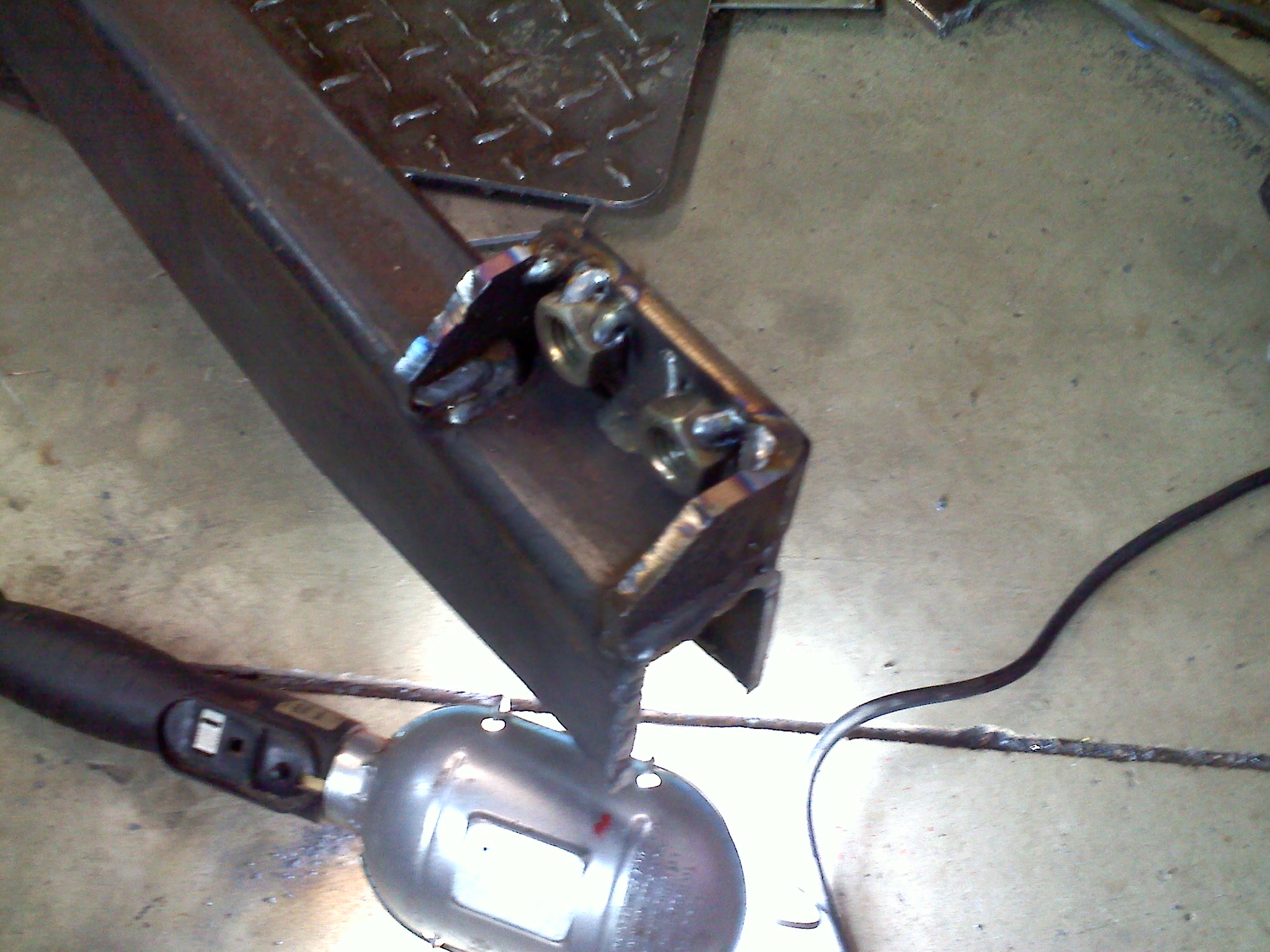

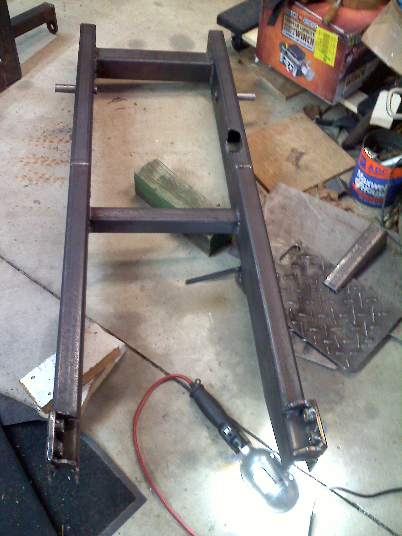

well this subframe is made from 2 x 5 x 3/16 thk tubing, got two crossmemebers a 3 x 3 x 3/16 in rear (attachment of the hoe plus the two main 2x5 stringers) and 2 x 2 x 1/8 in the mid point. think this should be good for my little 1800 pound of ripping force hoe?
Sounds like you have a good plan. Post some pix along the way....lots of TBN folks like
to see these subframes being built.

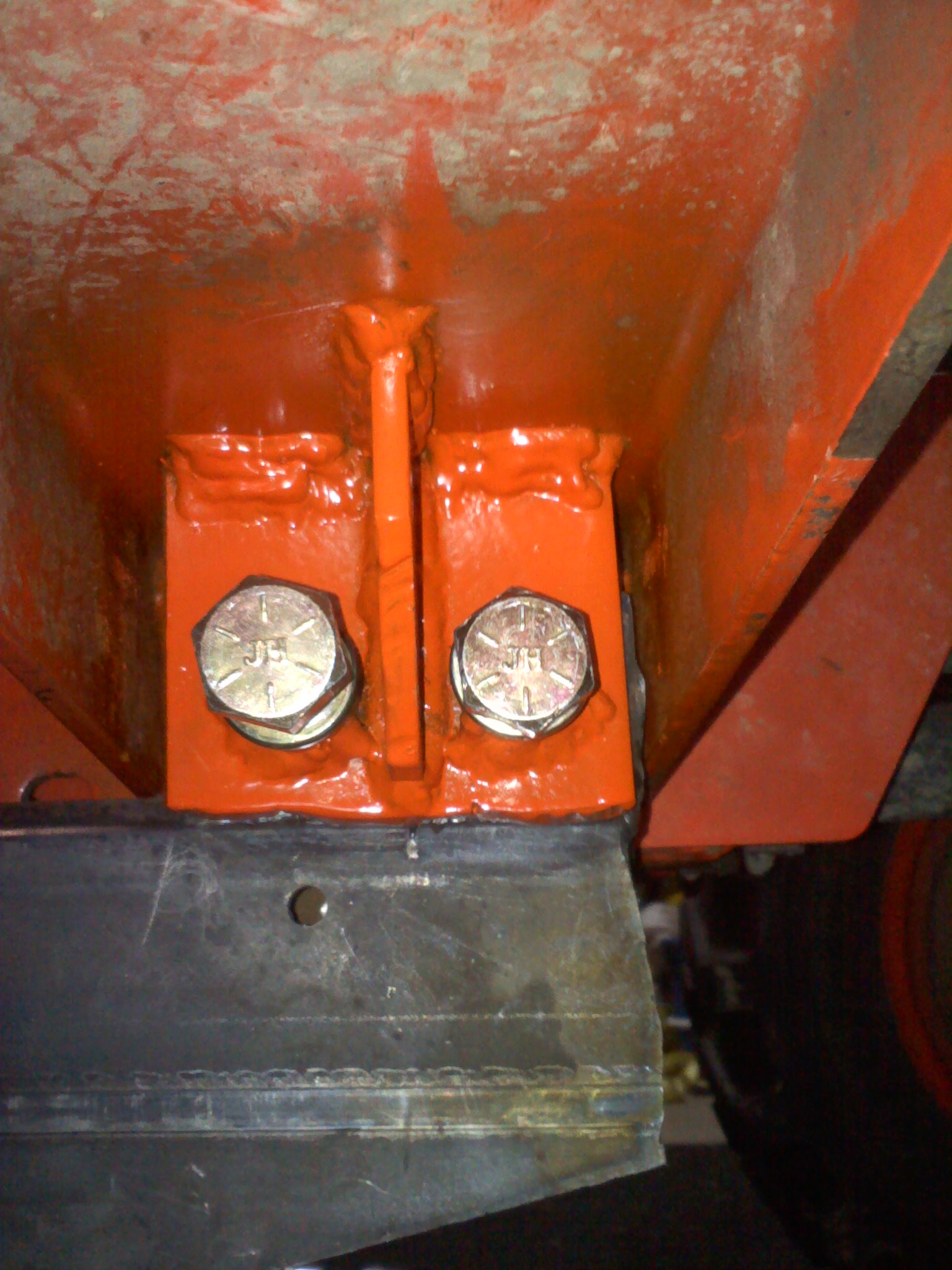

WOW...did I screw up! stupid...stupid...stupid...
after welding up the left side btacket, I'm looking at my work. Then it hits me...this bracket is going to interfer with the mower deck in the up position. :eek: now what??? #%*@*()%

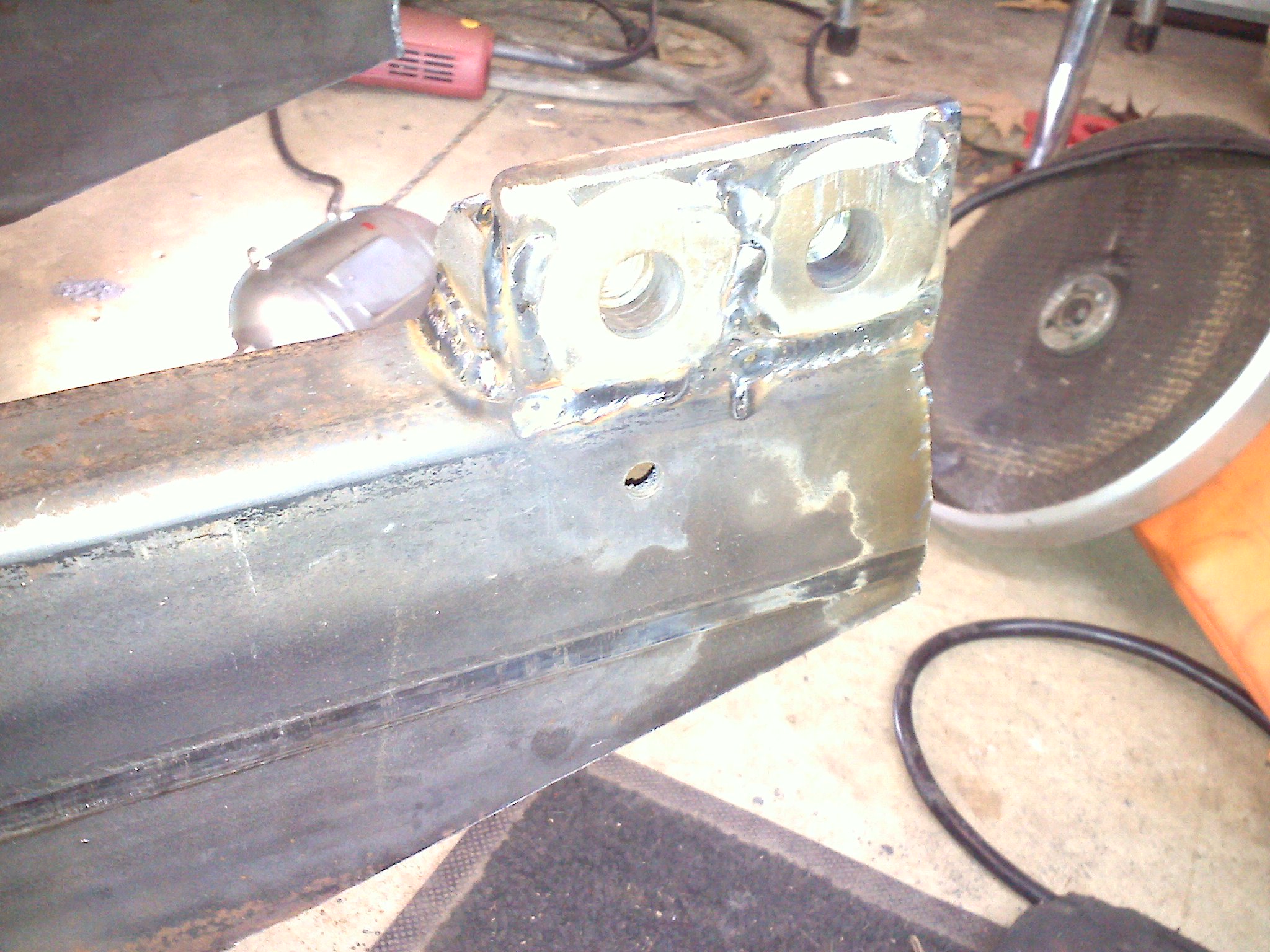

got my interferance issue resolved (between my welded bracket on the loader arm and mower deck in up position). Had to cut off, shorten, the bracket, re-drill 5/8 holes. then add to the top of the sub-frame the attachment points...vs going thru the 2 x 5 tubing as originally planned. all is good :D also I have decided to weld the subframe to the backhoe vs bolting/pinning.
here are a few pictures....the subframe.
new "on top" subframe connection point...back and front sides
20130118152117 front attachment.jpg20130118152228 front attach loader side.jpg
shorter loader brkt... note one bolt just loose
