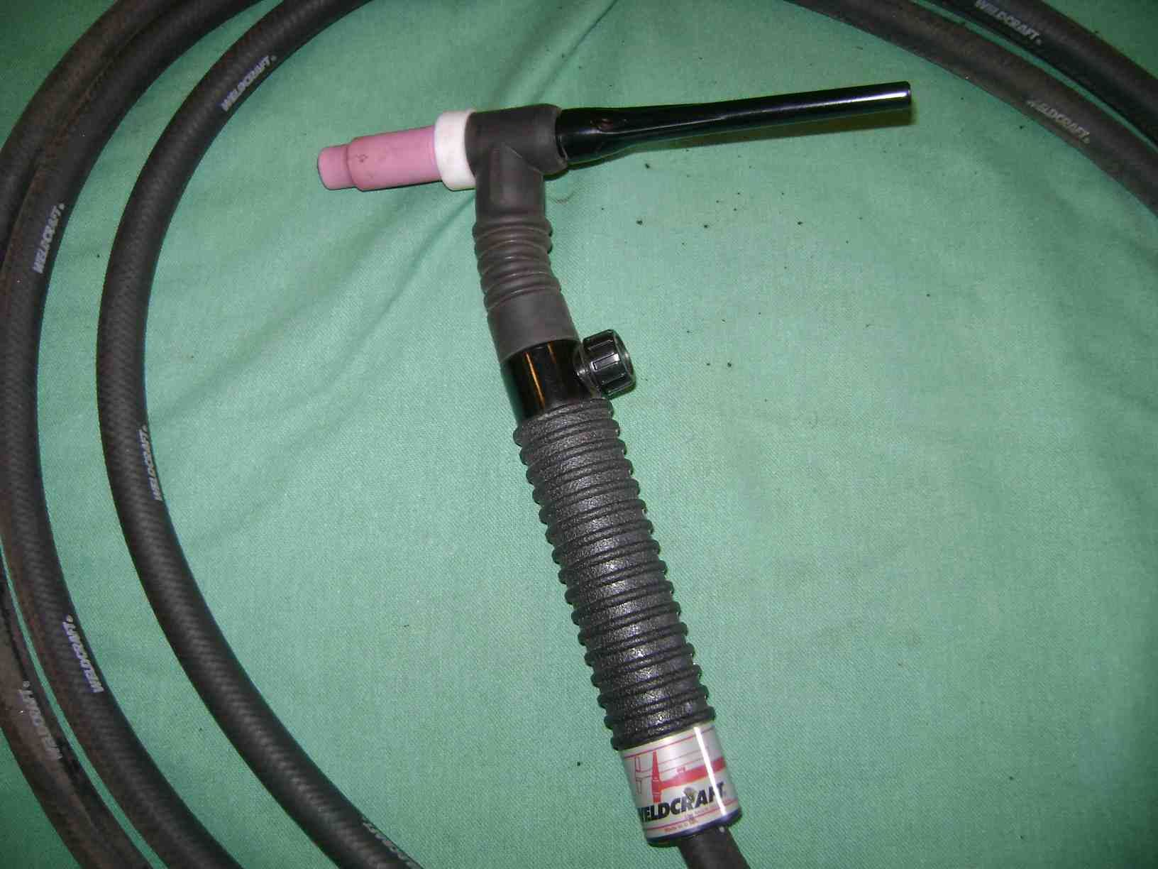

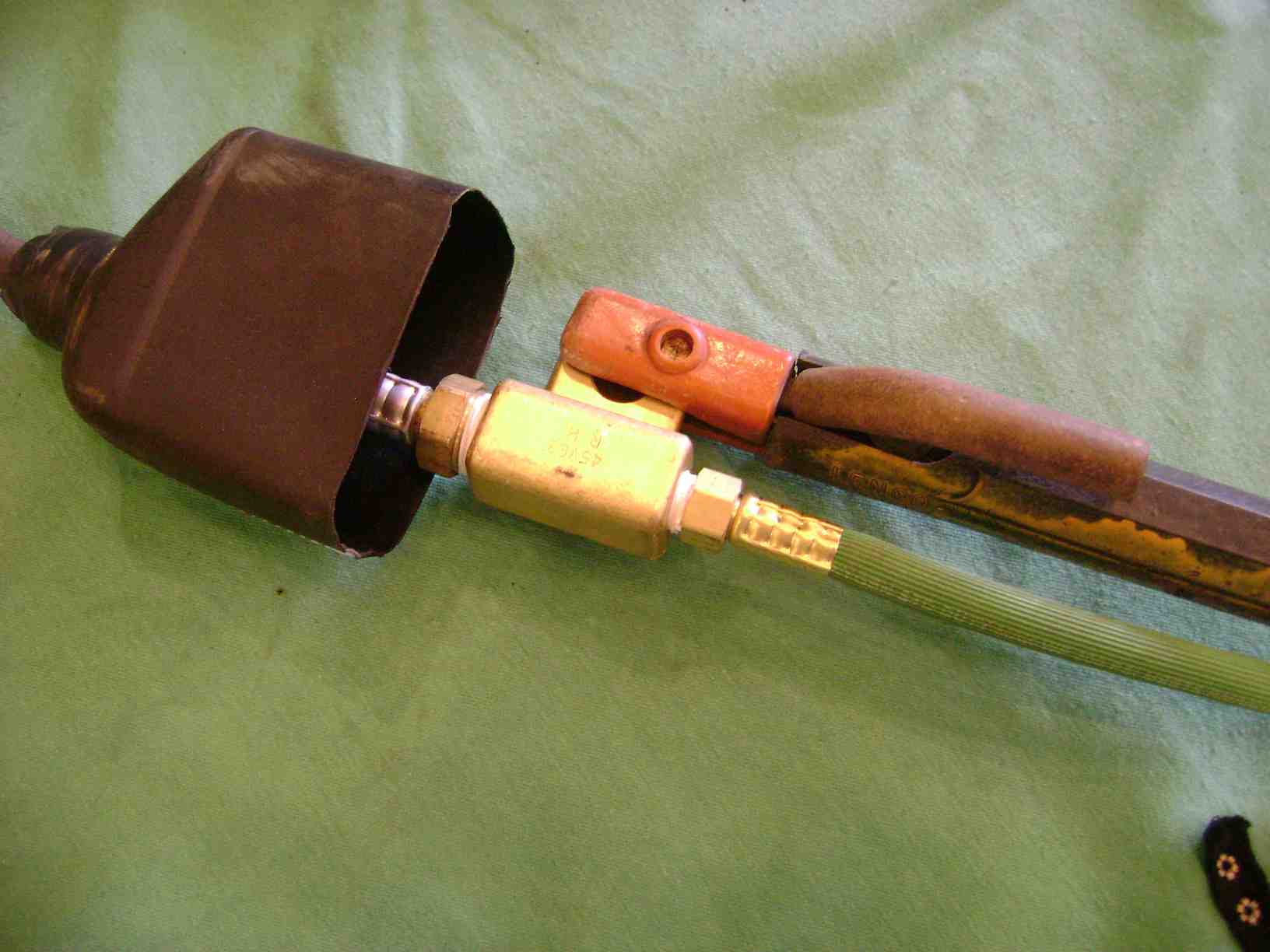

A buddy of mine has a Lincoln 305 G. He uses an old LN-22 wire feeder with it. I know the 305 G has CV, so you could buy an LN-25 wire feeder, gas regulator, bottle of gas, to run Mig. To run aluminum, I see in the accessories section you would need K487-25 spool gun, and K488 control module, and K691-10 input cable. I have the same spool gun and module. Doesn't look like you would be able to Tig weld aluminum with this machine, but you could buy a Tig rig, and Tig weld mild steel and stainless steel.
I've used his machine a little bit, very nice arc!

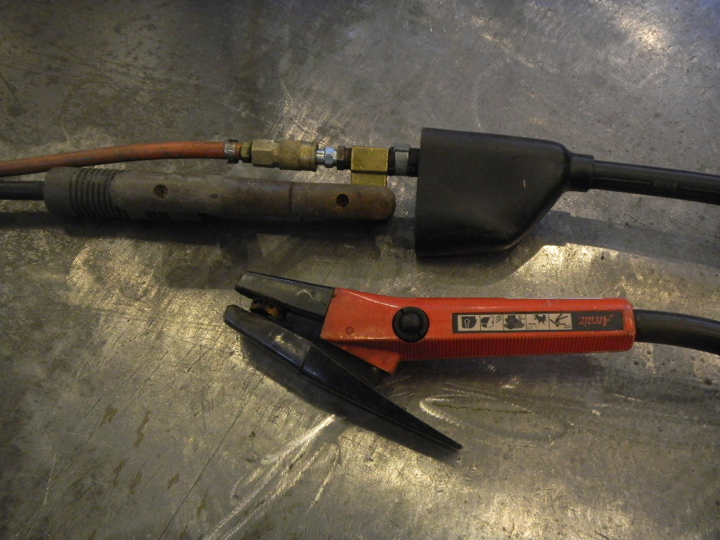

Had a buddy that was a welder mechanic and told him I was looking at a used ranger. He said if it looks good tell them you need to do some arc gouging. If they reply with: " oh yeah it will do it", keep looking! Laugh about it every time I think about it. Rangers have a good arc.
   / Welder/Generator #8

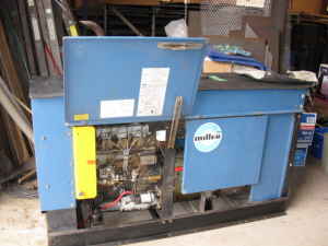

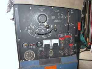

If I remember correctly there was a huge debate on the Miller site 8 or 9 years ago about carbon arcing with engine drives. One of the Miller moderators jumped in and said there was no proof that carbon arcing would damage an engine drive. I know I never had a problem turning the dials all the way up on an engine drive that belonged to the company, but would never do it to one of mine. I have done a little carbon arcing with my Miller Trailblazer 55-D, but very little, and with small rods, used just to take out one or two bad welds. Now a days I use my plasma for scarfing things, but if for some reason I really had to get after it, I'd rent a machine!;)
