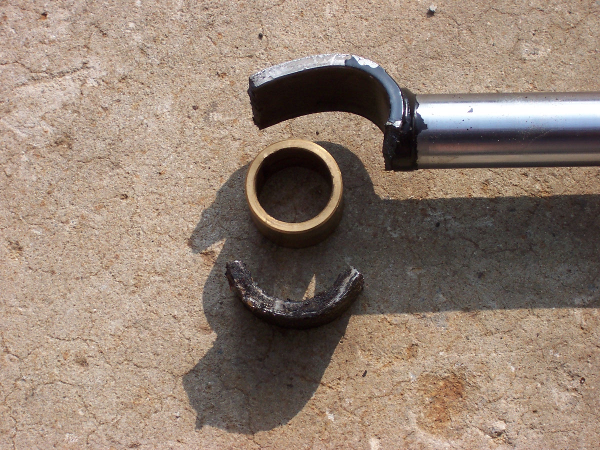

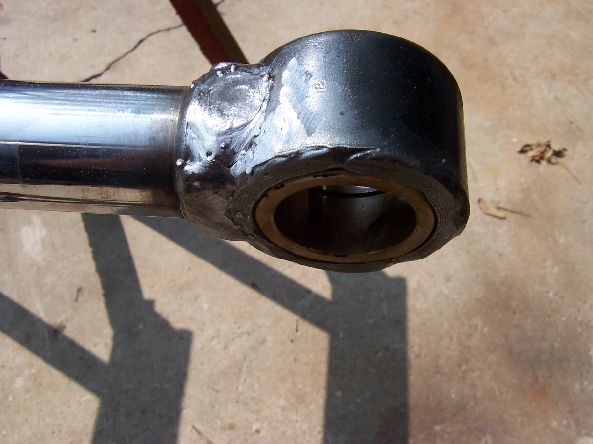

Here is a cylinder end on my Jinma Backhoe that failed.
I made a new ring for the bushing and welded the ring to the rod with 7018 rods. It's not real pretty but I cranked up the amps and burned it in to get good fusion.
It has held for several years now.
Make sure you protect the rod from spatter, it will ruin the cylinder.

   / welding a hydralic cyldiner rod #6
I welded one on a mustang skid steer once. I remember I had to crank it up pretty high to get good pen.
