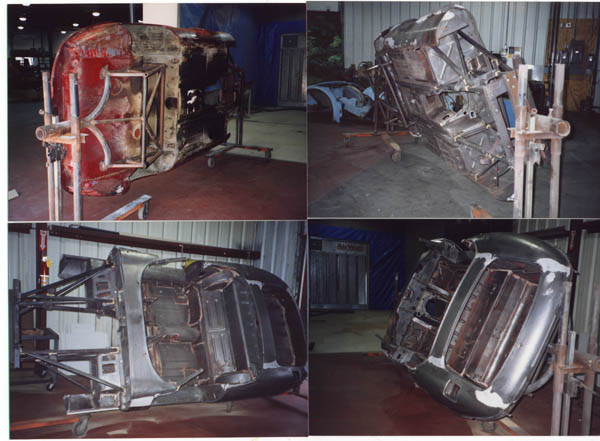

/ Welding: Damage to Electrics? #14
Hehe...it's not that hard. Just do what I do...just flip 'er on her side!Tony, Don't laugh, thats just what we used to do when I had an Auto restoration shop. Here is a photo of a Jag XKE on the rotisserie all cleaned up and ready to be welded back together.
/ Welding: Damage to Electrics? #15
Bring that unit over to my house... but it will have to do end to end, as I want to weld on the rear surface/w3tcompact/icons/smile.gif
/ Welding: Damage to Electrics? #16
LOL...Well Von, you're right. I was just making a joke but it appears to be a reality. Who da thunk it?!
