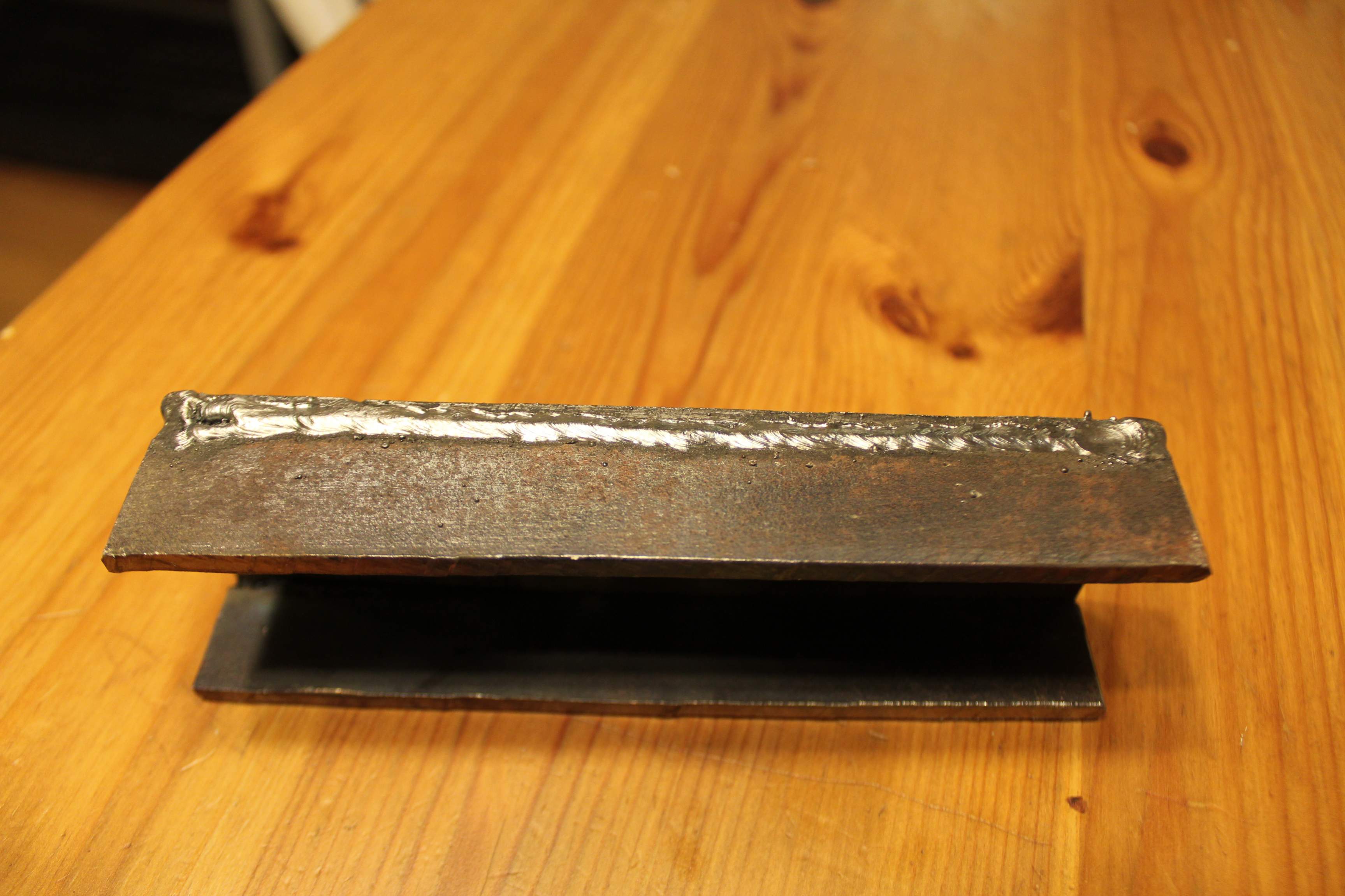

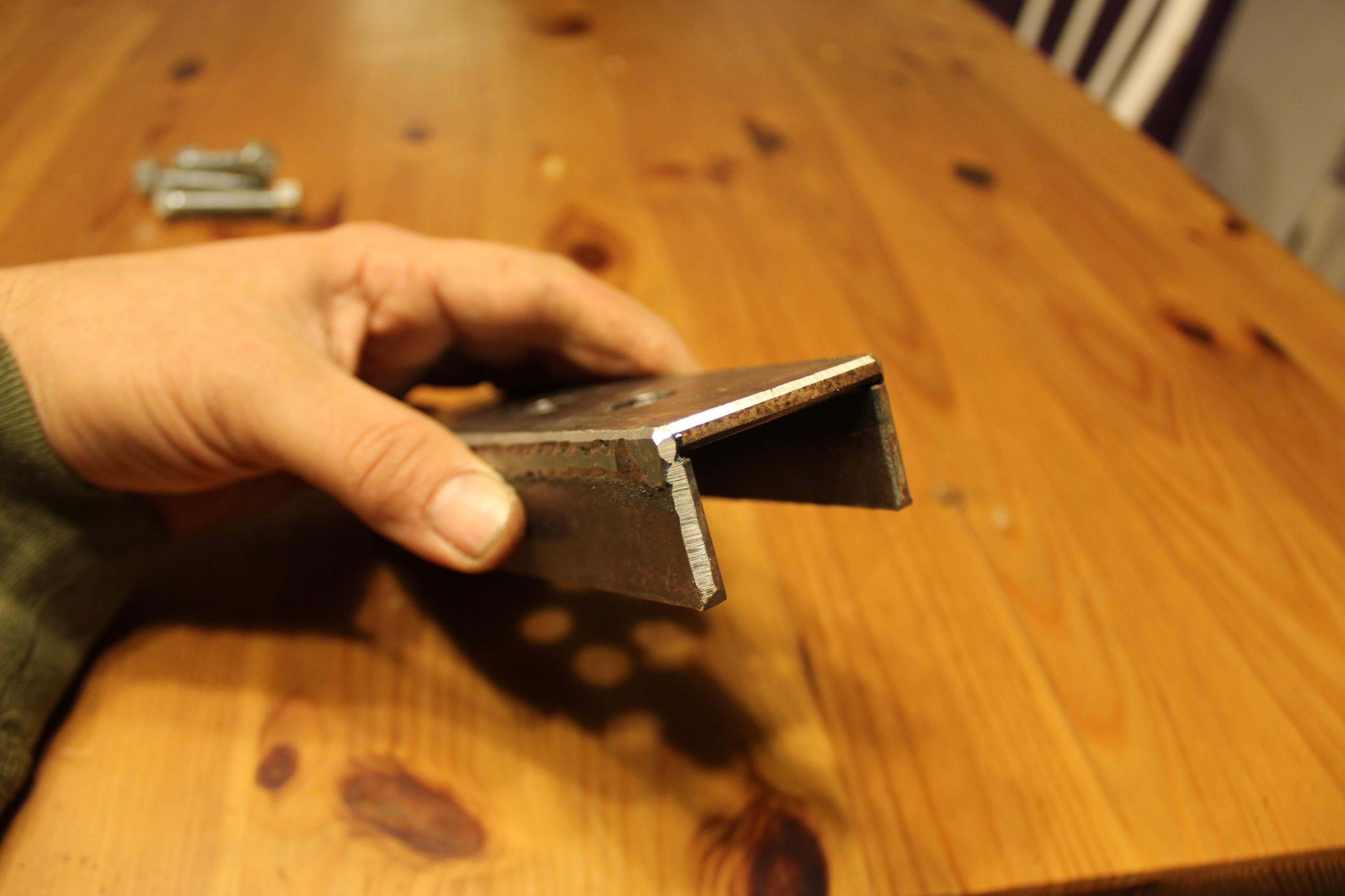

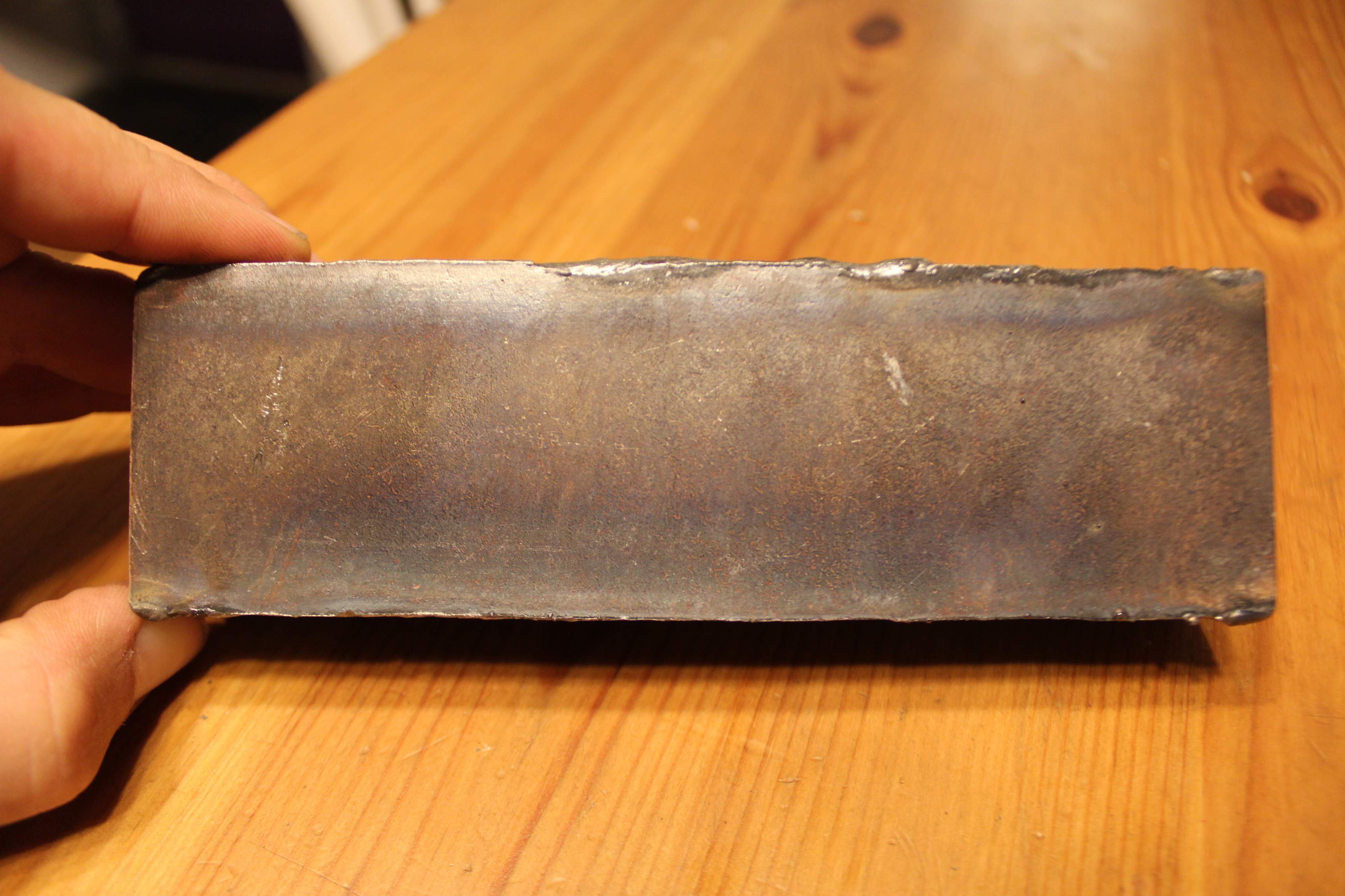

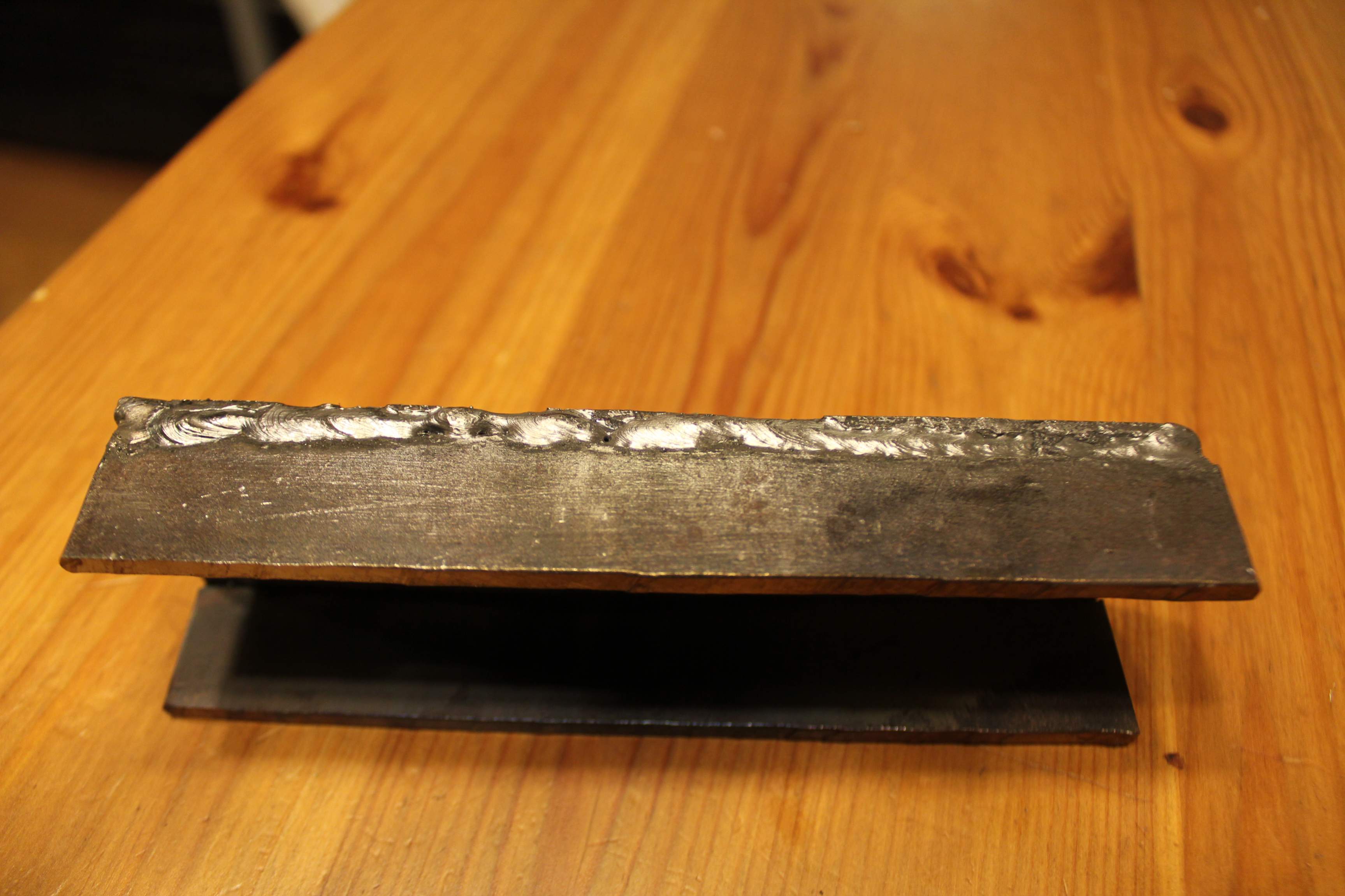

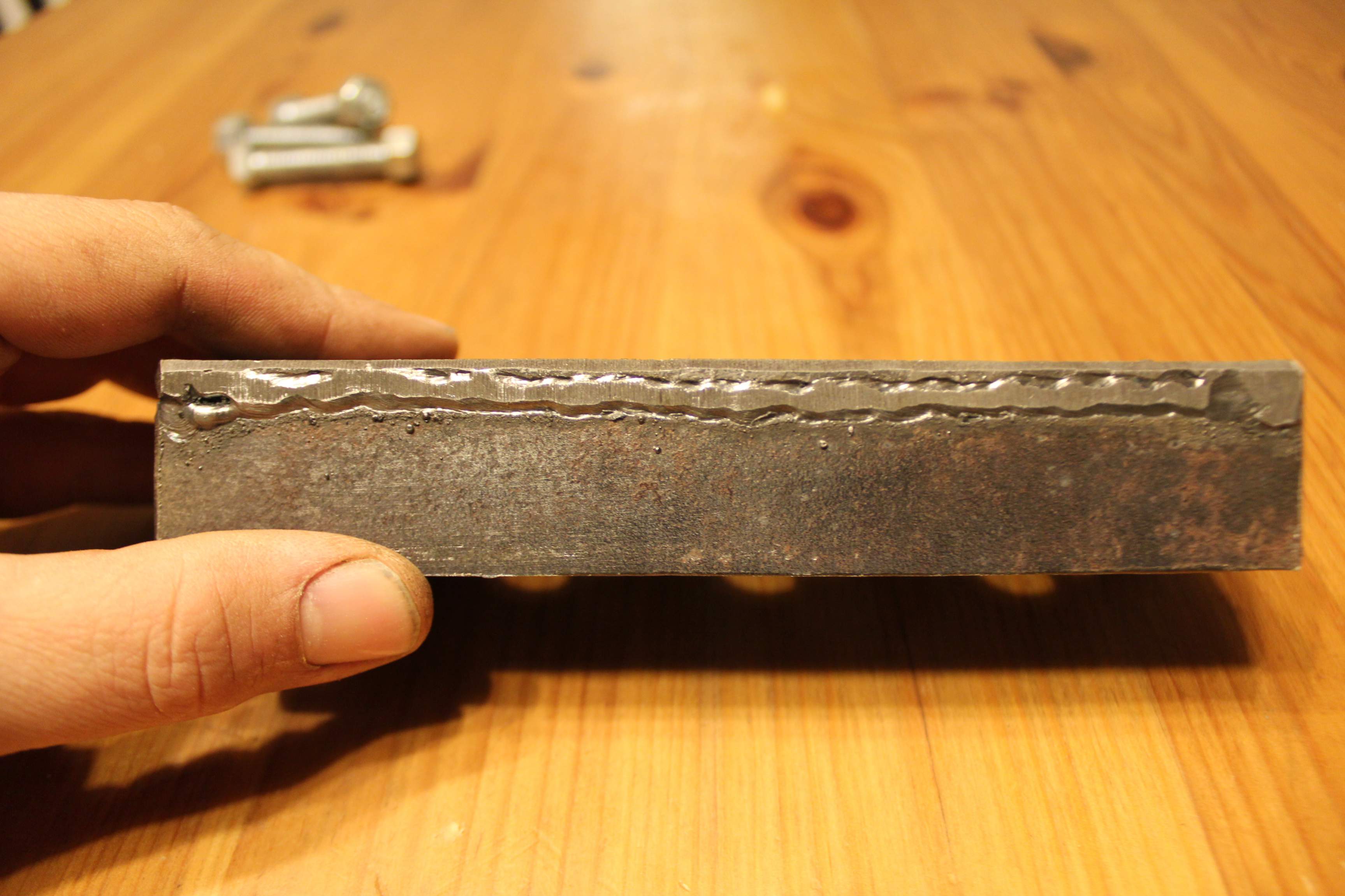

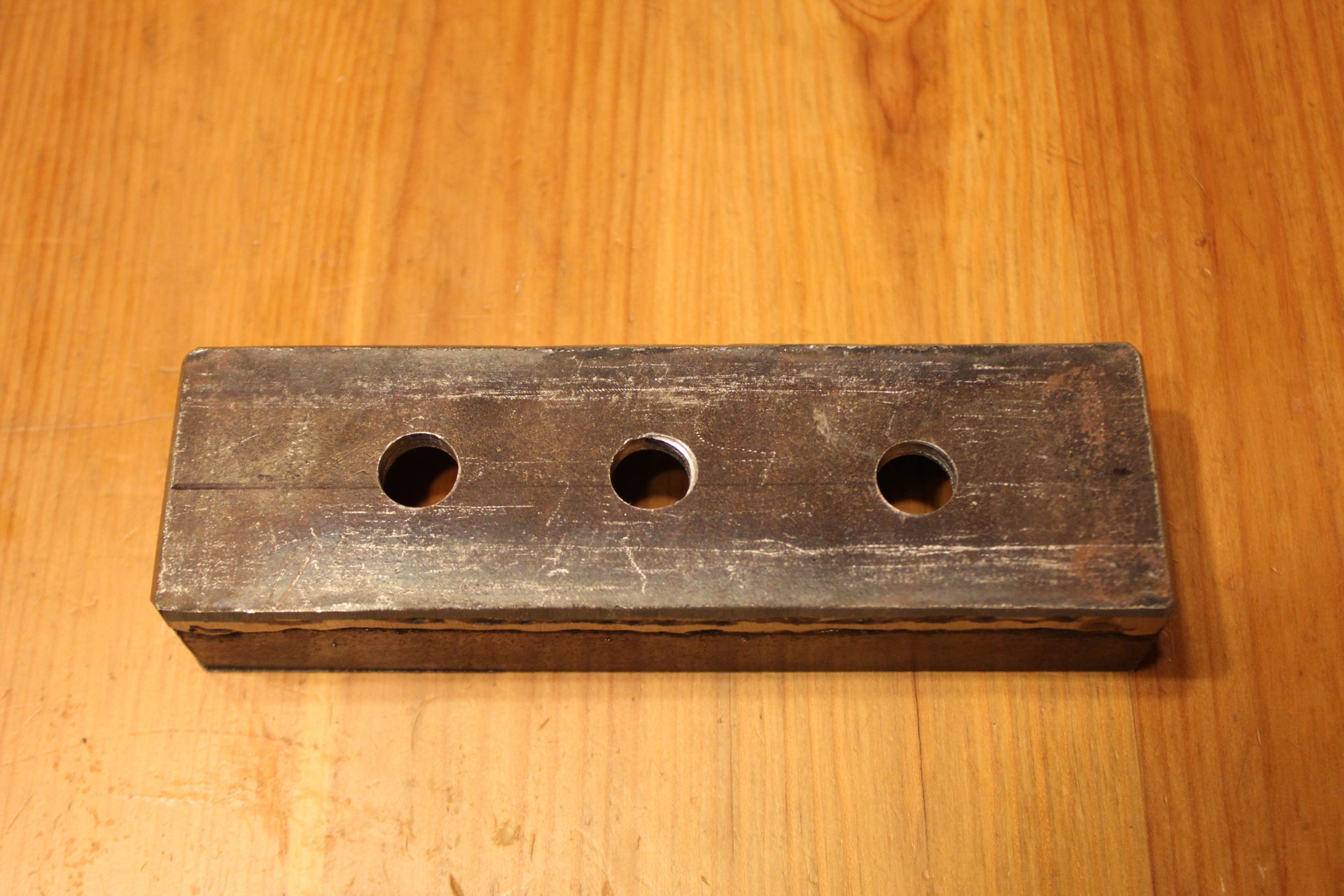

Here are some pics of the project.
One side weld. 3/32" E7014.
Other side weld. The second side is a lot neater, I think because the electrode had burned down shorter. If you look at the first side, you'll see it gets a lot better towards the end of the weld.
Top plate. I beveled the plates with a small landing to help with penetration. You can see where I undercut the landing on the top weld, whereas the bottom weld stayed entirely within the bevel.
"Bad" side -- after grinding flat. Small slag inclusion towards the end of the weld.
"Good side" -- after grinding flat. Some undercutting, but otherwise, I'm pretty happy with this bead.
After welding, I beveled all the edges, both for safety and because I thought it looked nice. Not sure how I should have done this if I wanted it absolutely flat. Maybe no bevel? Or another pass?
Finally, I drilled 1/2" holes.

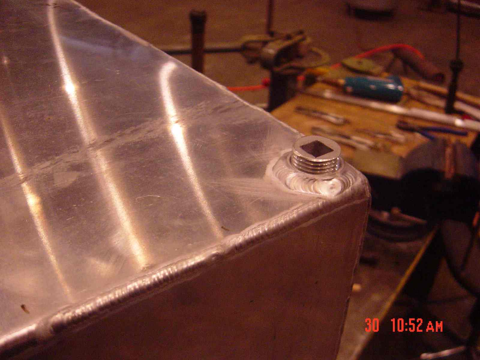

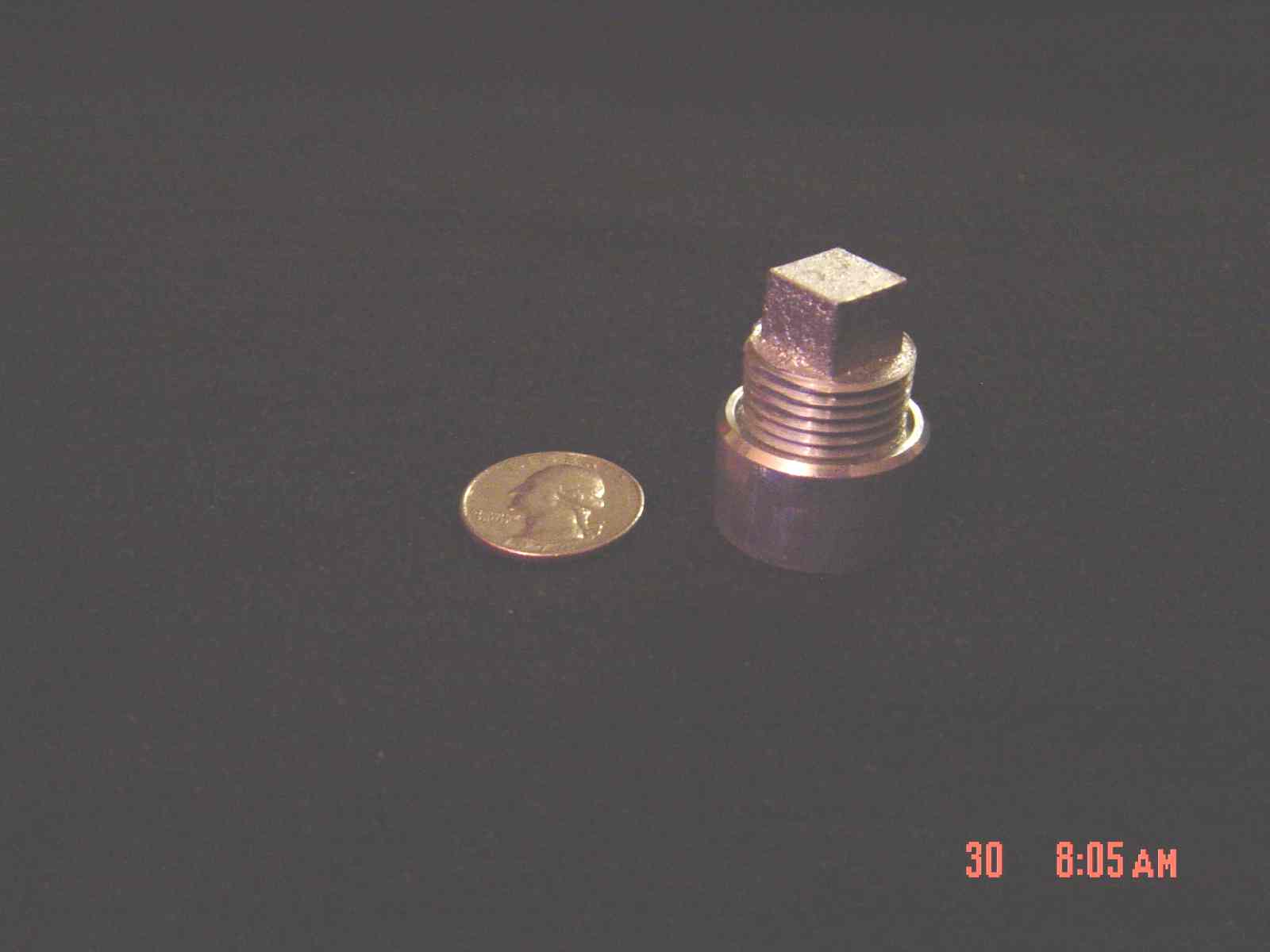

If you think welding a steel nut on is tough, try welding an aluminum one.:D
Not necessarily a nut, but pipe insert.
