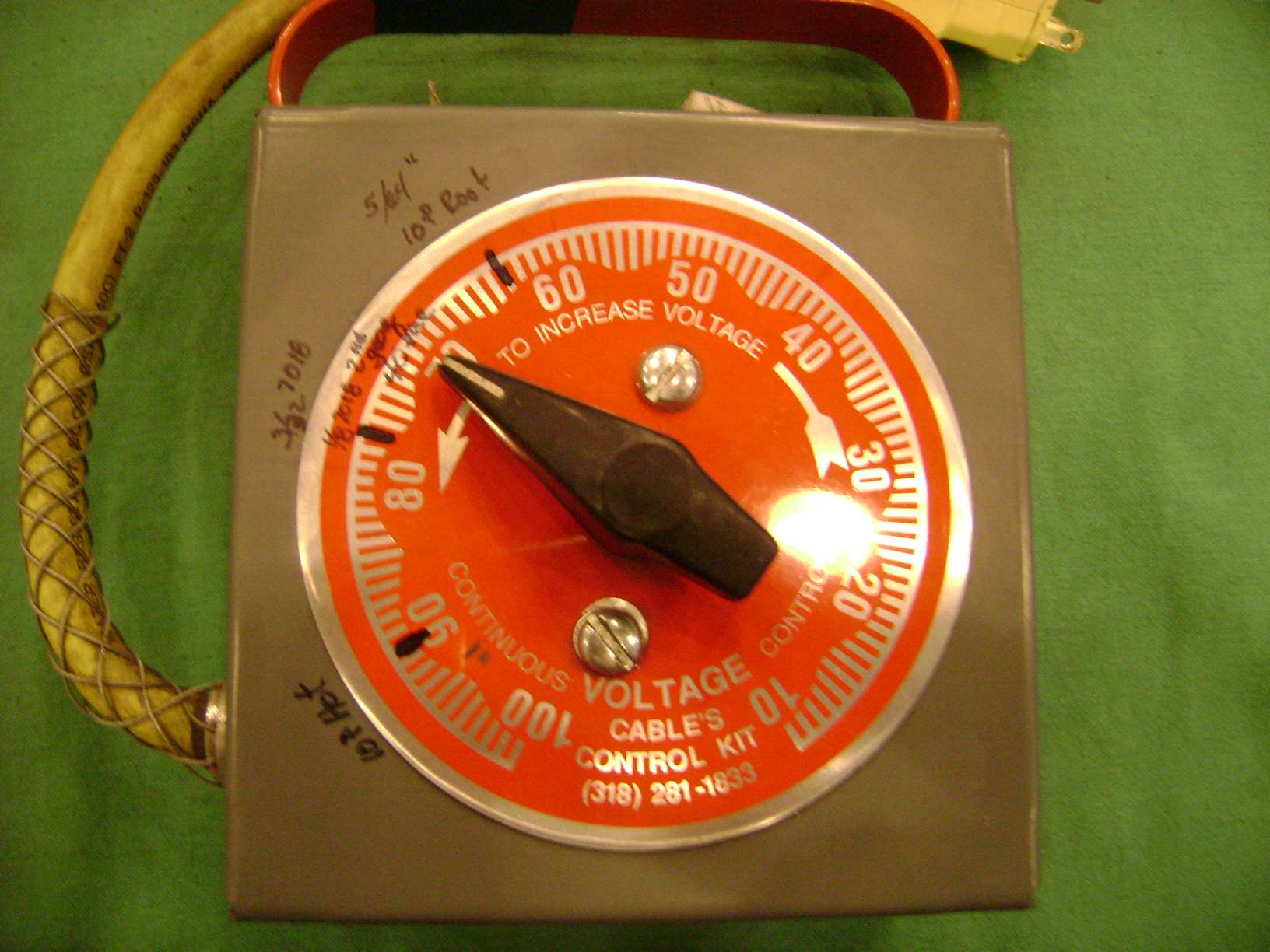

But I have eleven different machines, and they all run just a little differently. So I mark on the face plate, and even keep a small binder with different joint prep, root gap, root face, and wall thickness with different size, and type of rods for each machine. Just way too much to try and remember. :laughing:
