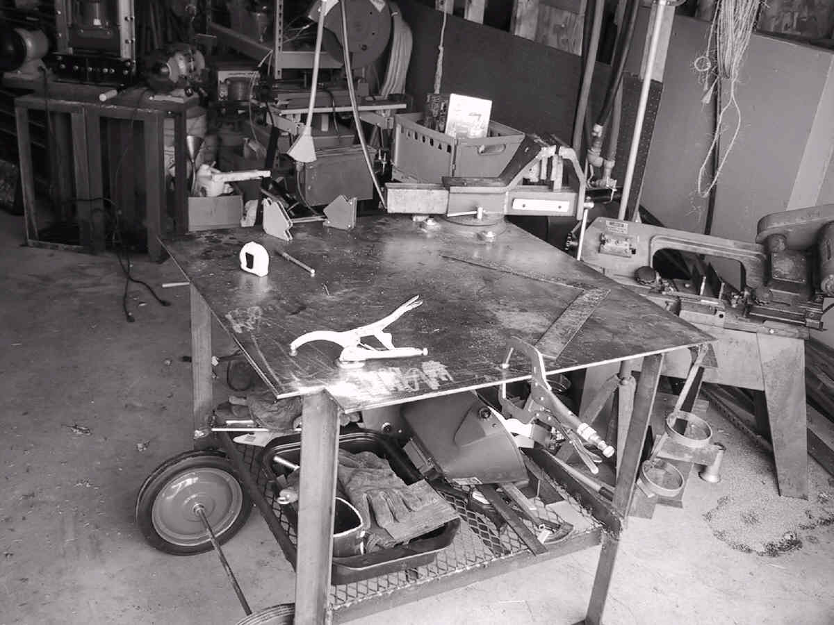

Another welding project. I got about $90 of precut steel in it. The vise was a cheap Indian steel(not cast) for $25. I plan to drill more holes for the vise-grip like clamp 6" or so away from the edge in the center. The square chunk out of the corner is handy, I have some copper sheat metal pieces I put under a weld so I don't weld it to the table if I don't use that cut-out corner. The wheels help me move-it around.
