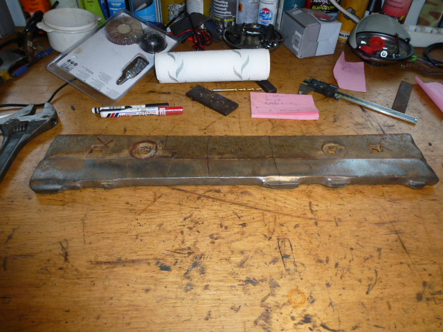

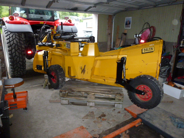

I bought a Dalen 2022 rear snow blade and have done some work to get it in shape. Replaced wheel bearings and some paint work.
There are 5 two-foot carbide insert wear blades and the middle one is missing some carbide inserts. See picture. They are very expensive and I would probably have to change all five of them if I change one.
Would it be possible to put som welding on it to straighten out the edge. It will likely not see very heavy work.
Anyone with experience with this solution?

If it was me, I'd just pony up the funds and replace them. Never seen anything like that before. My plow steels are all high carbon heat treated steel, not tungsten carbide.
   / Welding to repair snow blade wear bar.
Yes. I agree. The best solution would be to replace the wear bars. But the cost of all five of them would be about $900, and I have just bought the tractor, the blade and a snow blower, so funds are thinning out :). The financial aspect of snow removal is also questionable with diesel prices steadily increasing.
If possible, I would like to try some welding.
   / Welding to repair snow blade wear bar. #4
Then get yourself a combatible piece of mild steel and hard rod it. Be apprised hard rod has went way up in price as well. Just bought 10 pounds of Lincoln earth contact hard rod (DC reverse polarity) and it was 170 USD for a 10 pound sleeve. You really need to use an impact resistant high manganese hard rod or it will break off. If you hard rod it, be sure to bake the rod in a rod oven to drive off any moisture or the hard rod won't lay well and you can multi pass the Lincoln rod. some you cannot. You will also need to preheat the parent material to at least 750 degrees (f).

5030: Thank you for the advice. Your warning about hard rod price is very relevant here. The price here is about 3 times your $170, so it might be better to bite the bullet and buy new ones in heat treated high carbon steel. They should be a bit less expensive than the carbide ones.

That is actually a grader. For snow plowing just weld on a new cutting edge the whole length.
