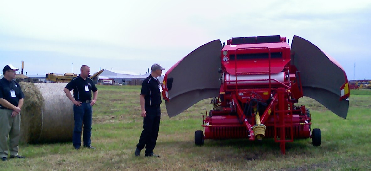

Welger produces and sells 3000 round balers a year. We all live in a world market because most of the equipment we use is made from places all over the world. On Friday I was a demo of a 435 Welger baler.
