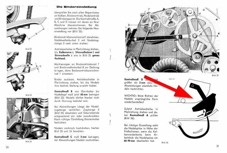

I have a question about what are called the "controlled restraints" in the parts book. They look like 2 x 4" knives that come up to oppose the ram pushing the hay back. They appear to work opposite to hay dogs. I have operated my baler for 2 years and only discovered today that this isn't working . Does anyone know what they do ?
I have loosely tied bales and wanted to see if there were any failed hay dogs that might be causing this. There don't appear to be any hay dogs, other than a sort of ratchet bar to hold thd hay toward the rear.
   / Welger WSA 350 bale size
Do you mean these things ? (red arrow)

No, that looks like the ram.
