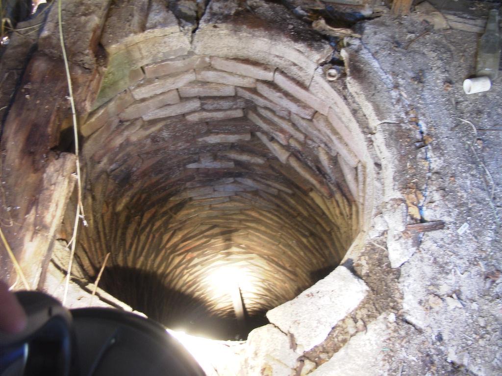

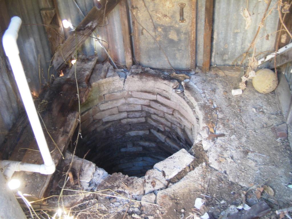

There’s a hand dug well on my property, it’s about 3’ dia. And maybe about 25’ deep. Not real sure on the depth. The wall of the well is brick lined, they seem to be dry stacked in place, no mortar.
I was wonder how that type of well was dug back in the old days. I’m a bit on the old side but that would have been way before my time.
Would they dig down to the full depth then start from the bottom and stack the bricks from there back up to the top?
If they did it that way, what kept the wall from collapsing in while they’re digging?
I’ve dug some deep trenches with my backhoe on my property and had them collapse on me so they had to have supported the wall somehow.
Could they have lined the wall with bricks as they were digging down?
How did they dig, there would not be enough room to swing a shovel.

to me, they'd us a cylinder to reinforce it, pulling it up as they ascended, adding brick row by row --

I grew up on a place with five hand-dug shallow wells about 30' deep. All were rocked up with about 1' oddly shaped sandrocks. When the wells were originally dug, they shored up as they went down and then rocked from bottom to top. Even so, many deaths have been recorded due to wall collapse.
On at least two occasions, I have repeatedly passed the bucket down to my uncle to fill with silt at the bottom of his well as he dug it out. We used a pulley and well-rope at the top on an A-frame. I remember it as a scary and tense time even with electric lights. The ladder he used was two wooden ladders nailed together. I've never been at the bottom of one of those wells and I'd never want to have to do it.

The way he (the septic guy) explained it, they would dig down by hand, filling up a bucket with dirt which a helper would pull up and dump, send it back down.
once at the bottom they would start bricking it up.
they said it would take about a month to dig a well, but back then it was the only way to get non-surface water.

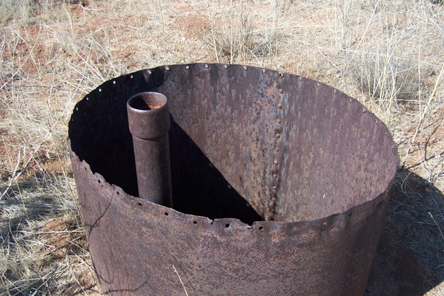

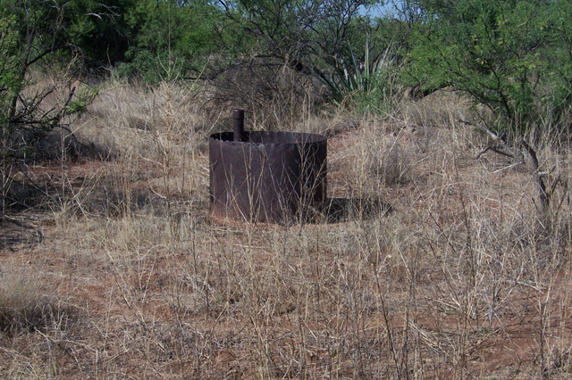

I have one on my place. It is in the middle of nowhere. No one has been able to tell me who dug or when. I suspect this one was dug around 1920 or so but could be as new as the 1940's. It has a steel casing is about 60ft deep and has started to cave in about half way down.
