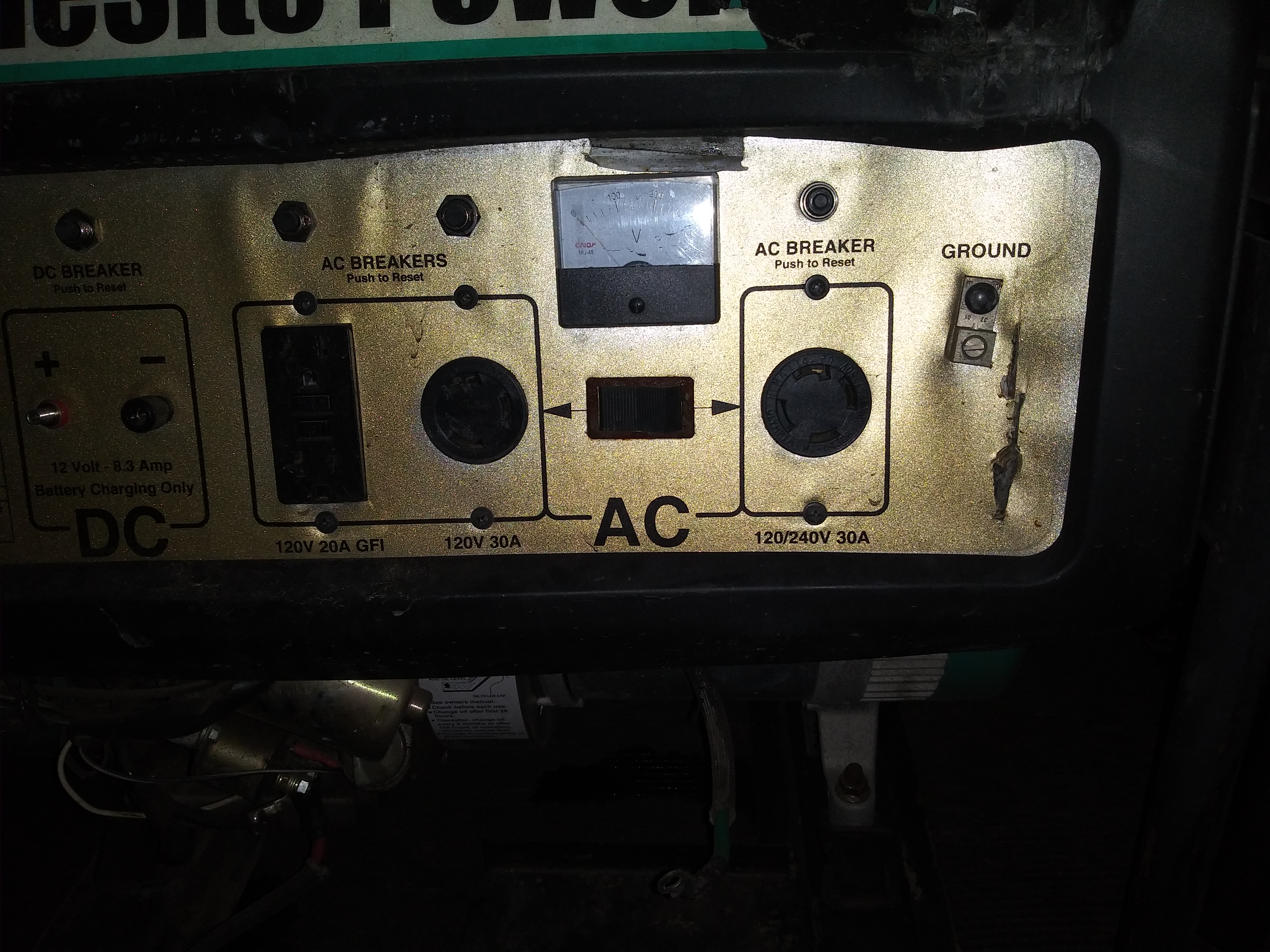

Can someone tell me which side of the generator I should be plugging in my well pump. Id assume the left. That where I get the power for my camper a/c.

It depends on the voltage your pump uses. 120 or 220 and the amps it pulls

No idea. 1.5 h.p pump. I was told 220. No booklet no nothing

   / Well pump/generator question #7
Control box is for 220V....
AIM Manual - Page 54 | Single-Phase Motors and Controls | Motor Maintenance | North America Water | Franklin Electric
Will wire to the 220 Volt twist lock on generator.....
You will need a L14-30P (plug) for end of cord at generator...
You will ignore White Neutral and just connect to Line 1 and Line 2 and safety ground...
Pressure switch it should just be wired in series between generator and pump controller...

Ok so outlet on the right. I was wrong.
Ignore the neutral. Thank you for the help
