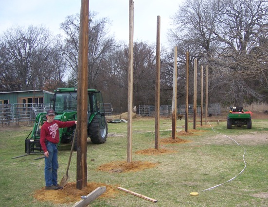

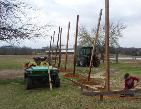

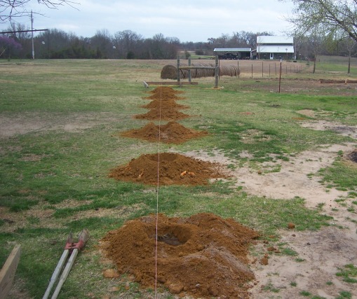

Thats right!! How this for burning daylight? My Grandson and I drilled the holes, put the poles in the hole and the wife ran the tape measure.

Just my 2 cents and its hindsite now for you, anyway I know their is more than one way to skin a cat!
I have built a couple pole barns and we have always put what we call cement cookies under each post and that all sat ontop of an 80lb bag of quickcrete.

Thanks for the imput ... the solid clay ground serves almost like a rock base. If you need to chip alittle away from the hole its almost like cutting rock. Thats a good base.
The poles are used electric poles, cut in half and then split in half length ways at the saw mill.
