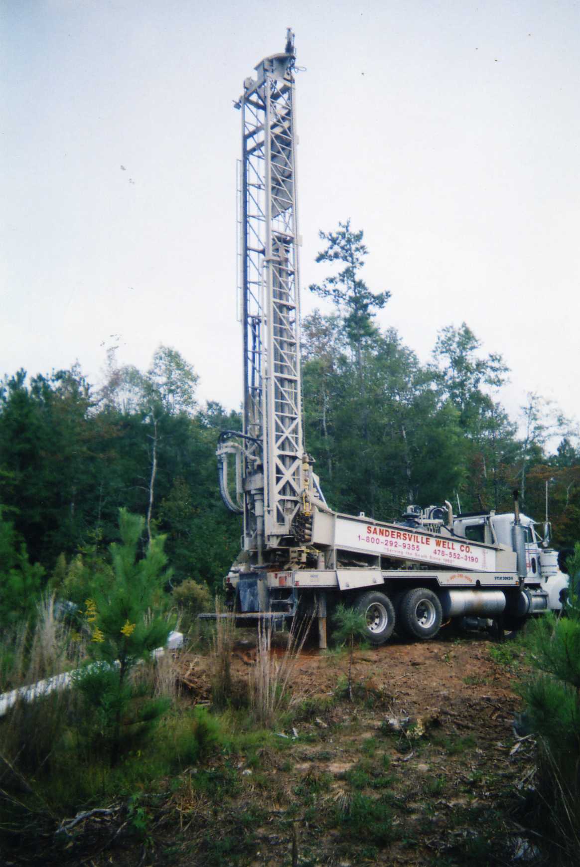

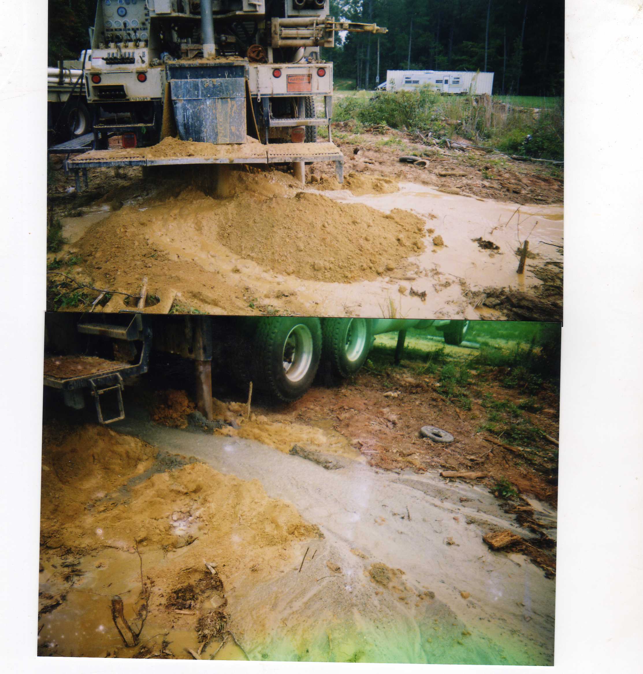

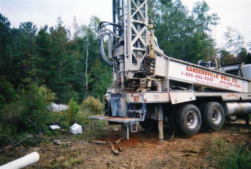

This shall be a quick overview of the last 2 years worth of progress on getting a well and making a structure around it.
Here are some pics of the well drilling rig, clay from 80 feet and granite from 120 feet deep.

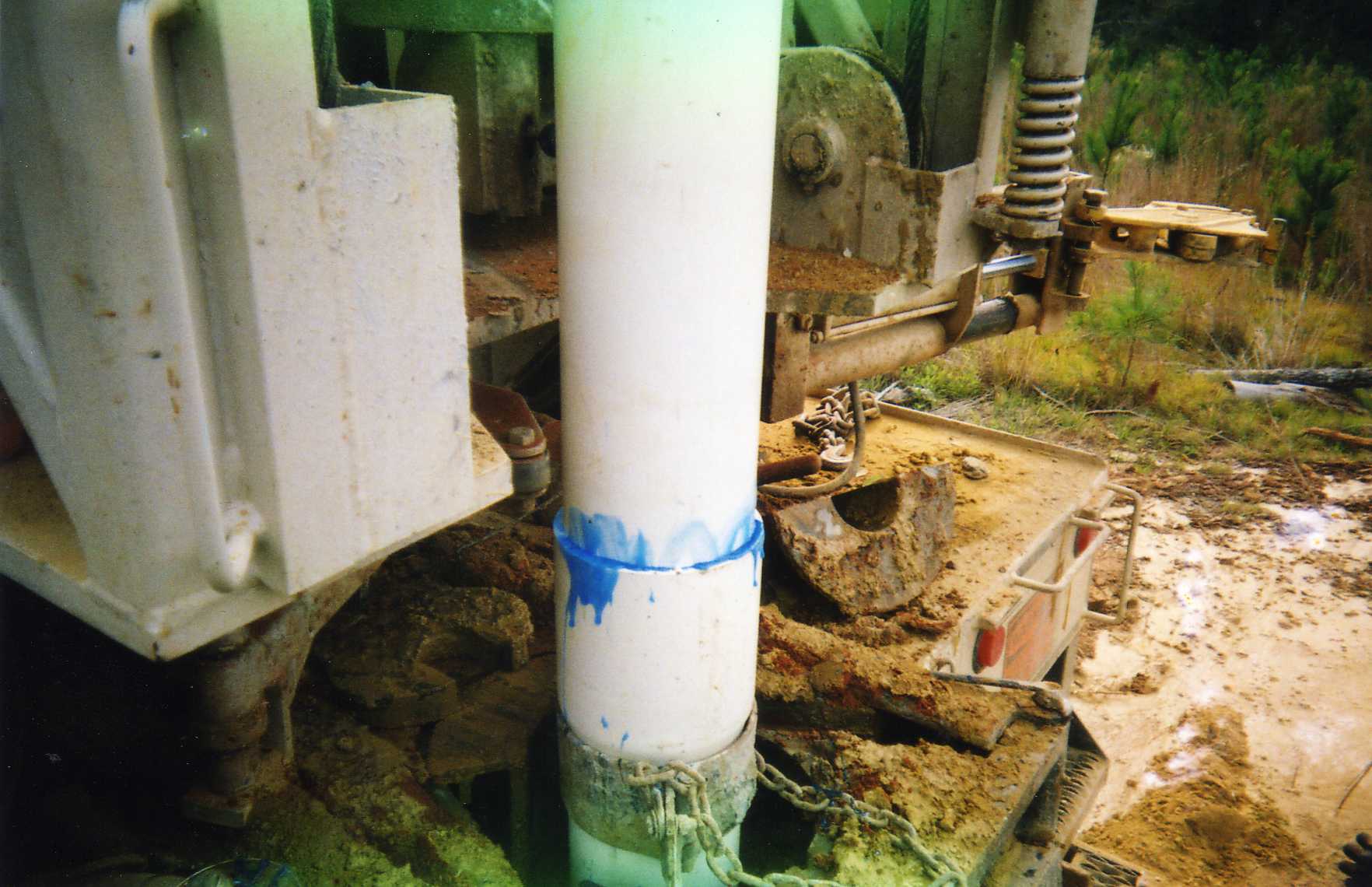

Here is the PVC liner going in and the finished product.
I didn't get a picture of the really hard part of this phase - handing over a check for 4K ;)

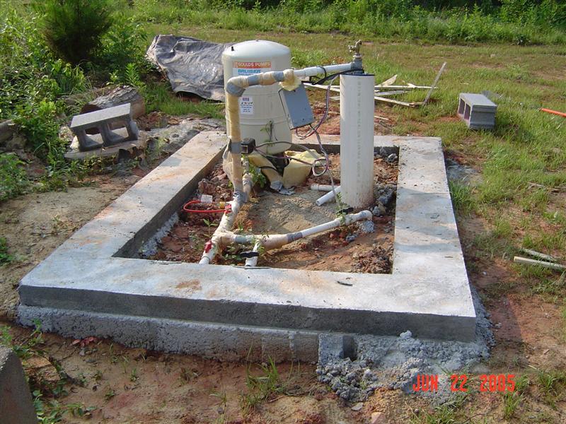

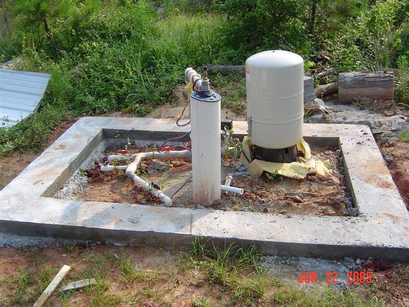

   / Well, well, well... Look what I got myself into
Here's the method I chose to run power to the well from the pole, and run water lines from the well. Highly recommend this method, $95 / hour gets the job done fast. No frost line here - 12-15" deep is plenty good (so far at least)
Also included an "after" shot of the long leg - running water out to the "oasis". (serves as my garden in the spring and an irrigated food plot the rest of the year)

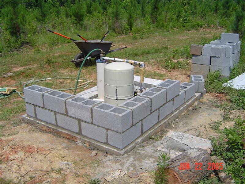

Next big phase of the job was making a foundation to set a building on. Had a friend in town for a weekend to help with this. 40 bags of 80# quickcrete. Foundation is 12" wide and 8-12" deep. (we went with the 'looks good' engineering on this one)
(We also built a shooting bench with roof this weekend)
Next day we stripped the forms and started some block work - my first time ever setting block - it was slow going at first.
Took a long time doing the block. 5 courses worth. Can't find any progress pictures of that.

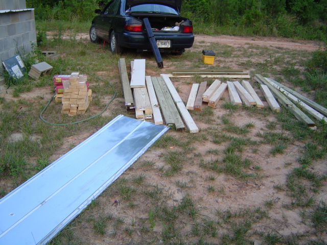

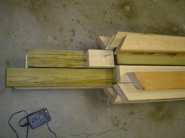

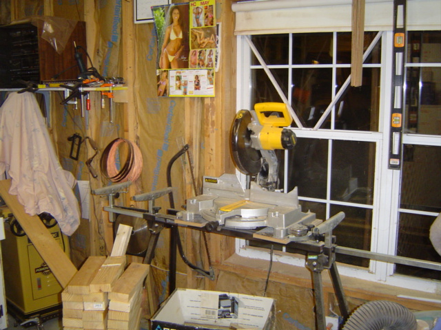

Fast forward to this summer and now it's time to get serious about a roof over it. I thought about this for a long time trying to figure out what I wanted vs needed. In the end I went with a slightly oversized building so I have the ability to store some of my irrigation equiptment and made it tall enough so I can walk in without hitting my head on the rafters.
Lots of work was done in my basement shop such as drawings and pre-cutting most of the parts. Much easier doing this at home and makes my day at the farm much more efficient as well.

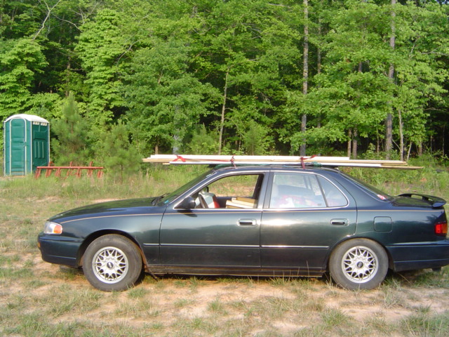

People laugh at my car, especially when I am headed out to the farm like this. But I had a choice... nice truck or buy my farm. It was a no-brainer for me. I know probably a dozen people who have much nicer cars than I do, but nowhere to hunt deer ;)
Anyhow - load everything up and make it to farm just before dark. Unload and keep an eye out for vermin. (always carry a sidearm - especially after a run in with a wild pit bull a couple years back)

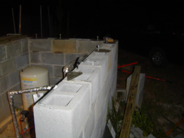

Just because it is dark doesn't mean I can't get some work done. Time to set j-bolts. 6 x 80# bags of quickcrete and that job is done.

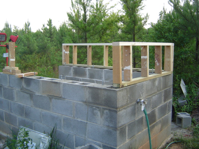

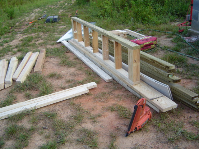

The next morning I started framing the walls. Having a cordless nail gun made this job much easier.
