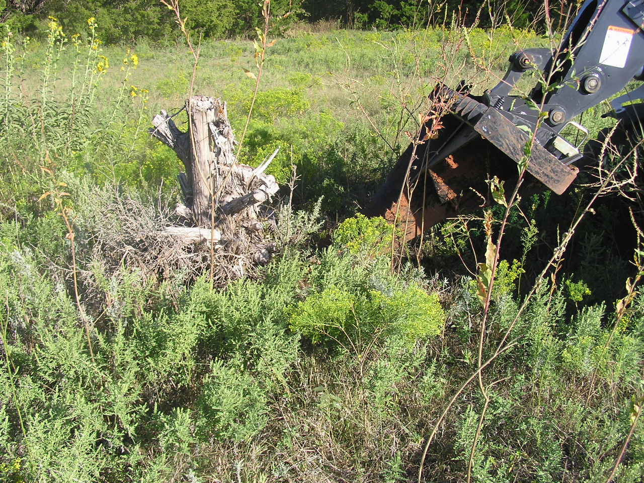

   / What are my options for removing tree stumps? #8
I am borrowing a buddy of mine skidsteer\Bobcat. I might can do something with that but some of these are pretty big. I was also thinking stump grinder rental but not sure if I can get one big enough or if that matters othher than overall time per stump.
If you can rent a stump bucket, the skidsteer will do it.
I have this Blue Diamond brand, it is the longest, for better leverage.
