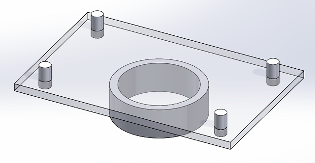

Or more importantly, is it okay to use them for interfacing with a jack adapter plate? Holes are about 1/2" diameter on a 3.375" x 6" pattern. Need to lift up the back of the tractor to take one of the wheels off and was thinking about making a jack adapter plate that would have some 3/8"-diameter pins on it that stick into these holes. Other side would have a short length of tubing/pipe that the head of the jack would fit in.

Here's what I was envisioning. Plate is 1/4"; pins are 3/8" diameter and stick out 1/2".

I think it for use with a swinging draw bar if I'm not mistaken.

Any idea what size bolts? That would make the plate even simpler if I just drill holes in it and use bolts to attach it. The holes under there on mine were pretty dirty - they didn't appear to be threaded - maybe I need to get under there and clean them better. :scratchchin:

5/8 x 1 3/8ths.coarse.

Excellent - thanks! I'll have to get them cleaned out this weekend if it's not raining.

They are for the drawbar.

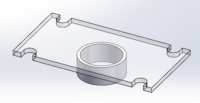

Got the holes cleaned out this weekend. Good bit of dirt up in them. Used a combination of homemade thread chaser, a semi-spiraling o-ring pick, and a pipe brush to get it all out. They are indeed 5/8-11 with a thread depth of approximately 1.25".
Also changed the design of the plate so I can use some 1/4" x 4" flat stock I've got laying around:

All that work to take a wheel off? What are you taking it off for?

It's not too bad - so far all I've done is futzed around on the computer with designs, laid under the tractor a little bit, and cut a few bolts down (the shortest 5/8-11s that Lowe's had were 2", so I cut them down to 1.375"). Figure it's worth a little time and material for the added peace of mind. I may have to add a hanging hole so I can put it up on the pegboard instead of rummaging and cursing when I need it again. :)
Left rear axle seal is leaking. Got oil down inside that wheel. The brakes weren't too confidence-inspiring last time I used the tractor, so I figured I'd better fix that before I use it again.
