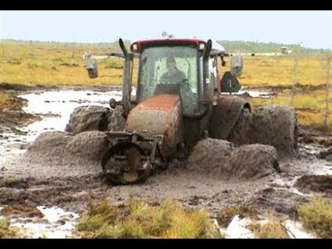

If tractor tires become mired in mud it's to wet. If you can't see the tiller for dust it's too dry. Finding ambient temperature and wind direction just right can be more allusive.
