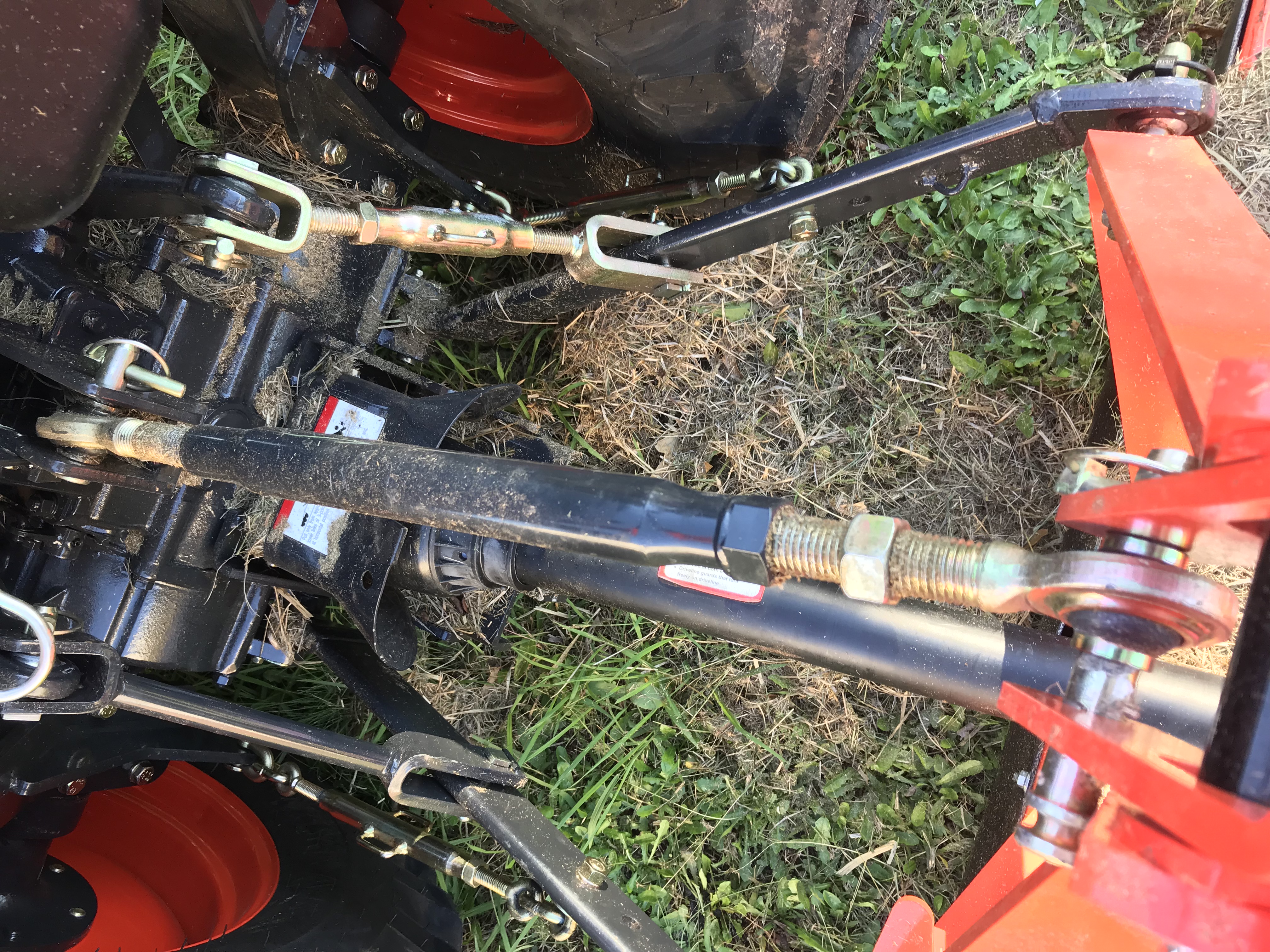

Just got this thing and this is how the dealer dropped it off.
Certainly those gold colored adjustable bars that are attached to the lift arms do not just lay there and flop around. Certainly they are to fasten somewhere but I do not see it. There is one link of chain one the right one and a U shaped coupler (missing its pin) on the left one.
Im stumped at the moment. I see no place to attach them. My old Ford had no such things on it.
Afraid to bush hog with it like this and my Dealer is out on the lake participating in a Bass tournament. If yall can shed some light so I don't have to mess up his day Im sure he would appreciate it.

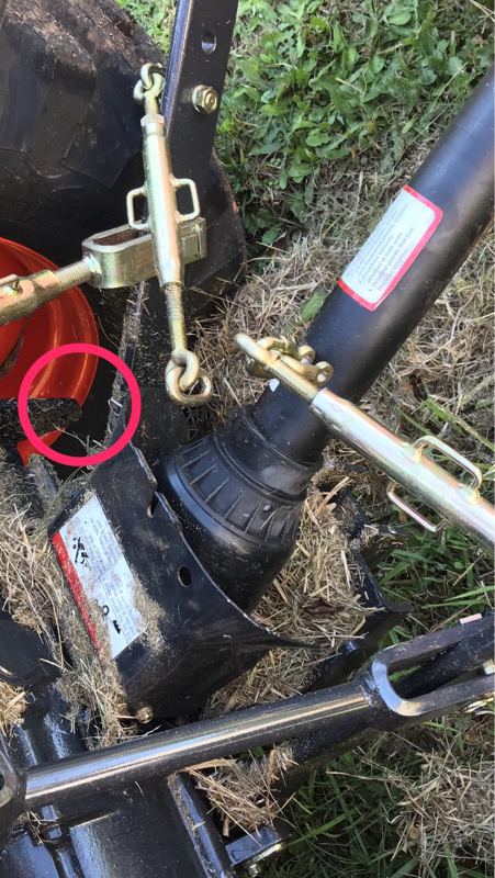

   / What are these and where are they supposed to be? #2
The pin in the U shape clevis goes in the hole I circled.
So both of them attached to that hole? The pin is gone but I could temporarily bolt them I suppose. Anyone have a picture of that all in proper place?
Ok.. I figured it out now. Missing one clevis and both pins. Gotta make a run to the dealer and get him to replace. Easiest thing to do

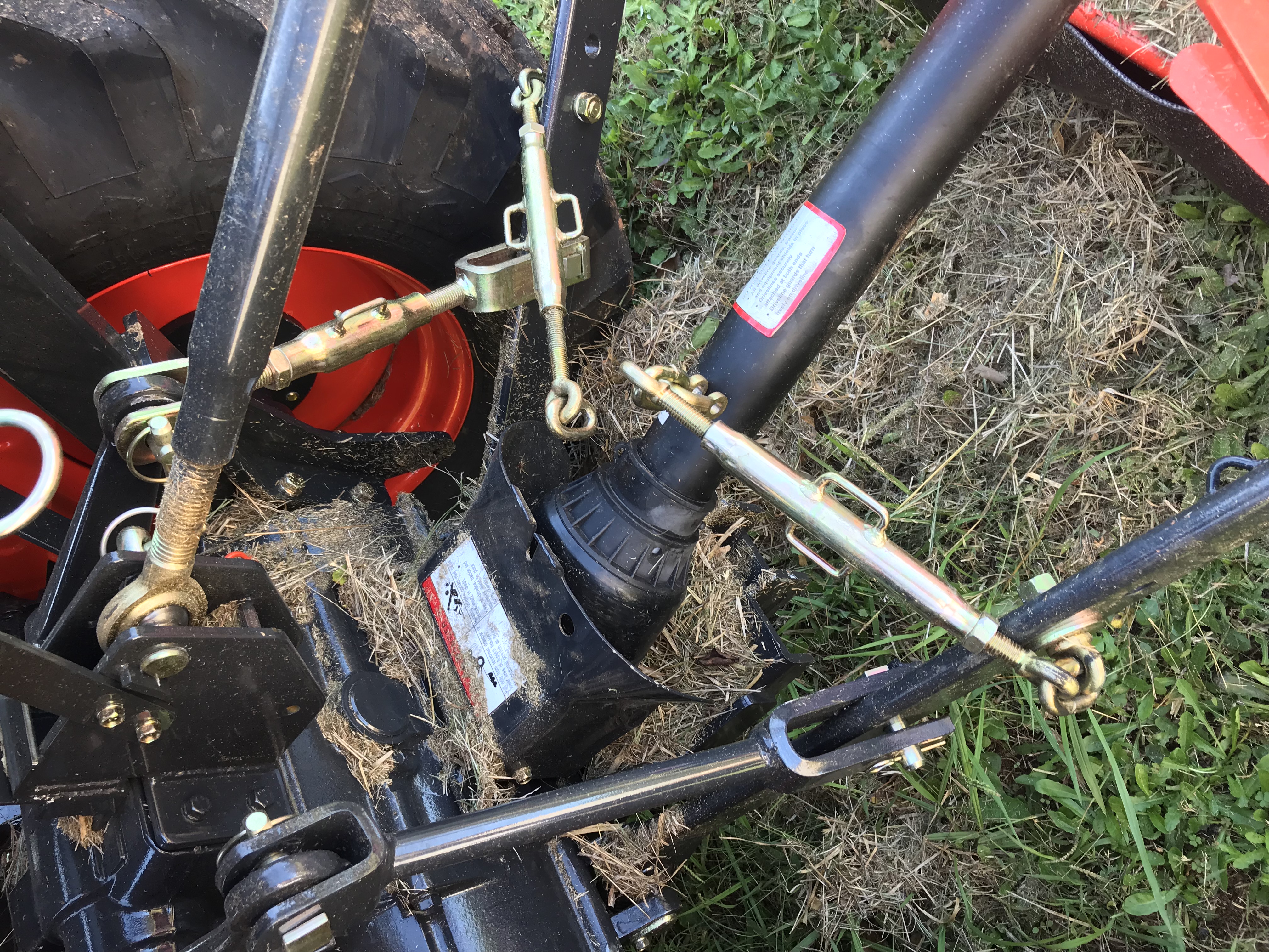

All better now...

   / What are these and where are they supposed to be? #6
Not quite. Both should be snug once you have your implement positioned where you want it. I noticed the slack on the right side, Having both snug will minimize any side to side motion. Hope this helps

... as predicted! Wait for it!!!
Lost one of the turnbuckles today! The left one. After about two hours of hogging. Even with the jam nut tight it somehow worked itself loose. So perhaps snugger (is that a word?) was in order in hind site. There must be a happy medium that I missed. It would have near the end of my work on making a outside turn on a slope I felt it suddenly start to shake a bit more than usual. Looked back and it shifted way over to the right. The right one stopped it shy of being any danger but it was over more than it should be. So I stopped and shut the PTO off and got off and and looked and darned if the threaded eyes were all hanging there but the turnbuckle had gone missing! I of course stopped work and figured it was close by. But I cannot find it at all. So my bad now.
Darn things. Its like the three stooges for me this week. I gotta find one or get them to give me one. I think maybe i'm leaning towards getting some solid stabilizers. Anyone know a source?
At the moment I just need another turnbuckle. No time to get over to the dealer today.... maybe Tractor supply? Doesn't look anything special?

It also appear the jam nut followed it off there. Of course! LOL...
Here is a picture of how I found it.
