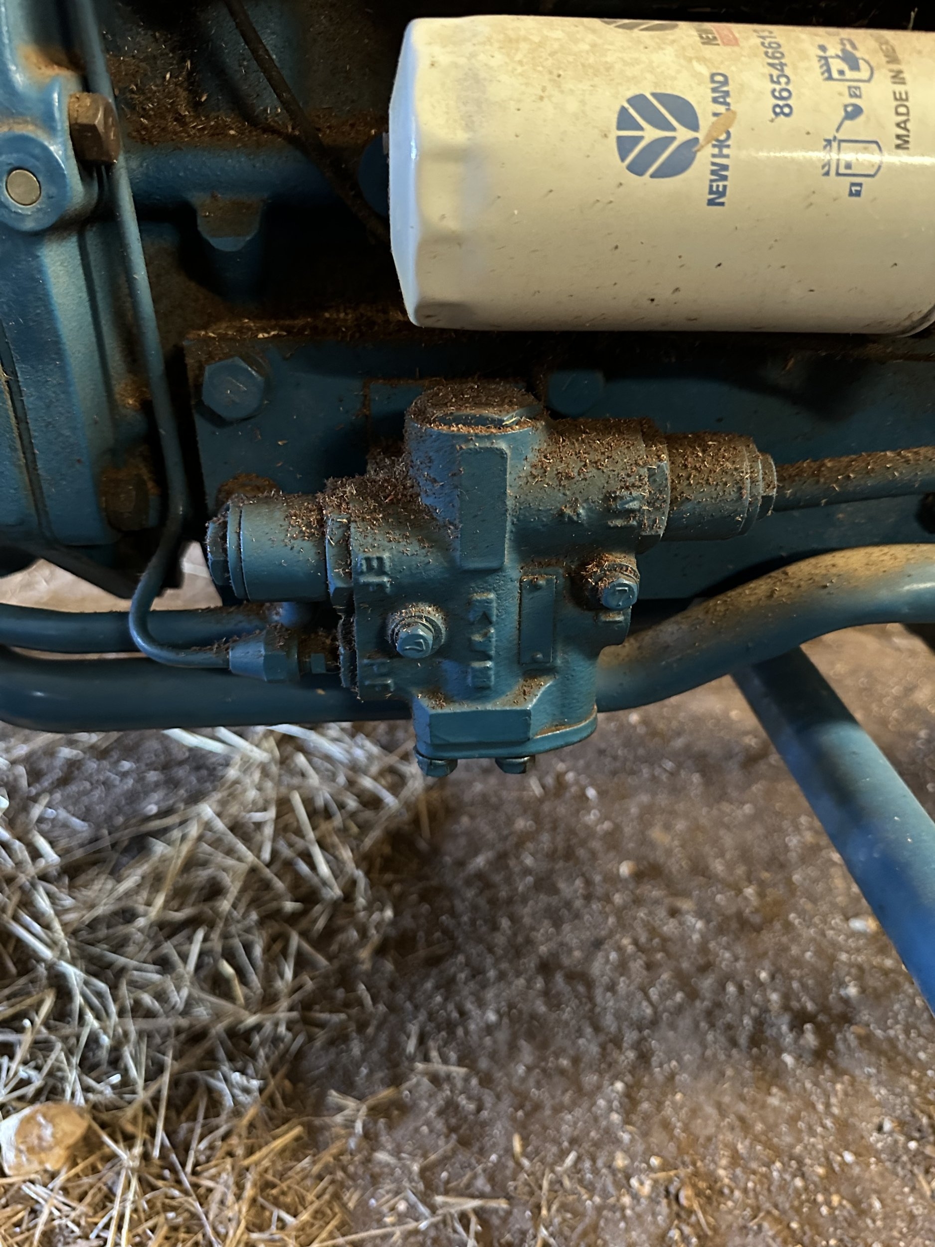

What are these part
   / What are these part #1
Brady D
Oct 29, 2021
216
Southern Middle Tennessee
Ford 1910, Case farmall 95, John Deere 317g
What are these part
   / What are these part #2
The top picture is of the hydraulic priority valve that gives the steering hydraulics priority to the oil flow.

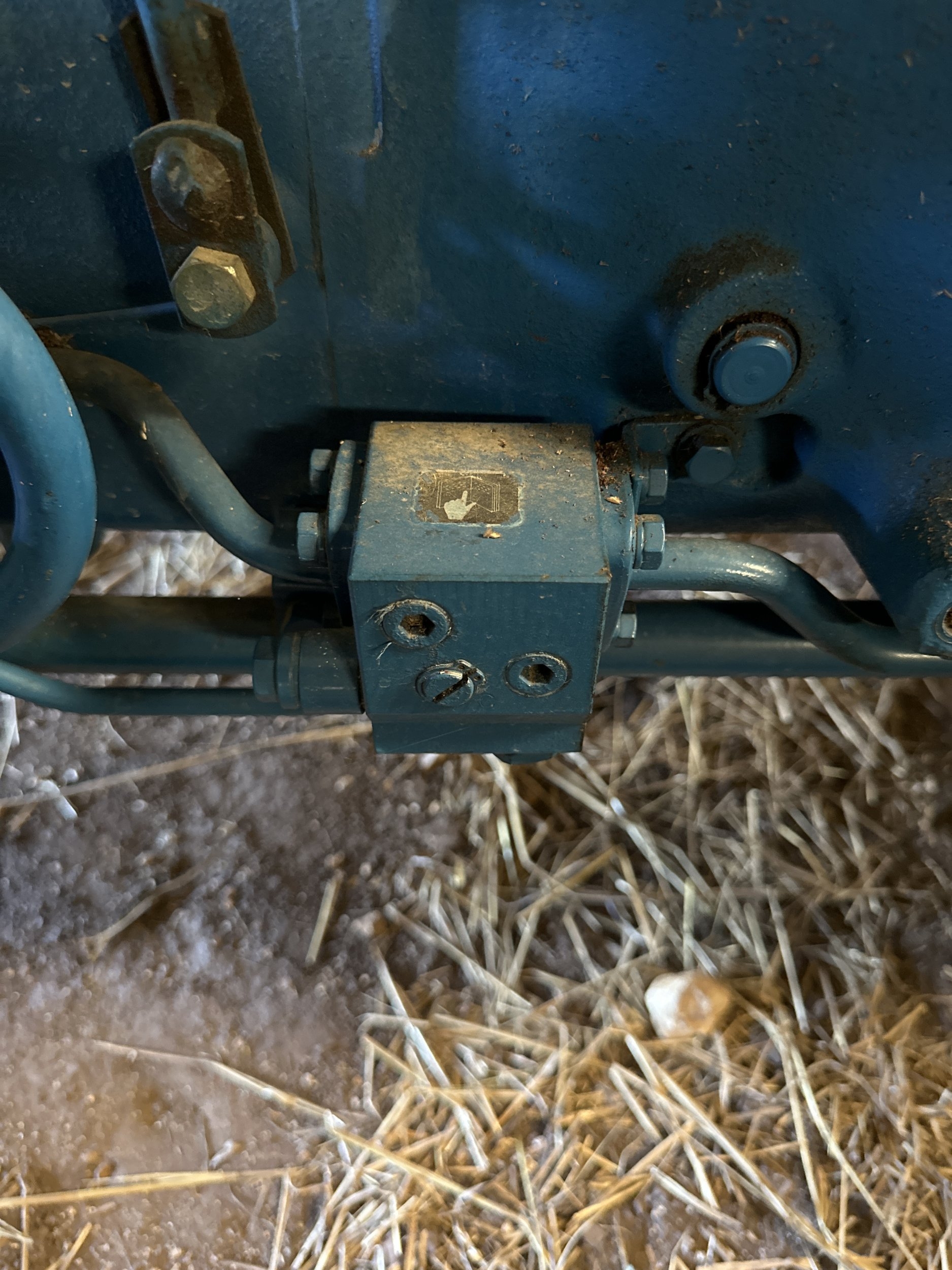

The 2nd is of the diverter block that allows a point to tap into the hydraulics for a loader, among other things.
   / What are these part #3
On my TC33D, when the loader was off, I would take a screwdriver and turn the slotted part so the loader lever had no effect.
