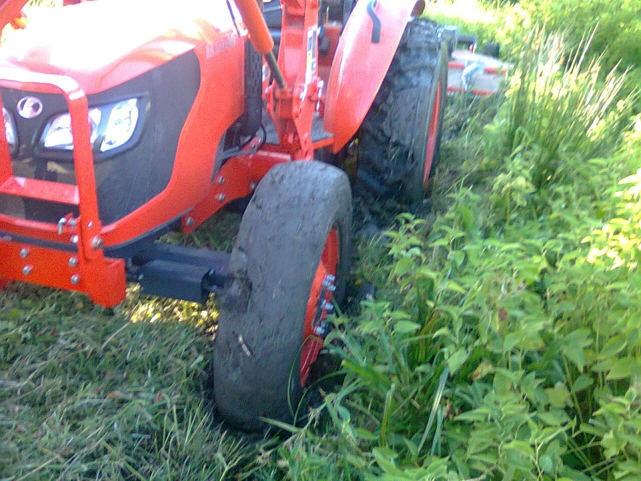

I usually throw in the towel early cause most of the time just gonna get it worse(someone usually close that can bring another tractor or neighbor has backhoe). My latest kubota stuck.JPG

You're loader wouldn't pull you out of that?
Well didnt have anything on it:laughing: But it was an underground spring,it probaly just made it worse.I could only go out forward,backwards would have got me in deeper..
Quick pull of the father-in-laws tractor and it came right out but if I would have kept spinning it down his 2x4 would have trouble getting it out..
