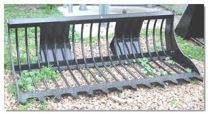

I raise lambs and need to clean corral areas of old poop. What attachment would do this without moving dirt as well.
/ What Attachment Do I need #3
Do you have a front end loader? Maybe a rock bucket? That's what my neighbor uses for horses. Like a stall rake on steroids and 1000X the cost. But 1000X more fun to use and has plenty other uses as well.

I've raised sheep and goats. Typically, there is a layer of pulverized dust/material sitting on top of dirt. Only thing I can think of would be a box blade behind a nimble tractor. Set angle of blade to just skim the surface pulling along the dry pulverized material but not cutting down into the underlying dirt (or at least much). The angle is critical here, have to experiment to find the right one. Pull into a pile then use FEL bucket to pick up and transport out. Problem is often the pens are small and difficult to maneuver and/or gates too small for equipment, and the material is extremely fine dust.
Let us know what works for you!
/ What Attachment Do I need #7
These look really nice. Think the shipping to Nevada would be cost prohibitive for us. Thanks for info.
You can purchase something similar in your area, I'm sure. The picture and name of the attachment can be used for reference.
