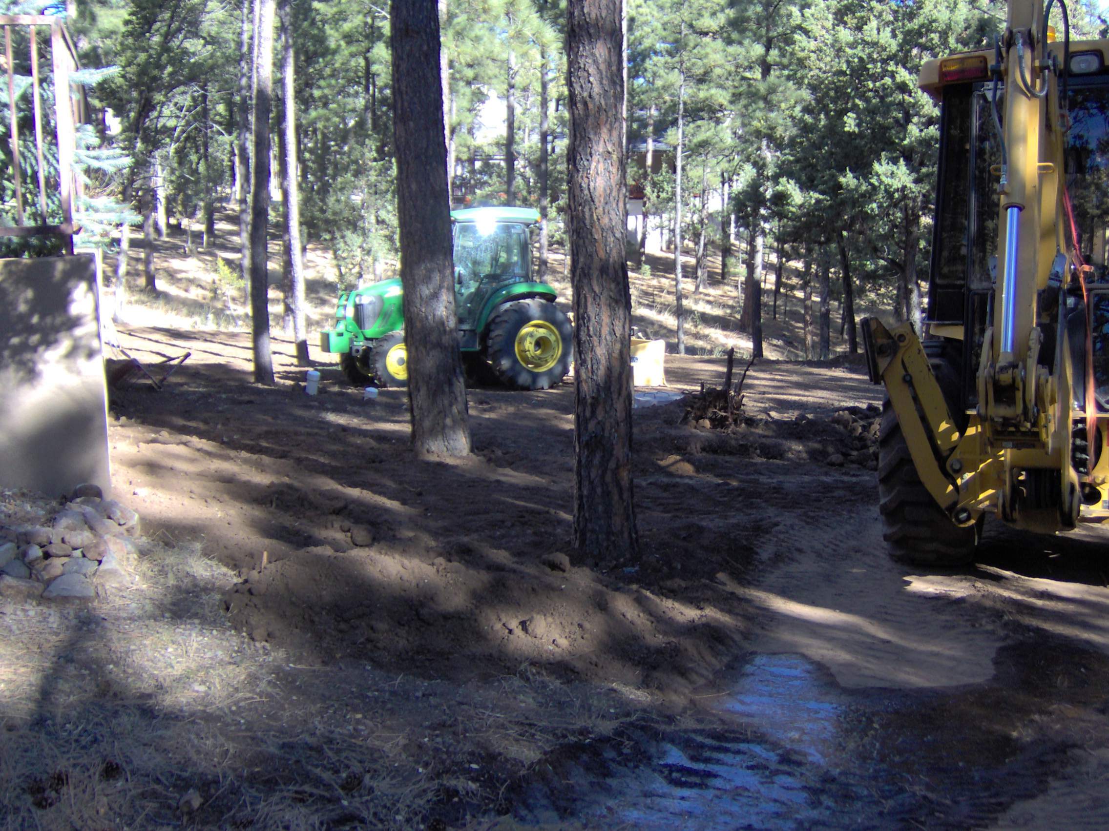

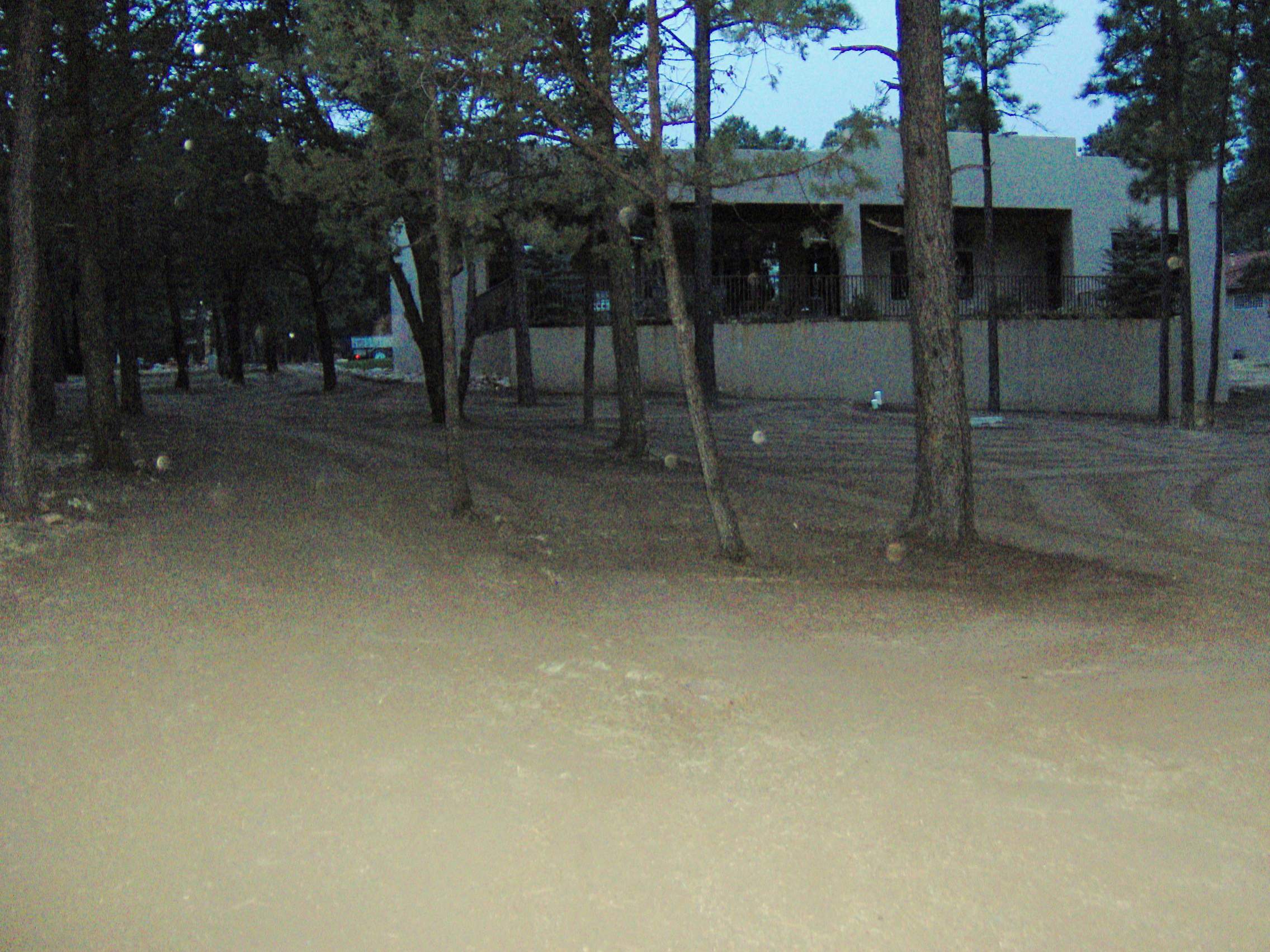

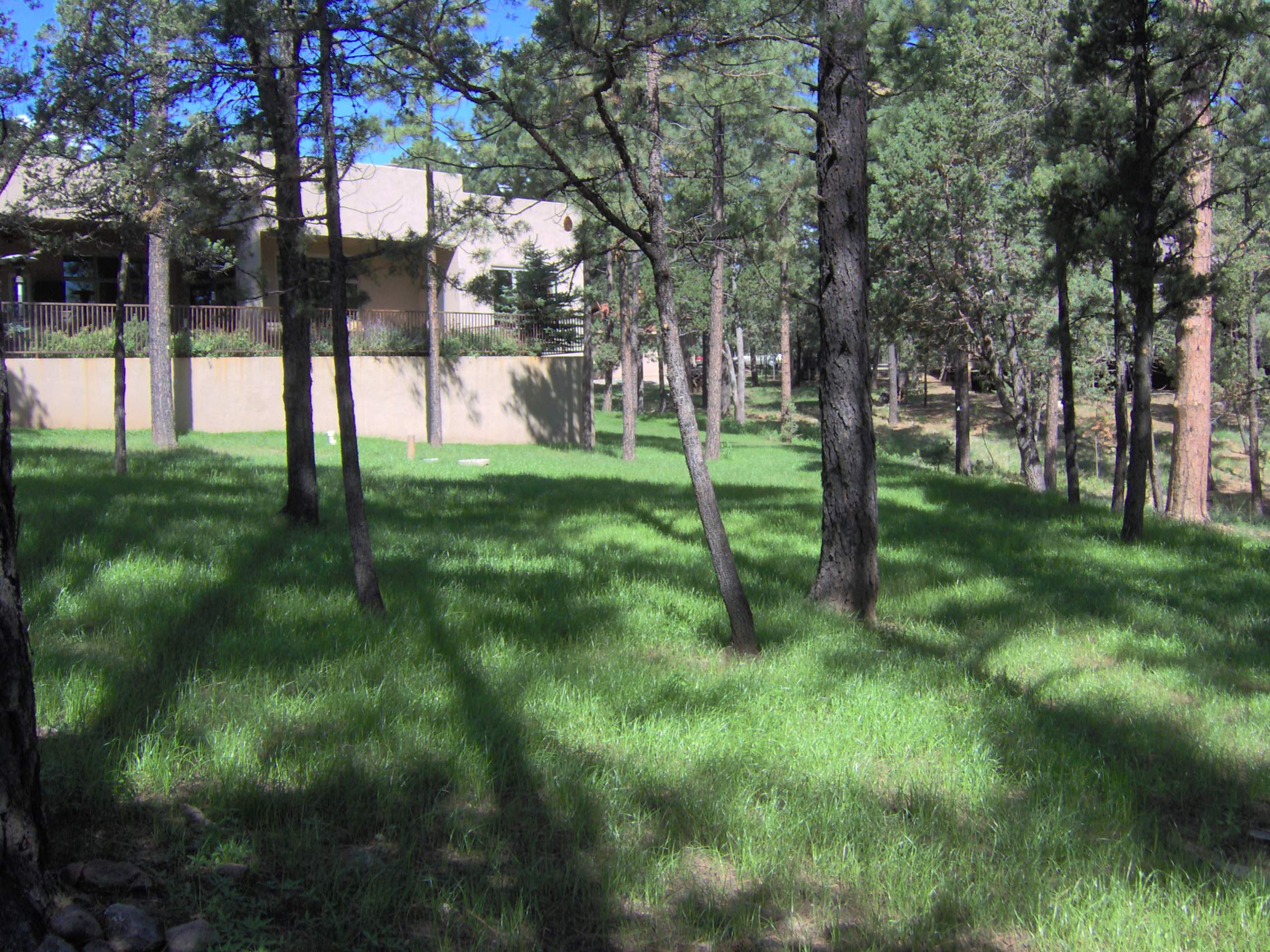

I do a lot of this type work, spent the weekend cleaning up about 5 acres. I would recommend a pine needle rake followed by a roller. The tines on the pine straw rake are not as aggressive as the landscape rake so will smooth out the surface enough that you can run a roller over it to tamp it down. I have had good luck with broadcasting grass seed and adding an additional pass with the PSR before finishing with the roller.
Everything Attachments has the Pine straw rake in two sizes, I have gotten my money's worth out of this tool for sure. EA makes the best one I have seen so far.
Here is a picture of the finished ground on a project a few years ago where the PSR and roller worked well between the trees.
