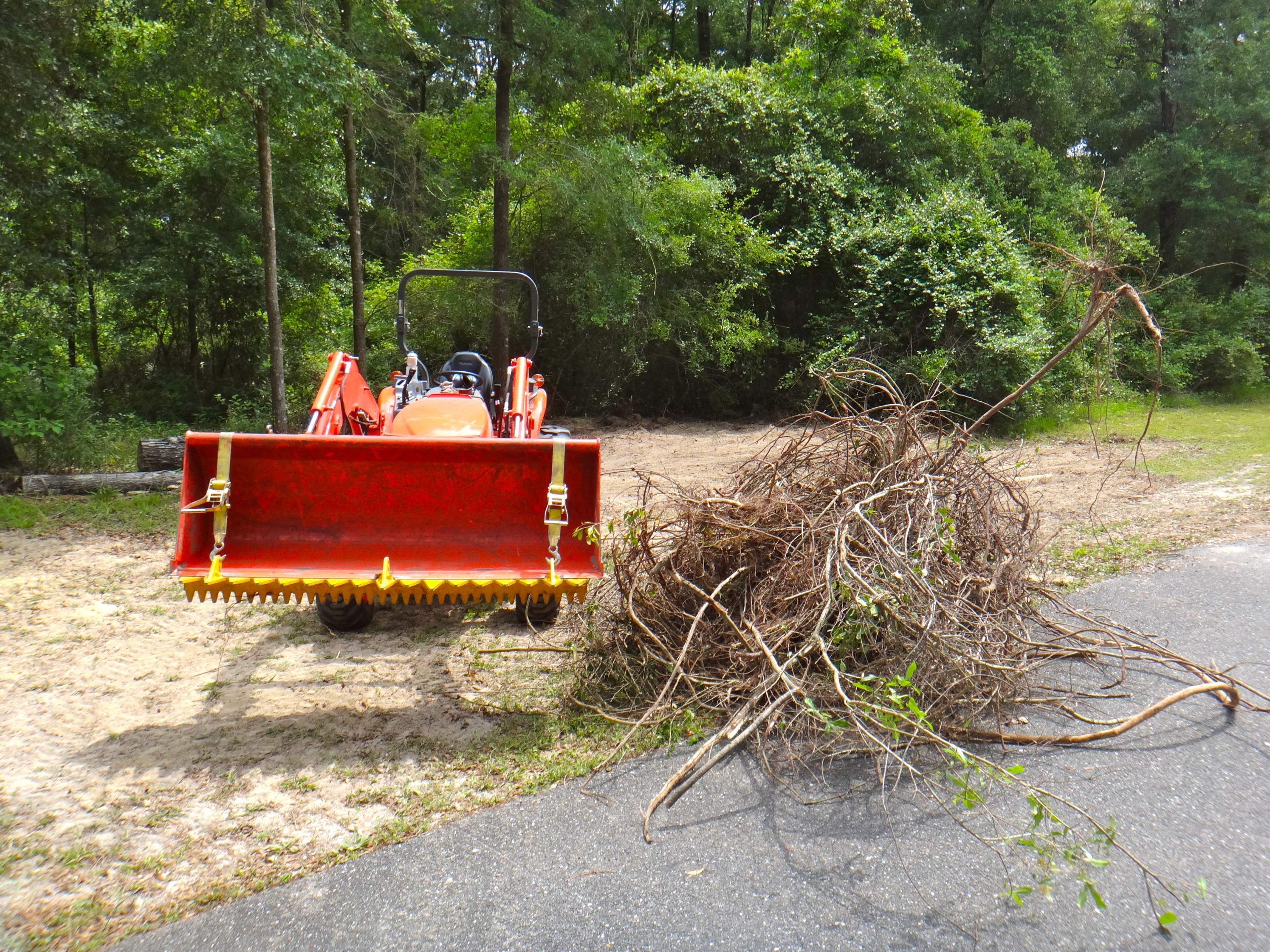

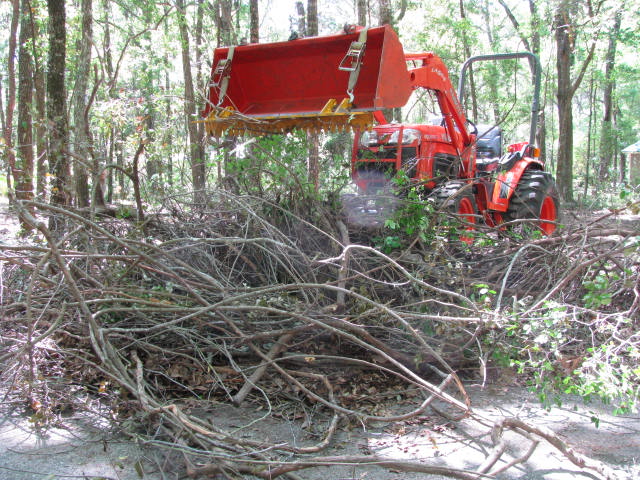

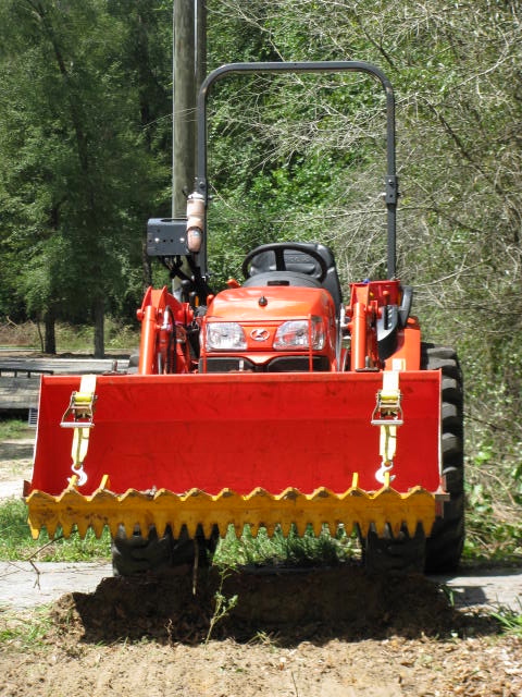

A Ratchet Rake attachment for your bucket is excellent at collecting yard debris into piles, for spreading top soil and for minor grading.
Available through the T-B-N store with convenient UPS delivery.

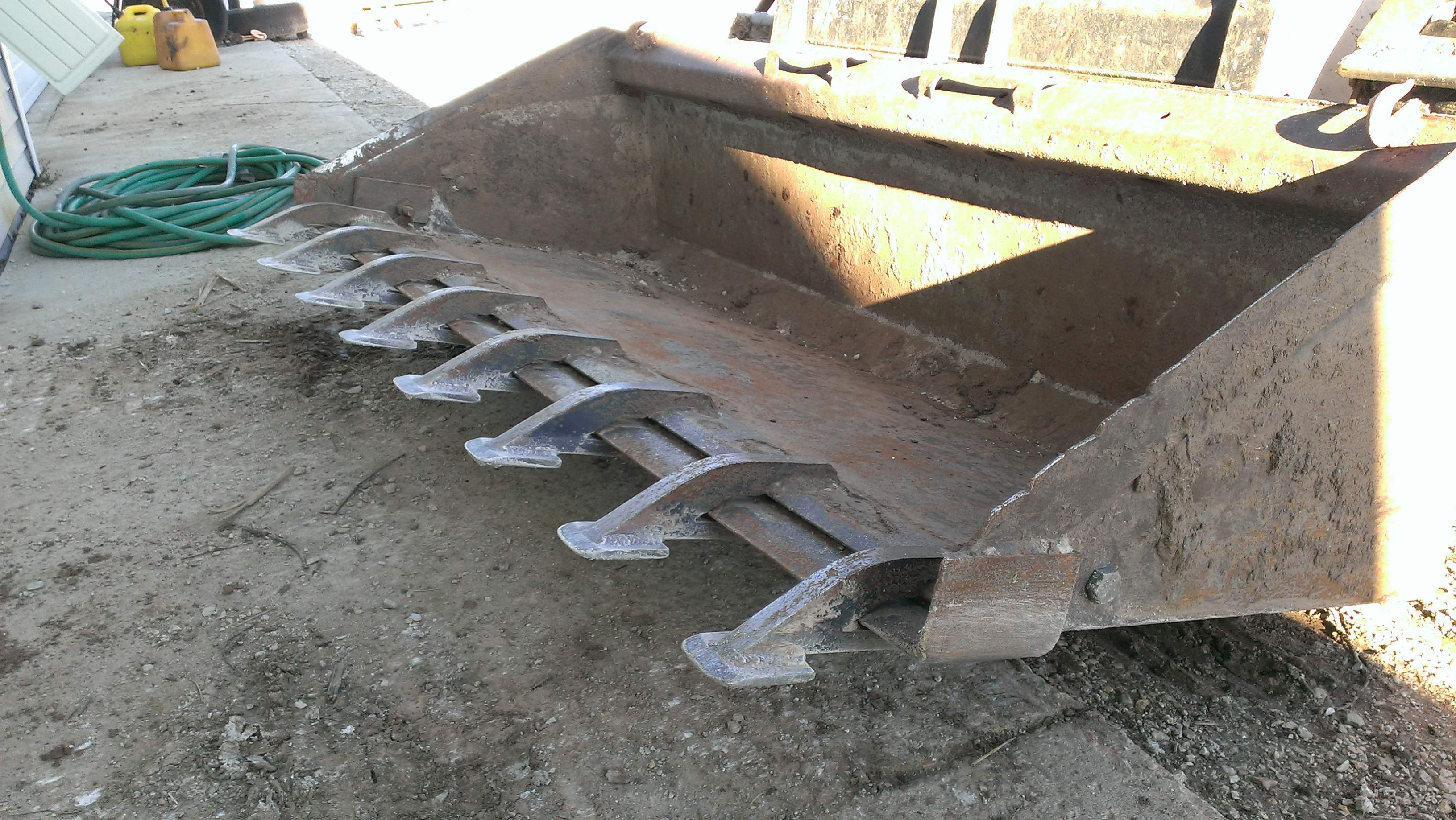

   / What attachment is best to use need some help please #7
cost effective, strong removes and installs easy. I made it, had a machine shop cut the hoots for the teeth.
