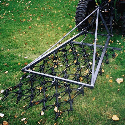

Thanks for the information. They had several types of harrows on the Norther website. Which one would be best for what I need? Go with the chain harrow rake or would one of the others be better?
Harrow Rake picture attached.

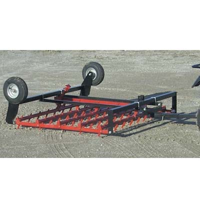

Spike Tooth Harrow picture attached.

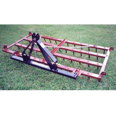

5-Bar Spike Tooth Harrow picture attached.

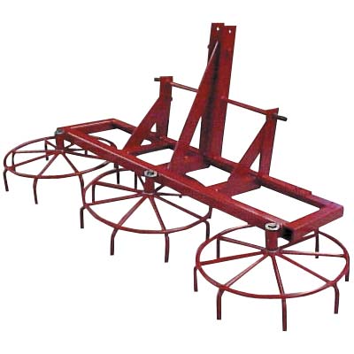

Spider Rotary Harrow picture attached.

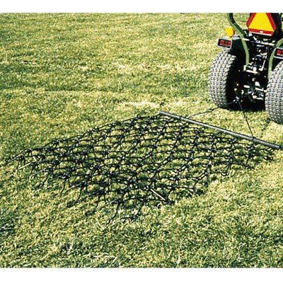

3-Point Harrow Rake picture attached.
