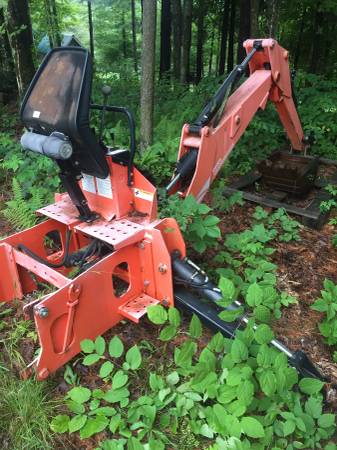

Kubota L4400
I have a Kubota L4400. What would be a good back hoe? I've just started looking into this. I see a Woods BH 9000 on Craig List. The ad says it came off a Kubota L 3840. Would this work on mine? It's advertised for $5500. The ad claims this is half the cost of new....

Is it a 3 point hitch hoe or a does it have a sub frame. There are people on here who will tell you don't get it if it is 3 pony one. They will say it will break your tractor. If you use it with common sense you will not have a problem.
   / What Back Hoe To Buy?
Looks like sub frame.

"Berwick, ME" ???
You live where there are rocks and clay.
DO NOT BUY a 3pt. hitch backhoe!
   / What Back Hoe To Buy? #5
I have rocks. IMG_0601.JPG. I agree that sub frame are more sturdy, but 3 point hitch ones are not that bad. I don't have a problem with mine. Ballast boxes are a lot of stress on three point hitches when you go over bumps.

Work and fit are two different things.
If you get the subframe and it fits or is modifiable that would be great.
Grab a manual for it off the Woods site. Very likely you can get a Safe-T-lock kit (see pic). I'm thinking of trying to get one built for my M4700/BH70-X combo.
513426d1498455534-what-back-hoe-buy-woods-bh-3point-jpg
Corresponding with Woods they use the 3pt kit with larger tractors and recommended it for my M4700.
