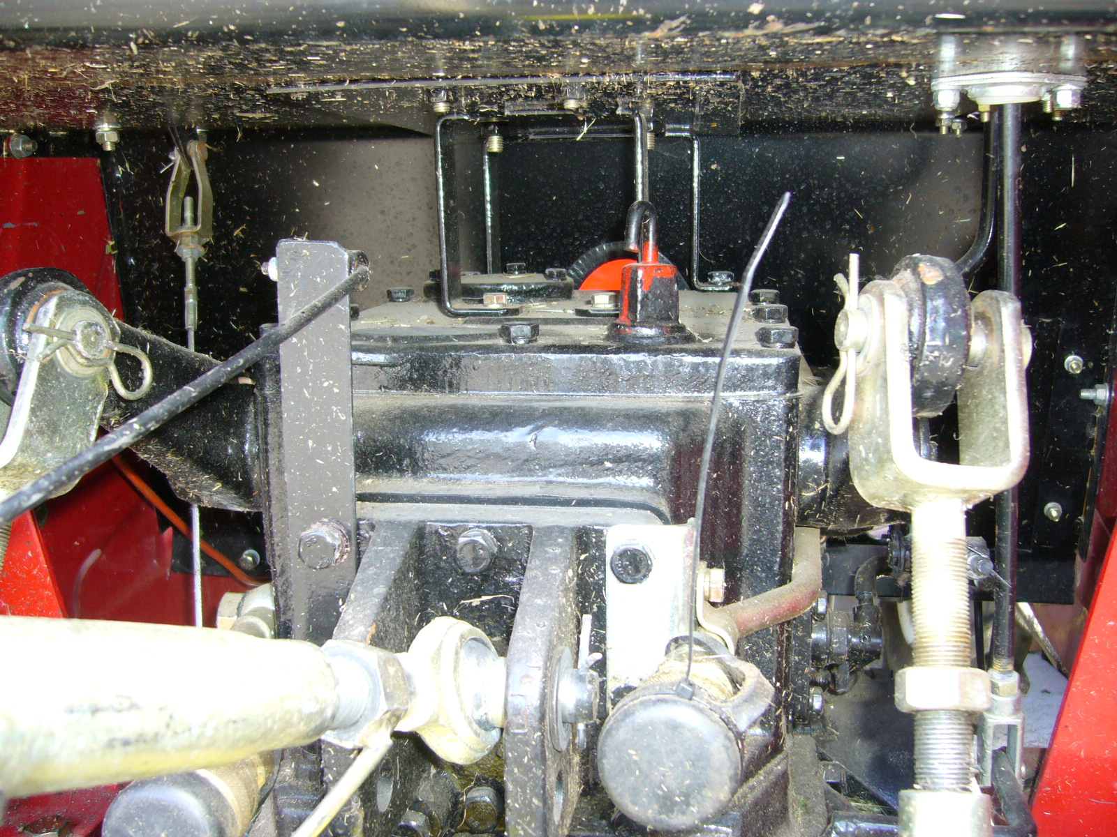

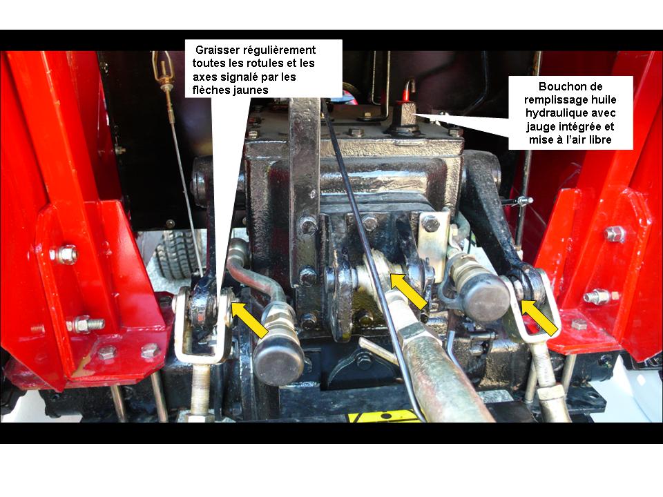

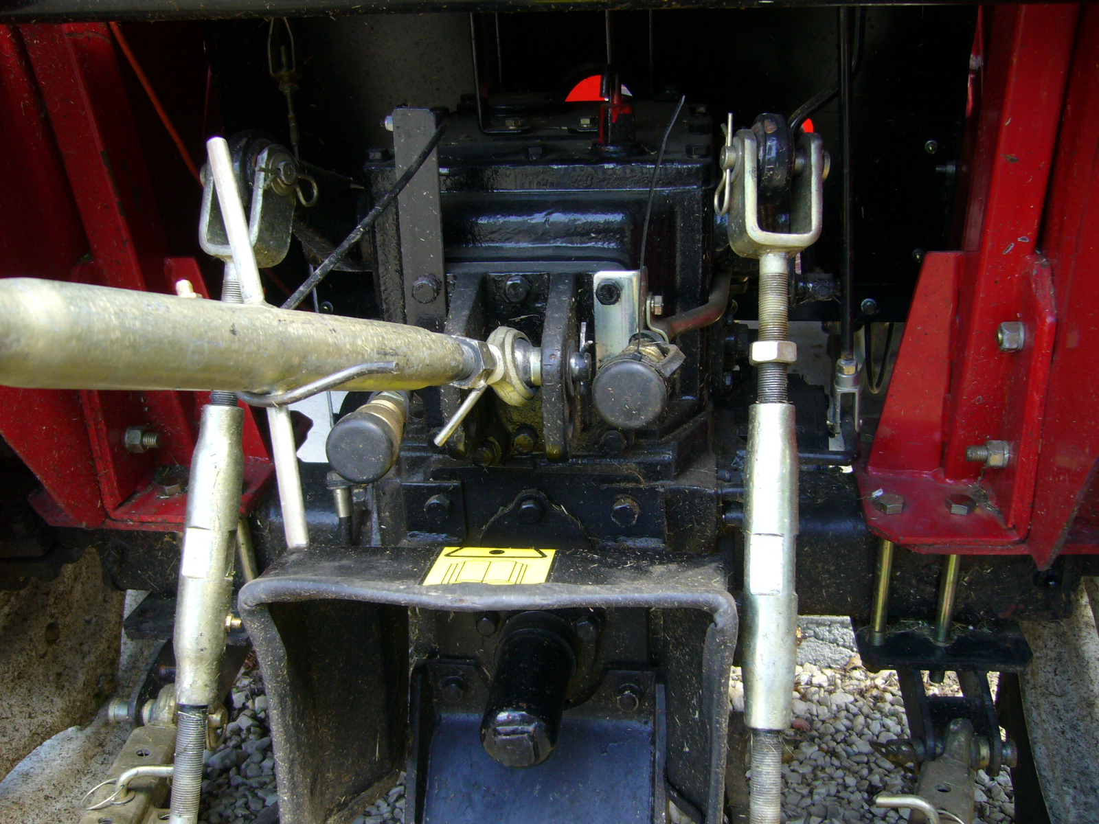

Hi, I now have 68hrs on my Jinma 244E mostly used mowing, general tree dragging, a bit of grading and general transport around the land and feel as though I ought to start using the hydraulic connections at the rear of the tractor... but what can I use with them. I'm afraid I was not told what I can connect to them and which is the out and which is the return. I know I feel a bit of a plonker but if I don't ask I wont get to find out. I would like to get in the future a wood splitter and a tipping trailer. I have included 3 photos which I hope will help you identify what exactly I have got fitted. I have the one lever showing Raise and Lower. I am aware of a knob below my seat that controls the speed of raising and lowering the 3 point linkage. Hope that's enough to give me some advice? Cheers, Phil

Not much at all.
As you look at your first picture the one on the left is the return and simply dumps into the reservoir. The one on the right is the pressure side. You must first completely disable the 3 point lift by turning the knob clockwise between your legs as you sit on the operators seat. This reroutes the fluid from the 3 point lift cylinder to the remote on the back on your right side, the pressure remote. You now will not be able to use the 3 point and to control the fluid flow to the remotes you use the lift lever just as you would to control the 3 point.

About all you can do is use things with single acting cylinders. Just like your 3 point its gravity down and pressure up. So things like a dump trailer or a hydro lift on a pull behind plow.
If you want real remotes to run things like log splitters and such check our Ronald at Ranch Hand Supply. He has a aftermarket kit that is a direct bolt on to give you true rear remotes.
By the way dead heading is when you apply hydro fluid to a line with no where to go like a cylinder and then the back pressure blows the pumps gaskets or worse yet the pumps metal body. It has happened alot. What he is suggesting is run a hose from the pressure side of the factory remotes to the return side of the remotes. That way if you do something wrong it will simply cycle the fluid back to the reservoir. Of course this is not a possibility if you do not adjust the knob below the seat and between your legs.
