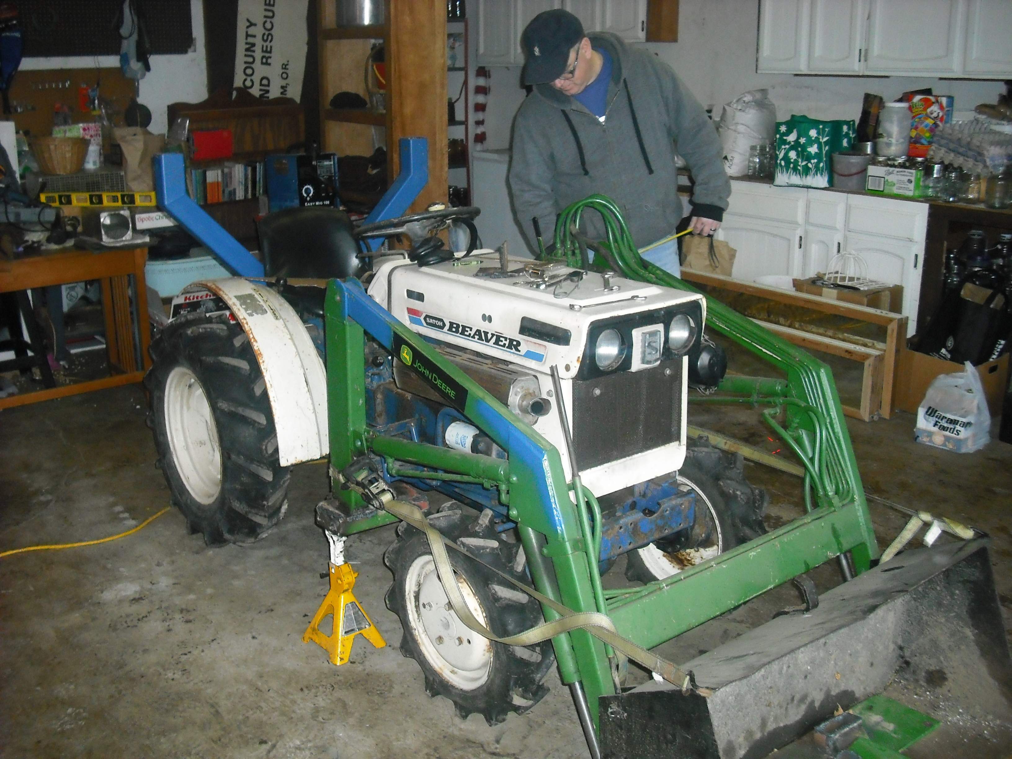

I have a Satoh S370D 4x4 two cyl diesel tractor. I'm fabing a motgomery wards bucket to it when I have time. I have a 4' howerd J tiller, 5' king kutter back blade, 4' FMC brush hog, and a 5' king kutter finish mower.
Anybody have an extra copy of a service manual? When were these made? How do they hold up? Parts contacts? Satoh wrecking yards? What fluids do I use and where do I put them? What the heck does that little valve on the right side under the seat do to the 3 point up and down?

Here is a picture of the tractor with the loader being fitted for service.

Eng oil- 15-40 diesel oil...Rotella or Delo work good
Hydraulics- UDT will work just fine
The lever on the R/H side is the 3pt lever.
