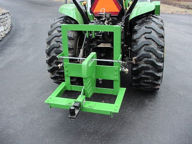

One of two of you mentioned that you use the KK carryall with iMatch, after some mods. Can you describe what you had to do or post pics?

I have an older King Kutter Carry All that I converted to a weight bracket. I did not have to make any mods for it to work with the iMatch. I only had to add bushings. I believe that King Kutter has redesigned there Carry Alls since I got mine. I do not know if the current design will work with the iMatch. I am attahing a picture.

That was not a very good picture. I had to make it that size to get it to post. I found this one.

I converted the top link connection on my carry-all to accept the iMatch, and is shown in this pic. It involved welding two vertical steel plates that hold the top link pin with CatII bushing that receives the iMatch top hook.
