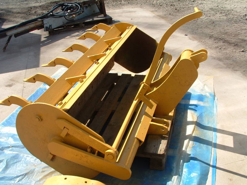

I second Soundguy, because I just bought a used Gannon Roll Over Box Blade. Does it look like this??
Handle allows you to change from scarifiers, blade towards front, or blade towards rear. You will like it very much, way quicker than setting the depth of each tooth on regular box blade. I have used mine about 5 times within the last couple of weeks and it is very easy to use and gets the job done pretty quick due the little time to switch around and the weight of the unit.

Grut - I looks exactly like that picture except it is missing most of the paint. It is very heavy and I don't really know how to operate it. Not sure how you are supposed to switch from blades to scarfs. Just got it last weekend and haven't had a chance to play with it very much. So, it sounds like I got something I can use. Paid $500 for it with the tractor.

You did real good Randy. That unit can do a lot. I use my regular BB a lot.

Lift it maybe 10" offf the ground and pull the handle and the box will flip until it meets the ground, contintue the lift and the scarfs will point down and the handle will usually lock on its own, do not be hanging on to the handle. If you wish to use the push blade lift the srarfs just enough to relieve some pressure and pull the handle and back up slowly and again the handle should lock, as you are backing lower the lift. Simple, you will have no trouble with this. You will love this implement.

JDRandyC listen to ninefinger and Bear Foot Farm. If you pull the lever while it is in the air it will rotate so the scarifiers go down due to the weight of them and lock into place. You have to pull the lever with the scarifiers slightly off the ground to unlatch it then go forward or backword with it touching the ground a little and it will roll over to forward blade or rear blade.
Have fun you got a good deal on that they are about 2k new now for a 72" or 84" from woods. Mines a 66" which is perfect for my tractor width of 62". They are very heavy duty and you really can't hurt them, they just need some paint once in while.
