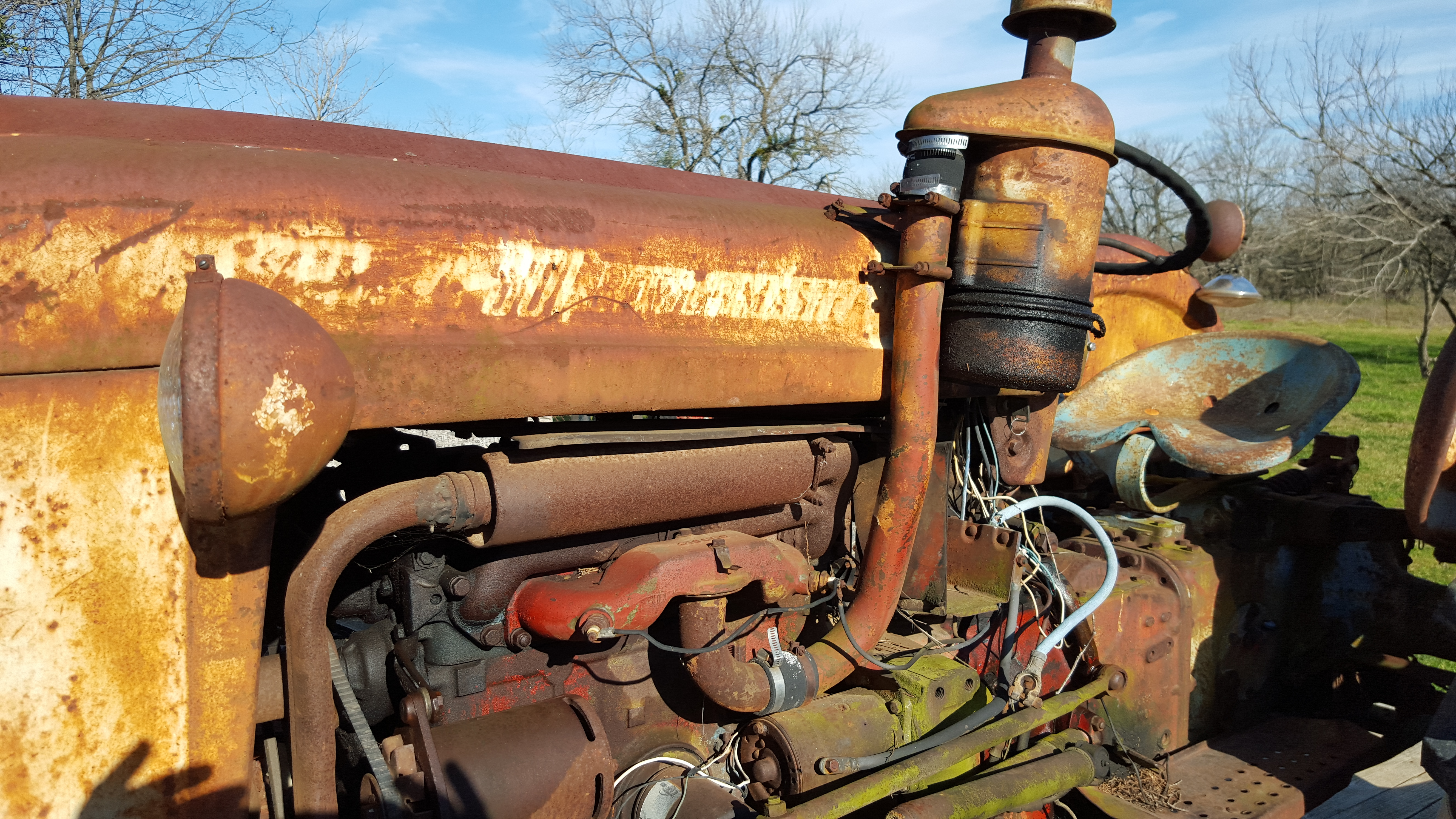

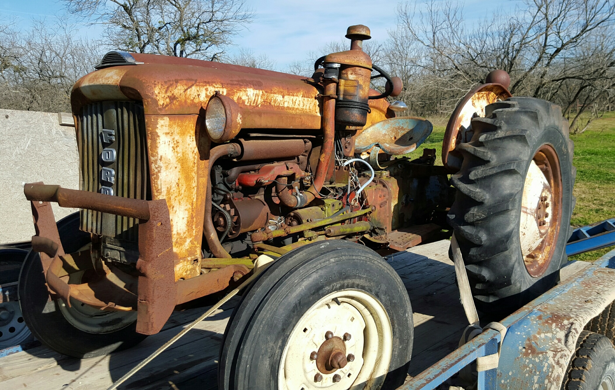

20160124_095410.jpgI got this and another tractor the other day and would like to get an idea of what it is.
At first I thought it was an early 4000 4 cylinder diesel but on closer inspection the hood says 801 workmaster? Hmm...

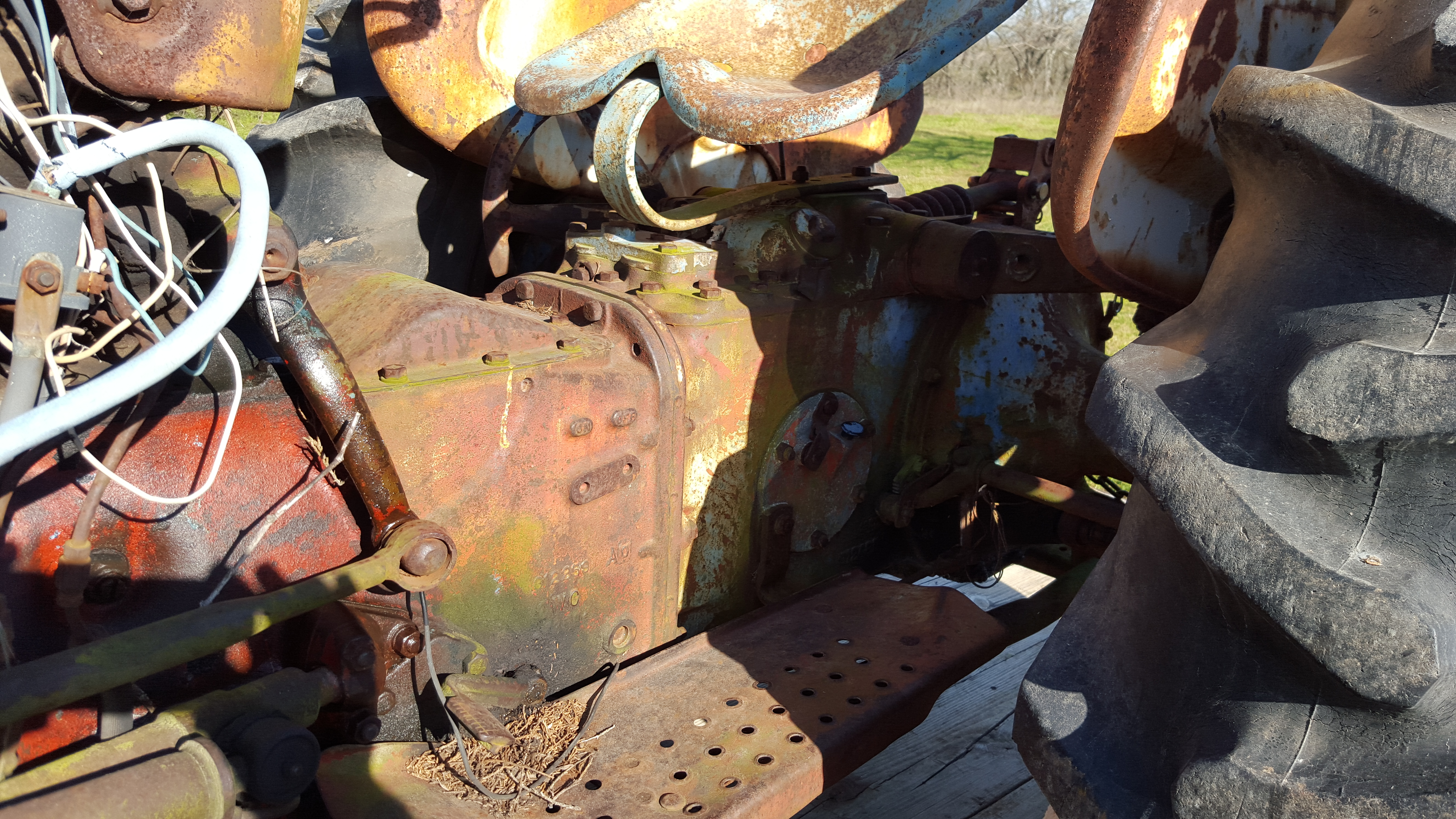

As you can see, the hood has the 1000 series crome piece and but says 801. And due to the condition reading the stamped numbers are barely legible and appear incomplete.20160124_095916-1_resized.jpg
Could it be a hybid. An early early 4000. Maybe somebody put the wrong decal on?

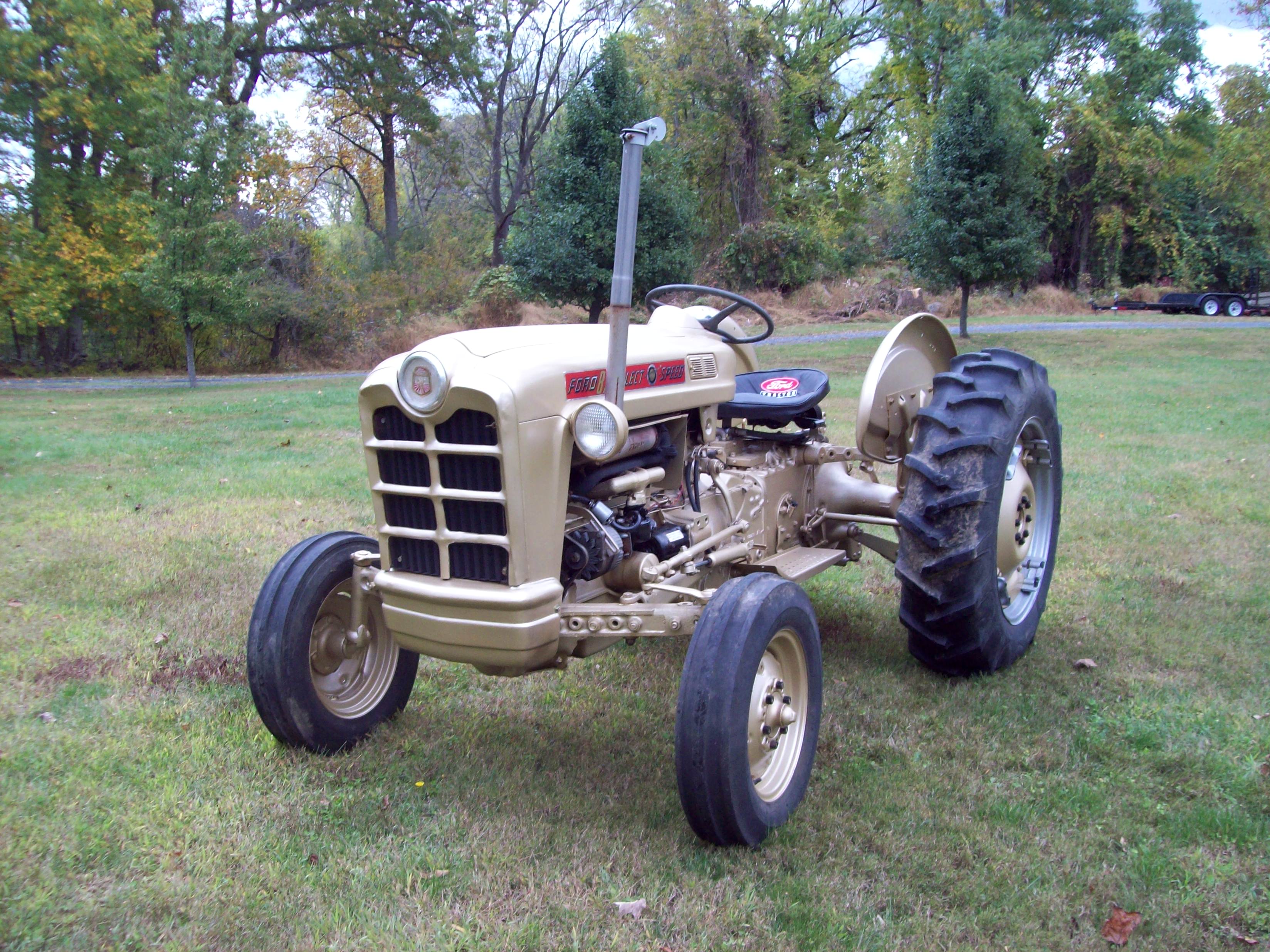

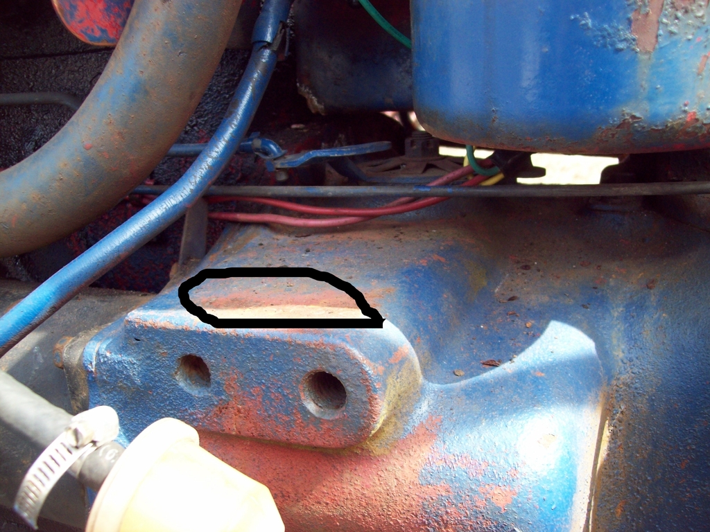

Judging from the SOS you have an 871. Here is a photo of my early 871 gold demo. location of your model and serial numbers are on the flat spot behind the start above the two holes in the bellhousing. Recall tracking #'s are in the same spot but on the opposite side of the tractor. I hope you disengage the traction lever before you moved it.

Post any numbers you CAN read fromt he bellhousing. As kirk said could be an 871.
Also.. look at the tranny number.. is it the old orc or new ddc SOS .
Also.. what is the block id casting number?
