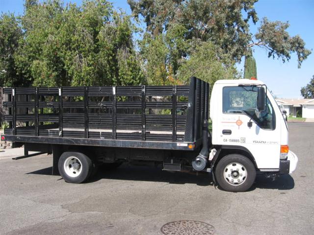

A recently bought a 2004 Isuzu NPR EFI (6.0L GMC V8 gas engine, 12,000 GVWR) stakebed (8 x 14 ft bed) with 49,500 miles for $11K off eBay. Fortunately, the truck was located close by so there was no problem arranging for the test drive.
The NPR is identical to the GMC W3500.
I weighed it at the Petro truck stop--7140 lb with 3/4 tank of gas, me in the drivers seat and no load in the bed. So I have about 4800 lb of payload capacity-more than enough to haul my parade tractors around (heaviest is about 4000 lb). I'll get a set of heavy duty aluminum ramps (16" wide x 10 ft long).
Interior of the cab is essentially perfect--shows very little wear--no tears or stains on the seats.
The engine is clean as a whistle. Front tires need to be replaced (70% of the braking is done by the front discs so the fronts wear out first). Not a big expense since these are 10-ply rated LT215/85R16.
It has a vacuum assist on the brakes--the vacuum pump runs off the serpentine belt and is making bearing noise so I'll have to replace the pump and also the belt.
There was a rock crack (with spidering) in the windshield right in the driver's field of view (wouldn't pass CA inspection). Seller had the windshield and the gasket replaced ($200 and the job was done by the windshield guy in the Seller's driveway).
In CA the seller is responsible for getting the vehicle smogged--it passed easily ($99 please).
Fortunately, the manufacturer's window sticker was in the glove compartment so I know exactly what equipment is on my NPR.
I just returned from my steel supplier--needed some angle and bar stock to stiffen the corners of the stakebed. Bought some weldable D-rings since there are no tiedowns installed on the stakebed yet.
The deck is built by Supreme (one of the big guys in truck upfitting ). It's tongue and groove 2x6 dense pine and it shows a good bit of wear (the truck was initially owned by a tile company). The black paint on the top and bottom sides of the deck is high solids acrylic enamel and has to be redone.
I calculated the bending loads on the frame of the stakebed and it should carry my 4000lb parade tractor with no problem.
I realize that my NPR is a lightweight version of a medium duty truck compared to the 7000 you're eyeballing, but I think you can get some idea of what to look for from my story.
