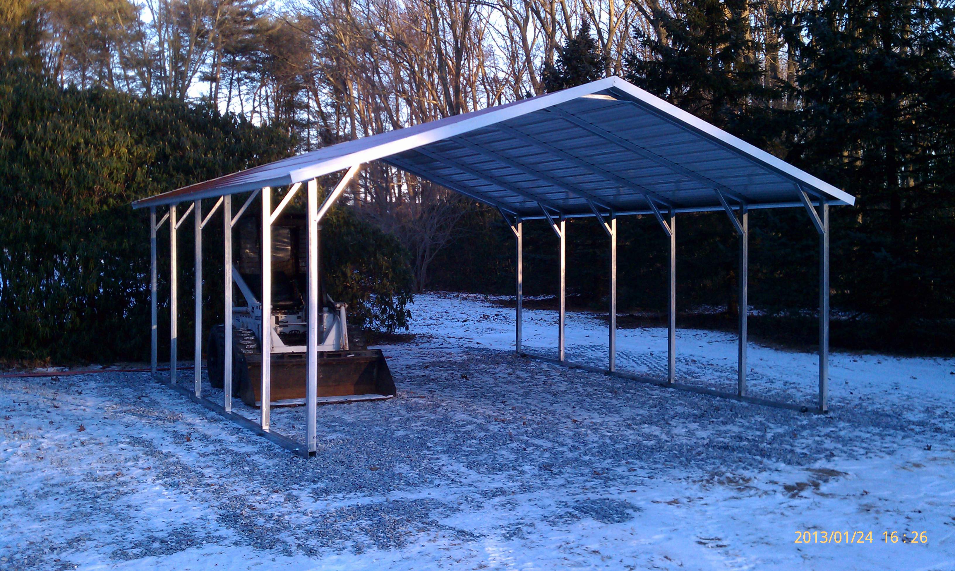

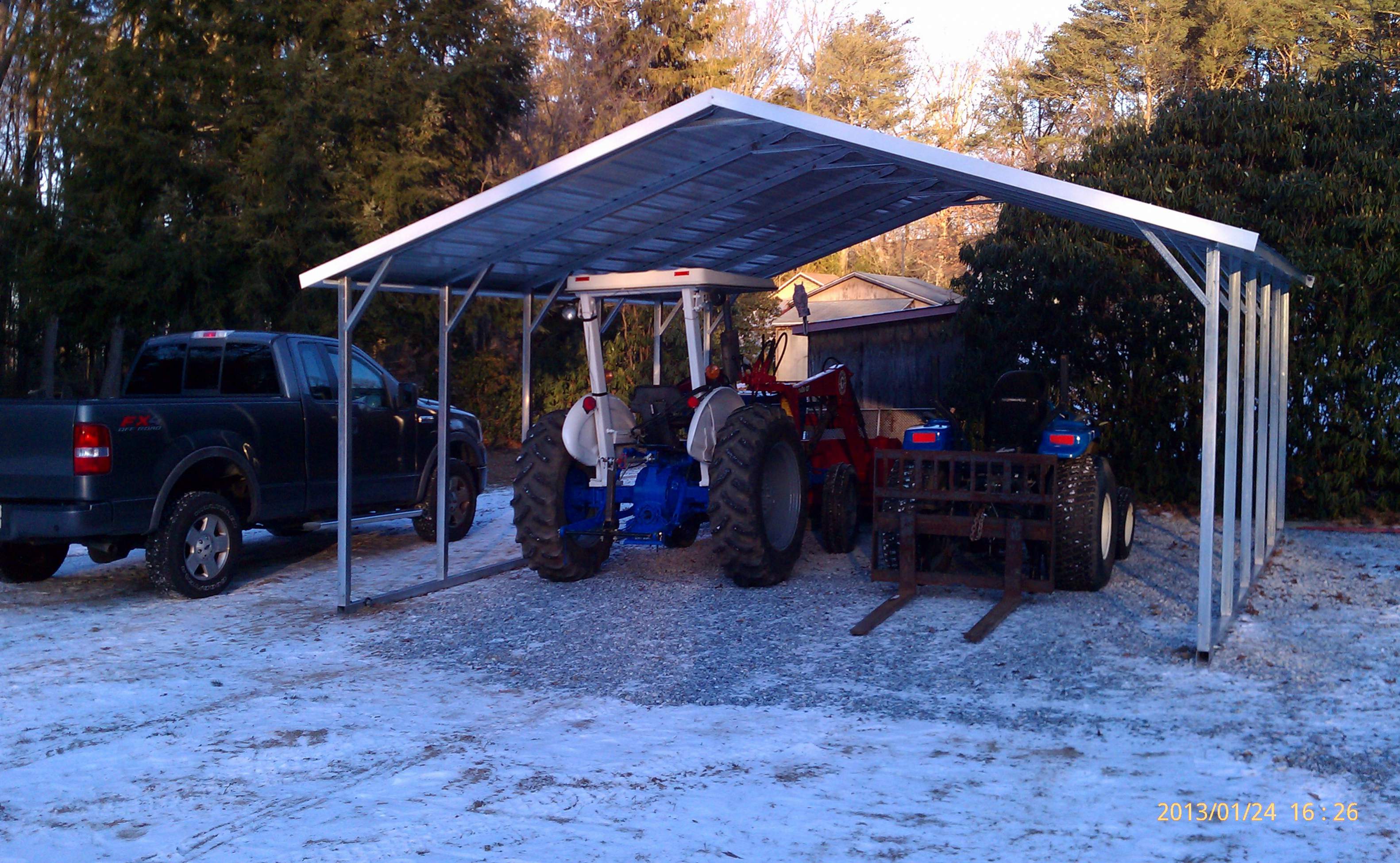

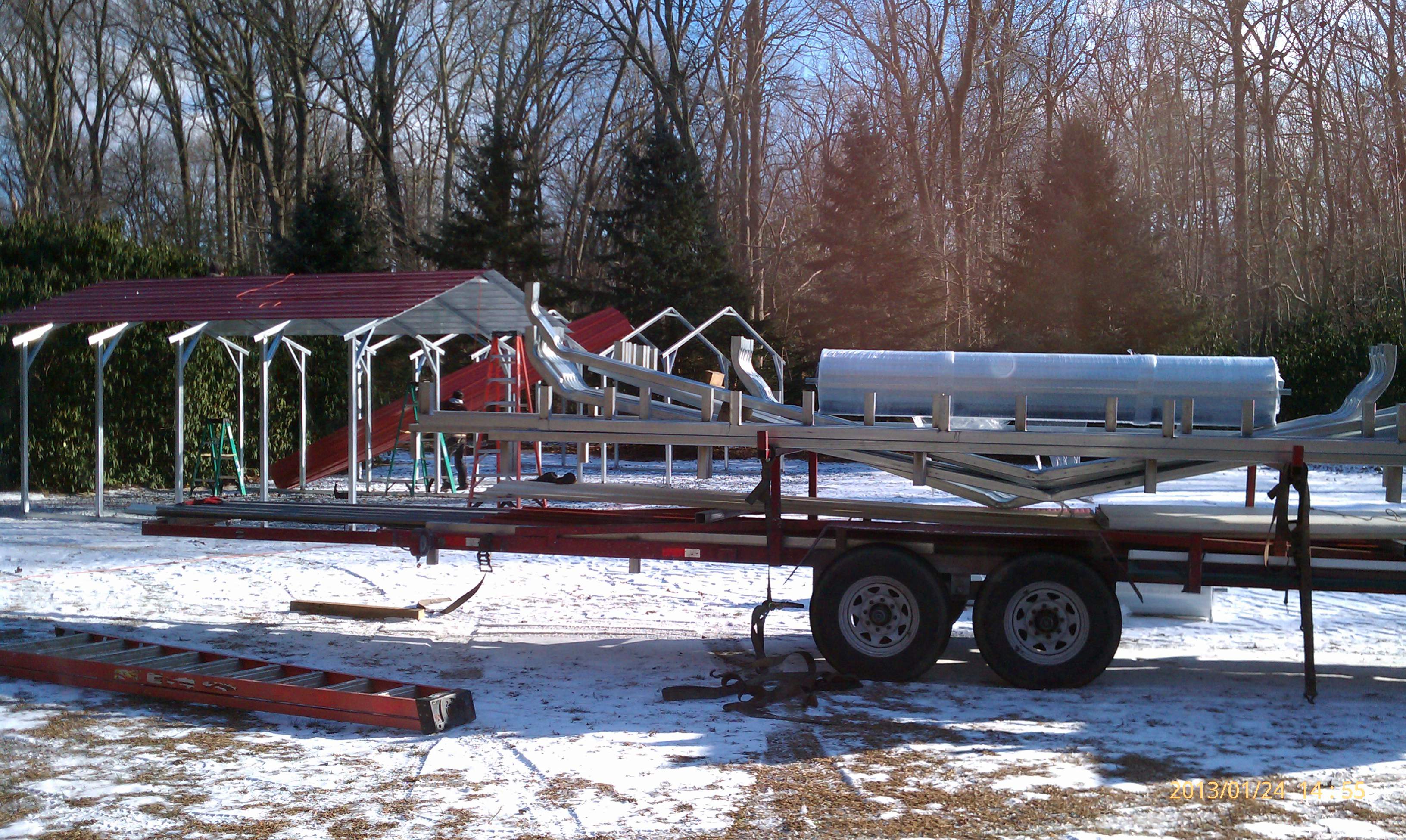

BHD, I put up two carports to park equipment under.
I also installed the screw anchors which I would advise anyone to do no matter where you are.
It doesn't take much to lift these up and they are so light.
I thought about closing in the sides but was worried about the wind loading and if the structure would hold up in high winds.
Mine have up through two winters now. As far as the directions of the roof panels and drainage, I agree they will hold more snow when horizontal which is how mine are. We have not had any huge snows here since I got them, I think 12 inches was the most in the past 2 winters. I don't knowmhow they will do with 20 or 30 inches but some day we'll see. It only costs a little more to have the roof run vertically,so might be worth it out your way where you probably see more snow than I do.
Would I buy again? Yes, for I want it for I could not have put up any other type of structure for the same money. 18'x21' for $895 (base price) installed. I got mine 2 feet higher than standard so I could get both tractors under there side by side. Anchors were $25 @ but well worth it. Upgrade to 12 GA steel also.

On ytmag a poster had one that ripped out the anchors and blew away in a windstorm. Can't recall if the vehicles inside were damaged. They don't work up here as we get too much snow, they just collapse.
   / What do you think of this kind of building? #28
Yes, you are right, not a good choice if you live in tornado alley or hurricane territory. Even during windy t-storms I see evidence of uplift on mine.
I've thought of what I might do if a hurricane were approaching. Don't know if I would try to tie the carport down with the equipment inside and if it would then just take it all away. Or if I should just let it go and leave the equipment standing there on its own. Not so worried about the equipment, I'm more worried about the carport flying across the street and injuring someone or damaging someone else's property. Of course where they're located they would have to travel about 100 yards, but that is nothing with 50 mph or higher winds.
