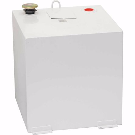

I want something that's safe to store in the garage, not vented, 50-75 gallons, that way I can fill it twice a year. Getting tired of hauling 8 5gal gas cans back and forth every other month, lifting them, them breaking after 1-2 years of regular use. The ones I've seen are in the neighborhood of $2k, so I'm hoping there is a more reasonable alternative.

A 55 gal drum? At the dealership I worked at there was a local oil company that would come around and refill them with off road diesel which saves you the road use tax.

Been using a metal 55 gal drum for decades. It sits in a drum dolly in the garage. A couple nylon straps and the FEL make handling it quick and easy and a hand pump makes filling the tractor a real plus over using cans.

I picked up a 100 gal tank and pump off of Craigslist a few years back. It is vented, but there is no appreciable diesel smell in the garage unless someone spills it.

I scored two nearly new 50 gal
tanks for $50@ off CL a few years ago. They do fairly well.
Recently I also bought a NT Flo n' Go Duramax Gas Caddy 14-Gallon, $80, thread http://www.tractorbynet.com/forums/owning-operating/378261-nt-flo-n-go-duramax.html for $80 for something I can handle when I don't want to move 50 gallons.
And for my 5 gallon cans I use Justrite Galvanized Steel, with the metal nozzle that I got on a bodacious sale price.

I usually use 20 liter [+- 5 gal] cans for my tractor fuel since they're easy to lift and pour.
I also have an oil drum in the garage, mounted high enough so I can siphon into the tractor; have to be careful doing that not to overfill and get fuel everywhere.
If you want to go upmarket, get a little pump with a filling nozzle that had auto shutoff, or get an old one from a gas station.
mostly those pumps are not self priming, so have to be fed from the bottom of the tank, and even tiny leakage would be a problem.
