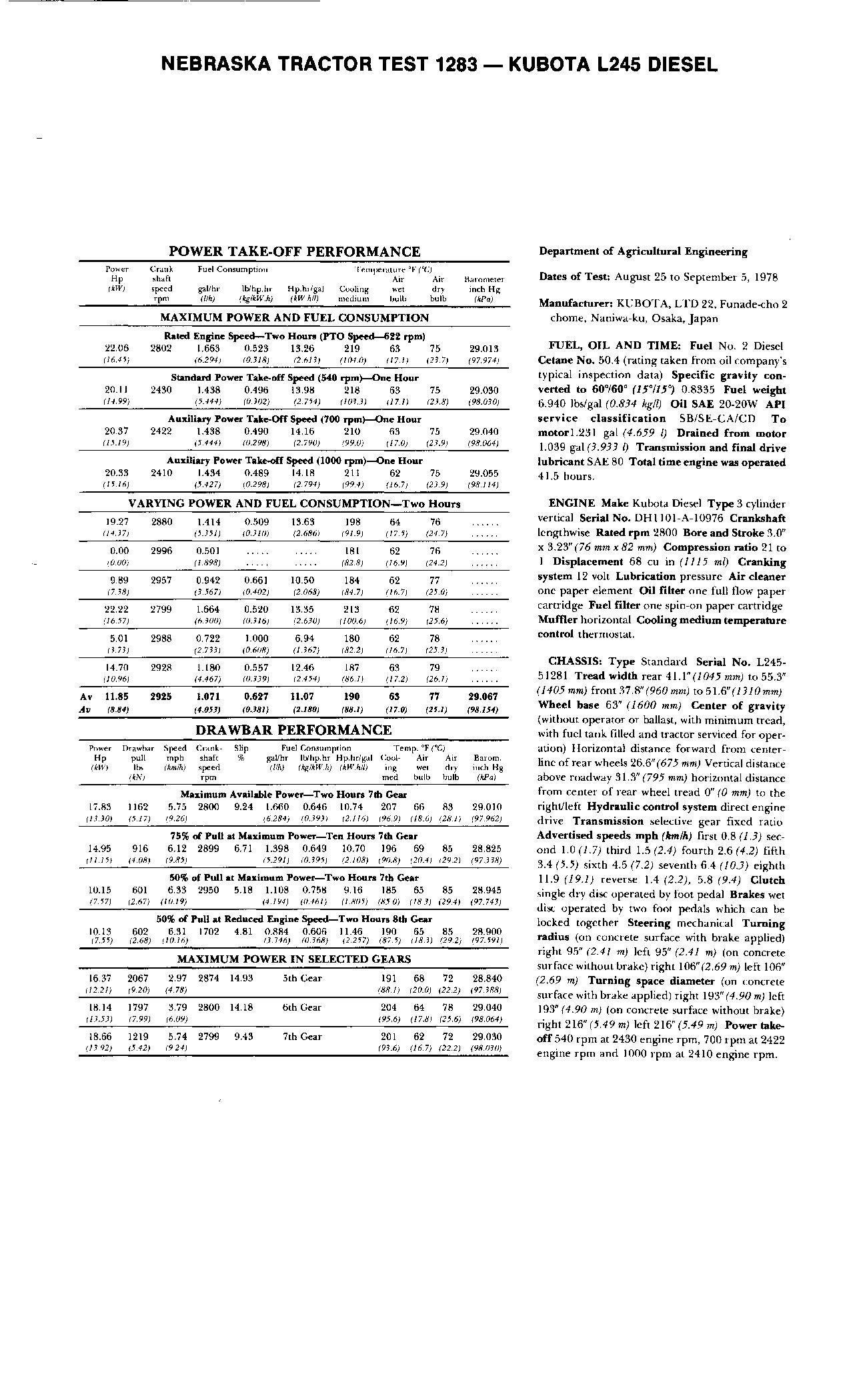

The rated engine speed is the maximum engine RPM for more or less continuous use. It is not always the same as PTO speed, but is frequently close. Here is a page from the Nebraska Tractor Test for a Kubota L245. The rated engine speed is 2800 RPM, yielding a PTO speed in low gear of 622 PTO RPM. To achieve 540 RPM, the engine is operated at 2430 RPM. The other two PTO gears require approximately the same engine RPM, just over 2400 RPM.
I think the idea behind listing the speeds at rated engine speed is to assist in matching implements or doing calculations for, say, mowing or seeding per acre. The machine allows for some minor adjustment of ground speed by the throttle, but should generally have the throttle set in the operating range, from say a bit below PTO rated speed to rated speed. Outside of that variability, a different gear should be selected to keep the engine at the appropriate point in its power band. There are obviously exceptions, but I think that is the general idea.

I think you are right in saying this; it's kind of a choice of definitions. The governor is designed to limit the engine RPM to whatever the manufacturer says. That is the "high idle" RPM, as MHarryE said. The machine should be working at "rated RPM," which is the engine speed where it can operate indefinitely until service intervals are reached.
The ground speed would be listed according to PTO RPM, rated RPM, or whatever else the manufacturer thinks. To find the difference, you could divide PTO RPM by rated RPM, then multiply by the travel speed to get the tractor's velocity at PTO RPM. I think they probably use rated RPM since everything else in their data set likely has that, and most people are lazy. :D
