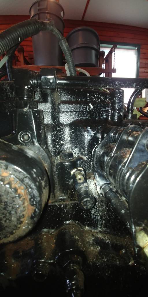

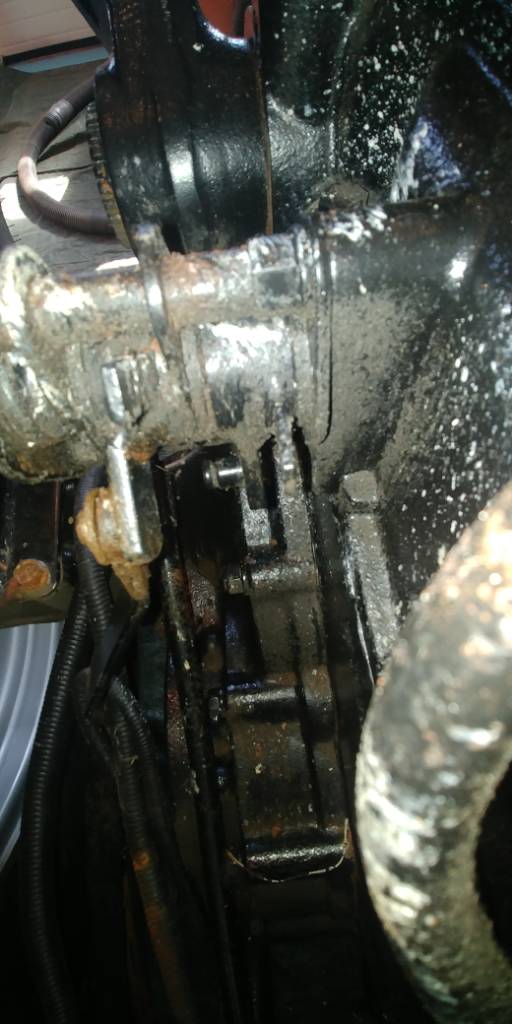

Mahindra 5010 cab hst
Have cab off a ready to paint - wondering what these two linkage controls are for?
Its on a 2014 Mahindra 5010.
First one is located above the rear axel on the right side between the 3pt lift arm and the 3pt raise / lower linkage control assembly.
Second one is the inboard portion of the 3pt raise/lower linkage control assembly.
Nothing was attached to either one.... JPEG_20200409_151343_2108436870635758019.jpgJPEG_20200409_151607_3938777361294810554.jpg
   / What does do these do? #2
Looks like it's for the draft control. It's a feature that it's not sold in the US, or it may be available as an option.
Ok so #2 is prob draft control which apparently is not commonly used ....so what is #1?
   / What does do these do? #4
Did the rear lift work? If the rear lift did not work then would say the other linkage if for the rear lift for the "position" control. No idea on Mahrinda no idea but draft control is very common on farm tractors in the US. It is used for keeping tillage implements in proper ground engagement.
Rear lift was working ....just curious ...will check with the dealer to see .....must do something but with everything disassembled I can't check ...
