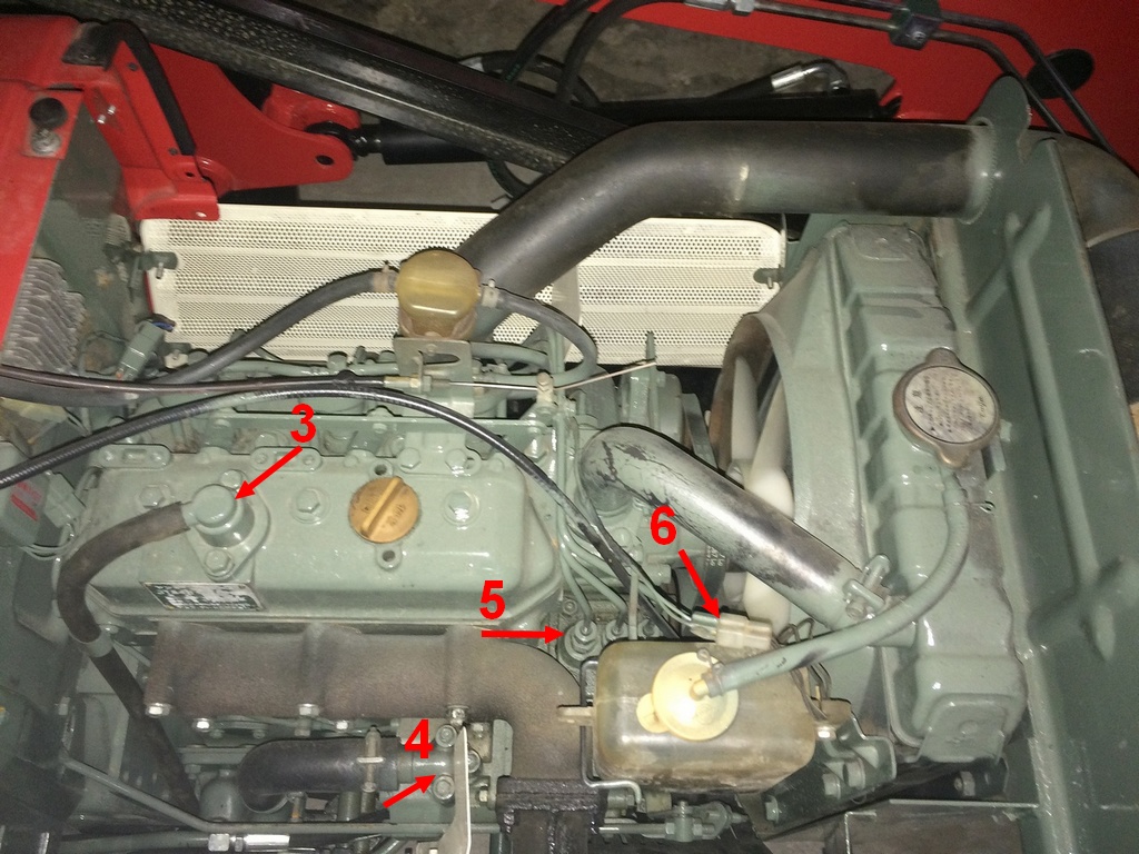

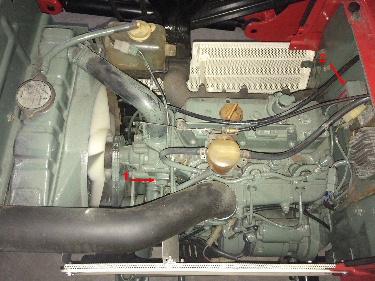

I have some questions, maybe some one can help me what exactly that is what I have marked in the picturs?

1.
2.
3.
4.
5. .. and what gasket do I need here?
6. At the bottom of the overflow tank, a cable goes away, what is this?

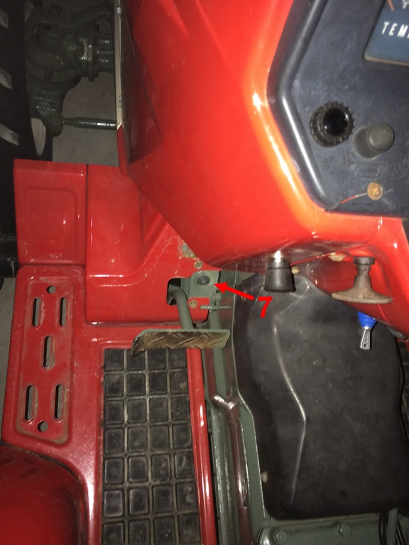

7. What is this button for? The cables are not connected to the Tra.

1. Temperature sending unit for gauge.
2. Thermostart control box.
3. Crankcase vent.
4. Hydraulic suction connection at pump. , P20 o-ring, 24311-000200 Hydrailic Line Oring: Yanmar Tractor Parts
5. Injection pump lines going to fuel injectors. No gasket
6. Not positive but I believe that is the wiring going to the overflow bottle which turns a warning light on if your coolant level gets low in the bottle. Not sure I understand "a cable goes away".
7. Clutch safety switch, if working properly the tractor will not crank unless the switch is pushed down by the clutch pedal.
Your thermostat is right underneath the top radiator hose where it fastens to the water pump.
Your oil pressure sending unit is on the front left of the front gear housing down low. It will look like this: OIL PRESSURE SENDING SWITCH_: Yanmar Tractor Parts
