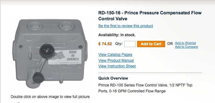

Using one of these will give the hyd motor full torque but give you infinite control over the speed of it. Save the stress on both motor and pump.
   / What happens when you choke a HYD motor?
Cool. This I think will answer my delima. I will report back in a few months once I get it built.
Thanks guys for all the info.
