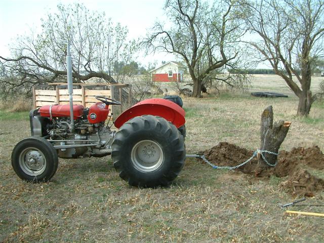

You can modify a tractor fairly easily to decrease the center of gravity and increase stability on hills. My 1964 MF135 diesel tractor was modified to work in the previous owner's olive orchard. The tall rear wheels on 28" diameter rims were replaced by 16" dia rims with BF Goodrich 18.4-16 rubber (18" wide, 40" tall overall). The front axle spindles were shortened to keep the tractor level.
My Mahindra dealer (Dave's Tractor in Red Bluff, CA) has modified a few of his CUTs in the 40hp range like this for his customers. Dave posts regularly on TBN. He can give you the details.
Dave's Tractor, Inc - Home
Good luck.

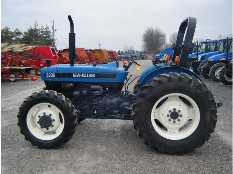

Our 3930 is a four wheel drive model, like the one below, right before the turbos came along.
2911702_1.jpgIt has just under 5000 hours, which really only works out to about an hour per day. Since you can't trust the parking brake to hold on the hills, the crews end up turning it off an on frequently when stopping to load/spray/etc (not a great solution, I realize).
