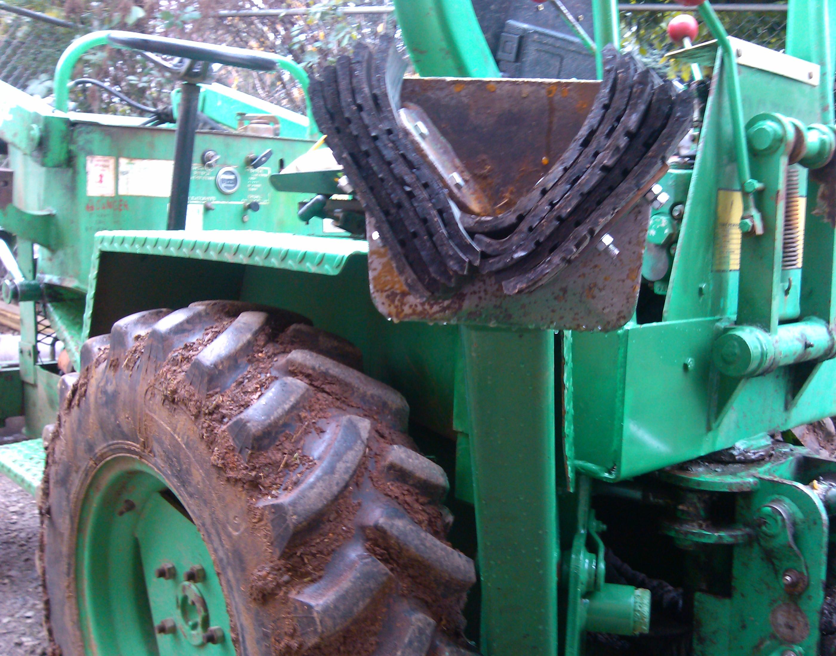

I took my wife's wore out car tire and cut the tread part up into 3" X 6" peaces. Then drilled two holes a inch down and an inch in on each end then drilled matching holes in the part of my outrigger that digs into the ground for traction on dirt. I bolted 5 layers of this tread (they are vertical the 3" way) so that I now have a much larger and multi purposed outrigger foot with little cost. Annd this not only works great in powder dirt, but also in mud, asphalt, concrete (all hard surfaces) especially if it is a nice surface that you don't want to scratch. It also keeps me over all a couple inches higher while digging. The results are even better than I had imagined. Cutting the tire up was a pain but oh so worth it.
Great idea! Any chance you can post a picture of one of them? Thanks
   / What have you done to improve your Terramite? #6
Thanks for the picture!
