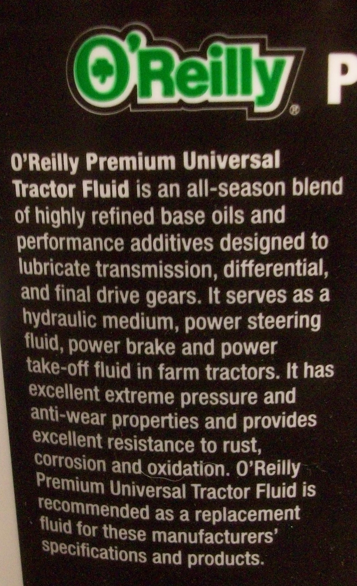

I have been using this O reillys Premium tractor (74209) 5 gallon fluid @$53. for my Ford and Rhino and it also lists the Kubota UDT mowing and Oreilys oil 015.JPG mowing and Oreilys oil 013.JPG not going to pass the SUDT requirements though
